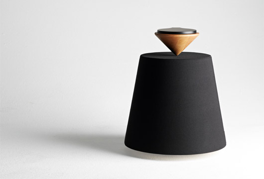

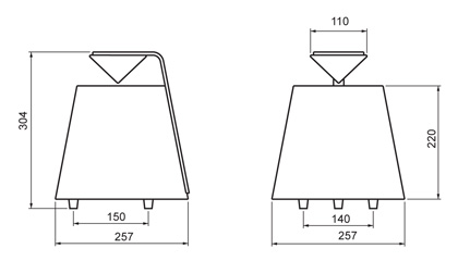

Due to size I have not read all this thread yet, but here is a link that looks an interesting concept !
- James Romeyn
great! :D looks like someone got inspired by this thread :cool:
With the LCS speakers engaged, what I heard was an incredible sound stage, as if the sidewalls and ceiling had been completely demolished.
From the above linked page:
"Later James experimented with Dr. Floyd Toole’s side-firing ambiance theories, which led to Late Ceiling Splash (LCS)."
Now, I know about side firing speakers yes I do, but I cannot recall Toole experiencing with those concepts ?
Also , it is not immediately apparent how potentially beneficial 'side firing' leads to ceiling reflection as a solution ? :rolleyes:
