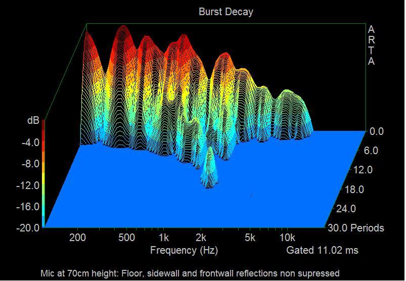

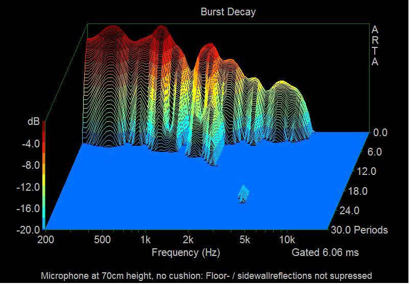

Hi graaf,
in my special case, this is the speaker's step response
http://www.dipol-audio.de/model2-messungen-dateien/model2_nearfield_step.JPG
The speaker is a floorstander with semi rigid bending wave membrane.
The graph is including floor reflection: There is virtually none.
Membrane is about 40x110 cm and nearly touches the floor.
There are multiple excitation points and bending waves on the
membrane propagate faster than sound in air from upper midrange
on upwards.
No issues concerning floor reflections and - to be honest - it was
one of the main goals in developing this speaker, to circumvent floor
reflection as far as possible.
Three measurements of an early "Model2" version from 2012
placed in the listening room mentioned.
Of course FR changed noteably up to now but gross behaviour
due to polar pattern or decay has not changed.
1) Setting:
Microphone on the bottom in front of speaker.
Mic lying on a large cushion additionally.
Floor reflection supressed acoustically this way.
Sidewall reflection damped by another cushion.
Frontwall reflection gated.
2) Setting:
Microphone on 70cm height over naked floor (wood tiles).
Floor reflection not supressed.
Sidewall reflection not supressed.
3) Setting:
Frontwall reflection not supressed.
Later Reflections gated.
____________________________
Please note when going from 1) to 2) the axis is shifting and FR changes.
The effect of floor and also sidewall reflections is rather unoffensive with
that speaker. Note: Floor and sidewalls of the room are untreated in proximity
to the speaker, just the frontwall and front corners have some diffusers.
  • 03_NonSupressedFloorReflection_PlusSidewallReflectionPlusFrontwallReflection.JPG
