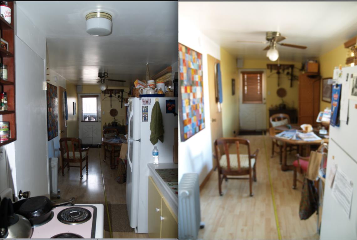

The set up was mono, listening to classical music and speech, standing and seated from 1-4 meters from the FCUFS.
If you have a better explanation than the Haas effect and pinna vertical location of the initial sound source of the FCUFS I'm "all ears".
Today I repeated the experiment, putting the FCUFS on the narrow end of the kitchen (my living room has shelving around the room which would interfere with a FCUFS) and listened to speech and music from 1 meter to 8.5 meters, standing and seated.
My tape measure is in inches, requiring extensive calculation for conversion;).
I tried listening with the blinds above the speaker open and closed, not much difference was audible.
At 1 and 2 meters, the source was obviously the FCUFS location, at 3 meters, more ambiguous but still a definite downward location.
At 4 meters and further, legato passages became hard to locate, while percussion and vocals still sounded as if they were located at the floor wall junction.
Sitting midway in the room where the kitchen table blocked a direct path to the FCUFS, the sound location was ambiguous, I would not be able to point to a single source.
At any rate, I don't find it at all puzzling that different ears and brains in different rooms hear and interpret what they hear differently.
If you came in to my room and had a totally different impression, it would be no more a surprise than finding our record collection, and taste in liquor differed.
You will notice there is no carpeting on my floor, though I'd prefer it acoustically, living here in Madrid New Mexico next to a pile of blowing coal dust and dirt it would soon be like a sandbox. Hard enough to clean the throw rugs, at least they can be taken outside and beaten into submission.
