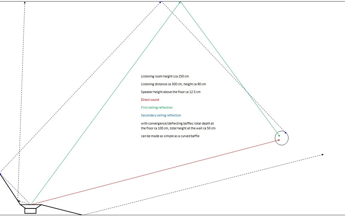

Are you suggesting two different types of enclosures? One Pluto-style front-firing using a bent pipe and one ceiling-firing?
a simple visualisation of a floor and front wall coupled UFS with a coaxial driver and with convergence/deflecting baffles:
