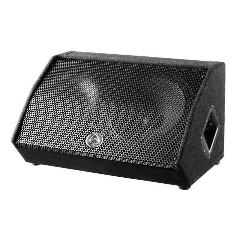

There is one branch of flooders completely ignored until now, PA stage monitors :D

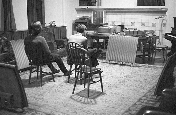

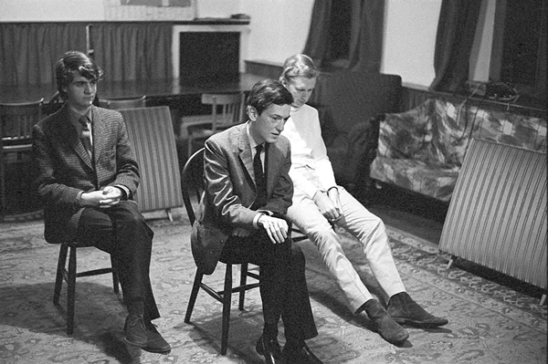

For example here's Michael Gerzon listening setup for matrixed 4 speaker stereo. Quad ESL are placed on the floor, and due to their backwards tilt the high freqs radiate directly to listening position. The incidence angle seems rather low. Still this setup was used in high quality research at the time.
Interesting question is since when tweeters got placed at the ear level in hifi systems ? :smash:
