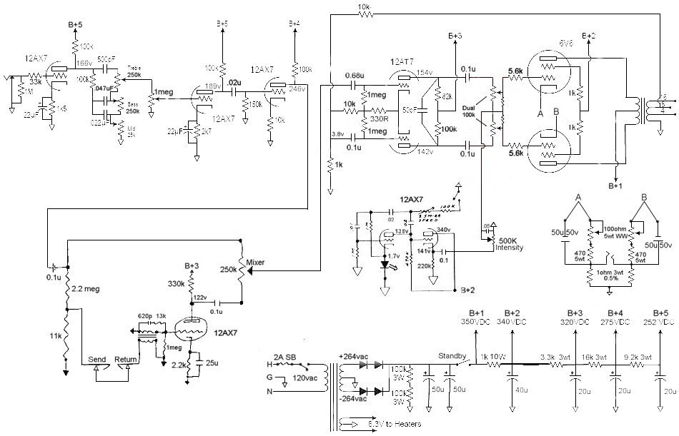

In my case the right (top) side of the pot is grounded. This because there is no grid bias since mine is cathode biased. I'm seeing some other (cathode biased) models that use the same basic trem approach that don't have that cap. In my case the trem does not push the tubes into cutoff, at least when idling. Almost but not quite. Of course they reach cutoff sooner with signal but not into crossover distortion.
My trem has not been as sine wave shaped as I would prefer but I was wondering about the value of the cap since some don't have it and some use 0.1u. I'm using 0.05u. I didn't know if these ranges would affect the impedance at typical guitar frequencies since the cap bypasses the trem pot which is in the grid leak circuit. Maybe I'll try a 0.1u and see what happens.
I tried 0.1u and the wave is smoother but the effect a little weaker. I did a lot of work to get this trem to be strong enough at all volume settings. I'm thinking of using a higher value pot. I think I have room there based on some circuits I’ve seen.
For example, my friend used his Ampeg Mercury at a gig the other day where I was running sound. His trem was fantastic sounding. I didn't have my scope yet when I working on his amp a few years ago, so I haven't seen it's wave. Looking at his scheme (attached) I see that his trem doesn't have "that cap" and it's coming off a plate. However, it comes off a triode that being modulated at it's cathode. Just like the "bottom" half of a LTPI. I guess this could make the wave smoother?
Any other ideas on getting a more sine like wave that's still strong?

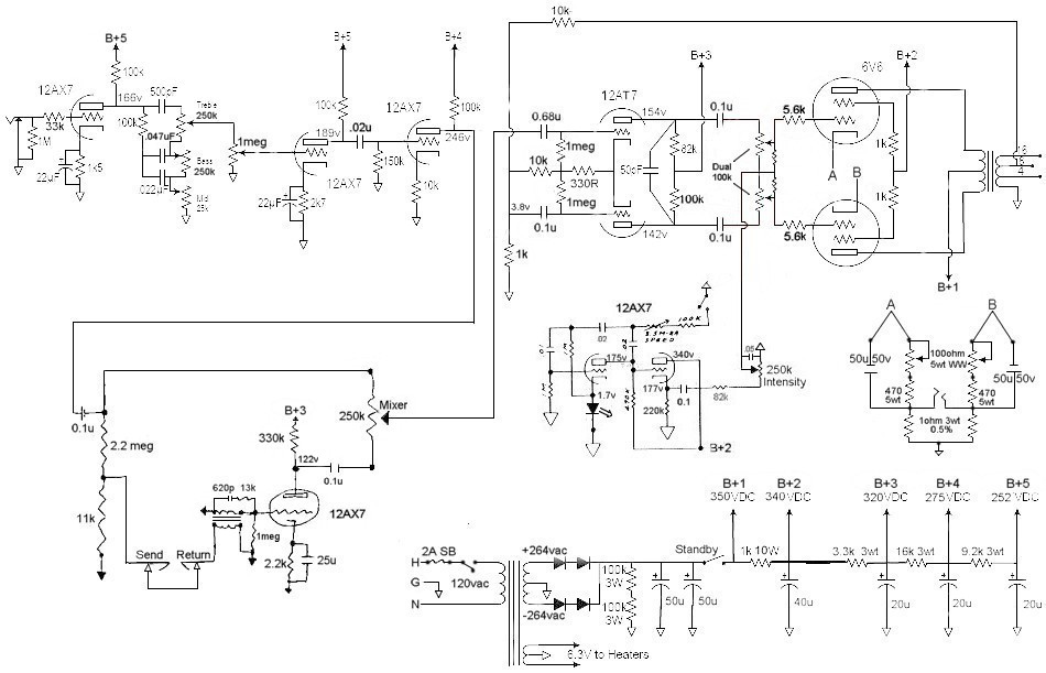

I decided to try a 12aT7 to see what would happen. The wave looked almost perfect but was significantly weaker. And it would not oscillate at lower speeds. And the led indicator in the cathode didn’t fully blink. So I went thru about 10 in my 12aX7 stash and happened to find two that happened to idle hotter on the oscillating side (and thus colder on the DC-coupled cathode follower.) These two tubes also happened to show more sinusoidal waves than the “normal” idling units. I had used cooler biasing before so I think it’s about the tube’s characteristic than the bias setting. Each put out only about 2-3volts less trem signal than the others. One was clipping on the bottom a little so I went with the other one. It’s a long black plated Sylvania. I increased the overall output strength by eliminating a resistor in line to the intensity control pot. It’s definitely better now.
Before starting the tube switching I wanted to see how the cathode follower side was idling and check the load line. I have the Valve Wizard’s excel file but how do you do enter a DC coupled cathode follower?
