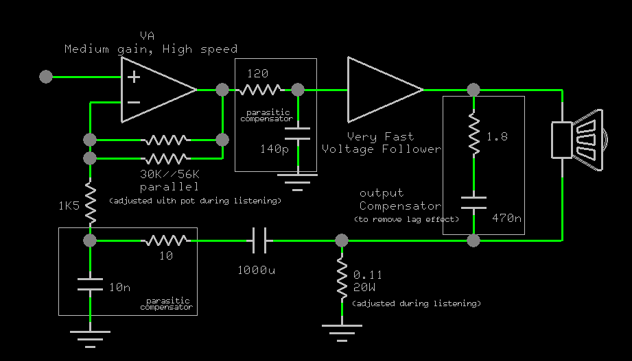

I must see the schematic diagrams to understand, what you mean.Hi tief,
I am using two independent stage(Voltage Follower for output stage) in single global FB (current sense). I cannot reach many advantage from single stage like commonly used.
Perhaps two voltage gain stages + power buffer against one voltage stage + power buffer - both with single NFB loop?

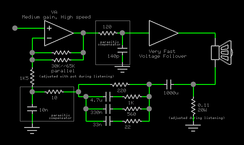

No, not inductive or capacitive mis behave. I am familiar with this disgusting sound. Probably it caused by amplifier that still have part of low output impedance at high output impedance operation. The effect is it disturb our ears natural compressing sense (wrong sensing than oscillating or something). We have automatic dynamic compressing system in our ears that adjust its sensitivity itself.
And yes, I create another amplifier with already low output impedance at its voltage follower and no interesting sound at it.
This schematic is my last adjustment, There still compensator added at the output that should be removed when this lag problem is solved.
Hi, tief this my last schemetic, now without output compensator.

Now I understand, what you mean. Very special is for me the serial resistor (in your case 120 ohms) by your compensator network "parasitic compensator".Hi tief,

However - this is a good basic topology for creating an evaluation amplifier, because the possibility to compare various topologies both for voltage gain stage, current gain stage (power follower) and various topologies for the NFB loop. Also that mode, where the power follower isn't in the NFB loop, is easy to realize.
ahem... I would say that's not quite true. There is indeed no global voltage NFB loop, but there IS an overall ("global") current NFB loop!Also that mode, where the power follower isn't in the NFB loop
