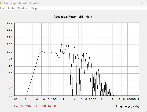

What do you do with this?
You cross it below the peaks so they don't really matter.

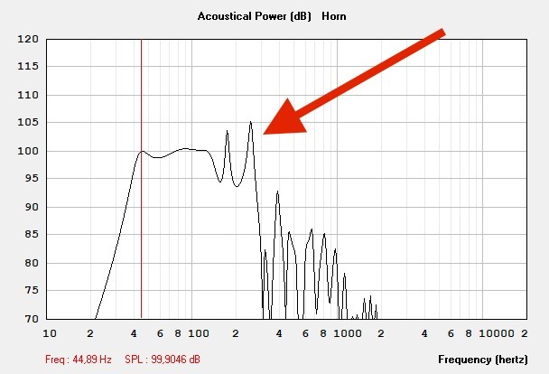

The peak at 175hz is probably a resonance between the front and back wall of the cab, the one at 255 i'm not sure about. There were some attempts at taming dips or peaks like that on the early pages of this thread, for example by using angled pieces in the corners.

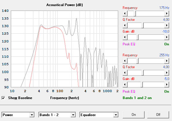

I disagree that the peaks don't really matter, they are still going to be audible even if you cross at 120hz. My MTH30s have a similar issue and i sucessfully used out-of-band EQ to attenuate the peaks, difference is very audible.
The Hornresp sim that shows the peaks isn't aware of the cabinet dimensions. Those resonances are due to the path length and its expansion.
Agreed, and using EQ to deal with out of band peaks is IMO the best approach.

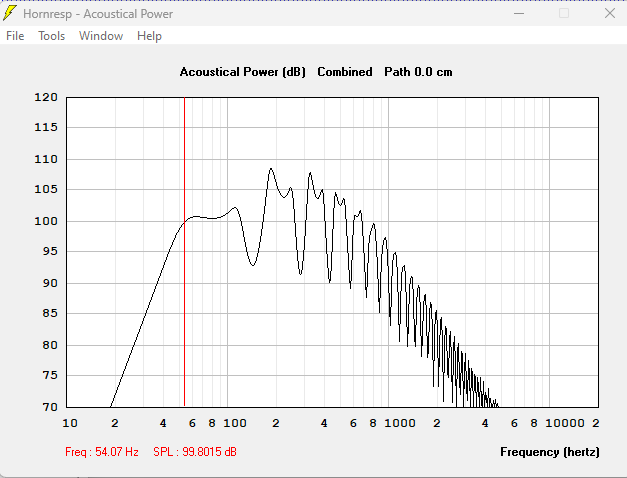

I've been playing around with Hornresp trying to model a few mid priced driver candidates (available in Australia) for a THAM15 including a Lorantz AC400X-B9. I wonder if I'm using the software correctly because even the OG B&C 15TBX100 driver looks a bit different to the response graphs on Anders' blog (seems to roll off too soon on mine)? Have I messed something up here?

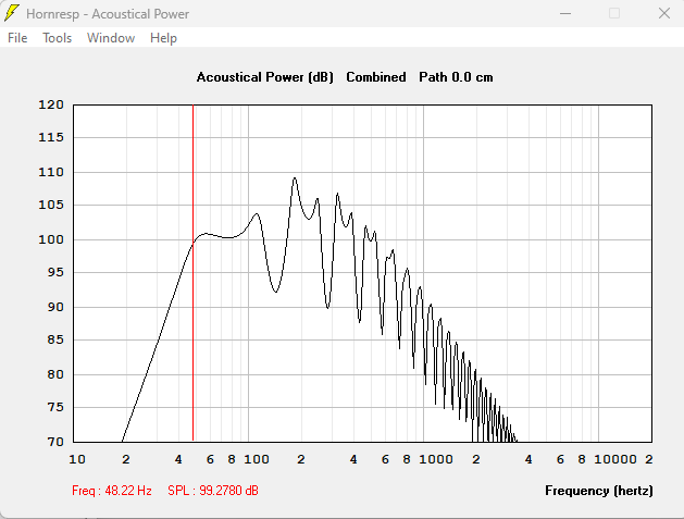

Then the loranz driver:

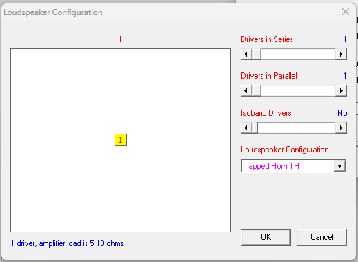

Thanks Brian! So at risk of asking the dumb questions, that's in the "loudspeaker configuration" settings is it?Yup, the sim type should be "TH", not "Th"
Awesome, thanks heaps! Rookie error. lol Looks much better now. The Lorantz doesn't seem to go as low as some of the preferred drivers (it starts to roll off about 3 hz higher than the 15TBX100), but it's not terrible would you say?
