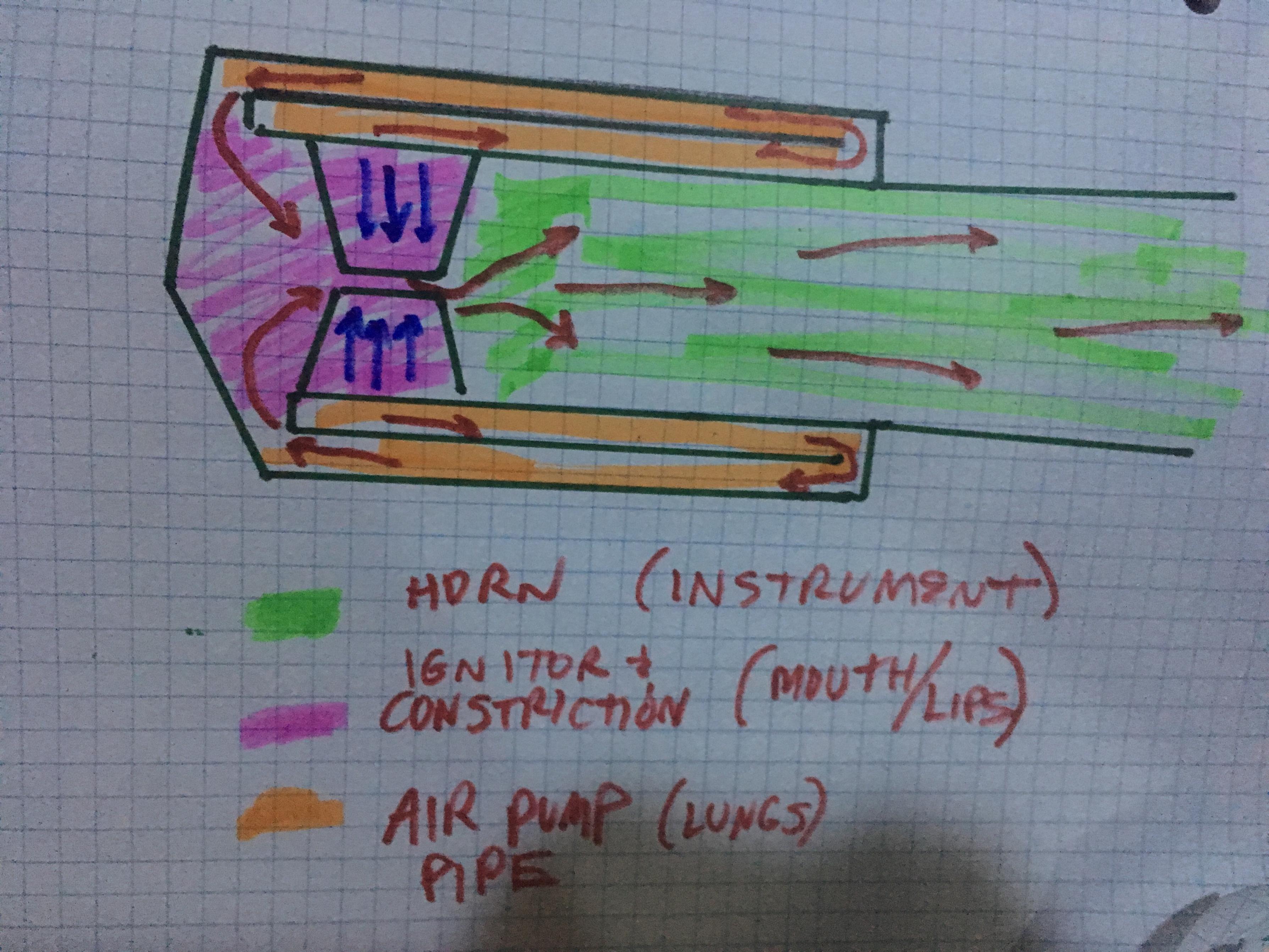

Ever consider a car audio friendly version of the BP4 concept? I don’t know if it’s a version of ROAR, but I have an idea? The dual opposes creates something by loading upstream on a way you gotta curve into the sim. fake the pinchpoint in the drawing . this can show something if repeated. Use the green as a huge leaky cabinet (car) but now you’re inside the green area too? Mass load it at and what happens? well then pretend that’s gonna happen is a car too....it trickles dune. But it’s standing waves of higher up stuck in folding. Not strategic folding maybe? Even with the wide open big mouth? if folded into ways that support bandwidth and also don’t getvout if they don’t. I have crazy issues with tambourines that no MLTL ever caused. I think I’m figuring out what and why? But I’m a newbie and leapfrogged into a pitfall(qw highr orders) I’m flying blind and the learning curve is steep but sloppy..

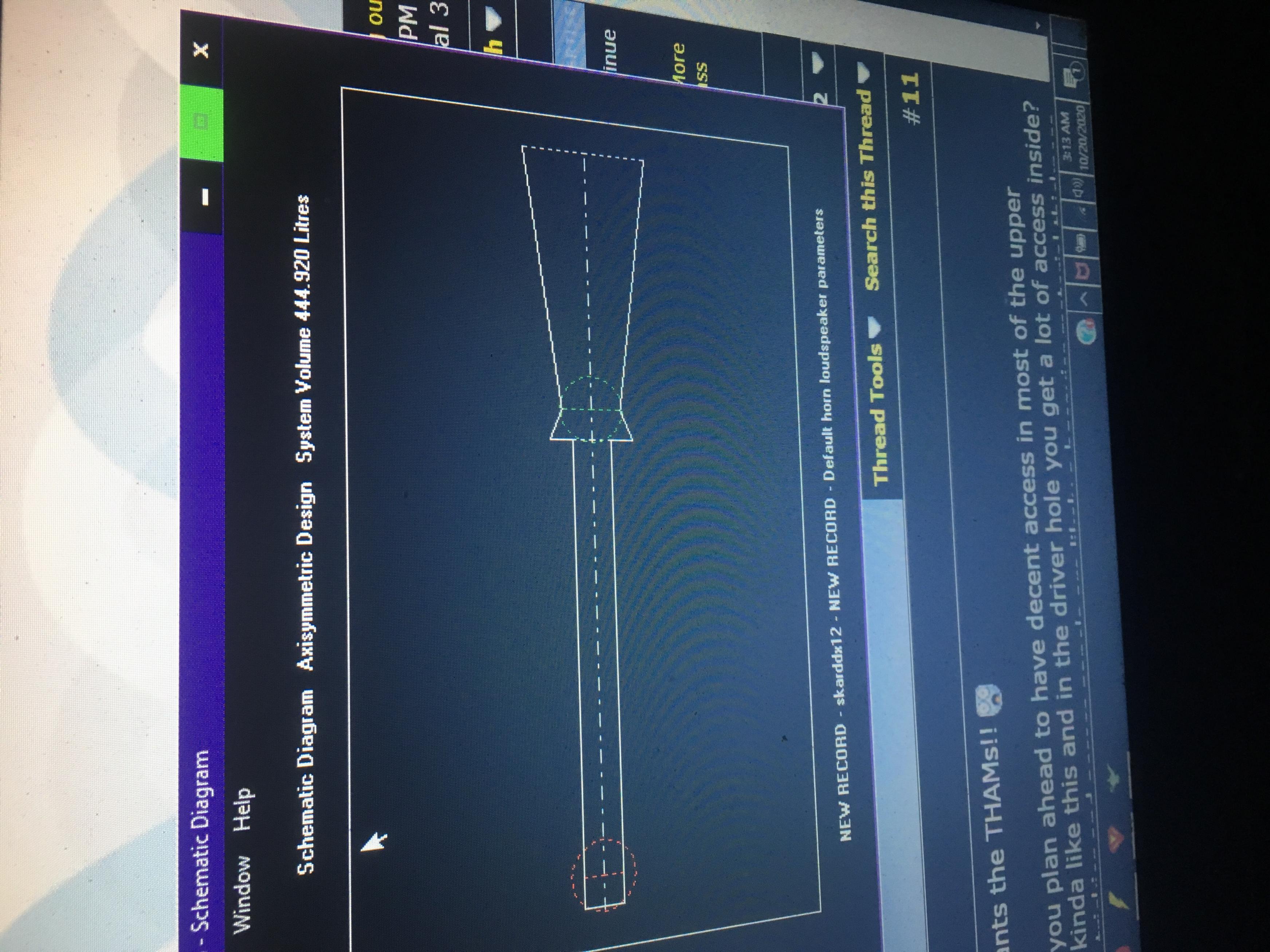

A ROAR15 is tuned to 42 - 43 Hz but will put of lots of 35 Hz content with ease. The THAM12 is tuned to 60 - 62 Hz but will output lots of energy down to 45 Hz.
Look at the cone excursion graph in Hornresp. It does tell a whole other tale then the spl response graph.
Or at least it should do that. Hornresp fails to account for the nonlinear mass inertia of the air column inside a QW at high power levels.
A correctly designed QW will use the nonlinear behaviour of the air column to its advantage, while a bass reflex will get all the disadvantages of port turbulence and compression.
A often quoted rule of thumb for port air velocity in a bass reflex port is to never exceed 10 m/s at full power. A straight and well built QW keeps functioning well into supersonic speeds.

In a dual opposed roar I enter the squeezed down CSA to mimic the real aftect slightly? Between the magnets the occupied volume as CSA missing in that areas length (fudging it) sorta...
