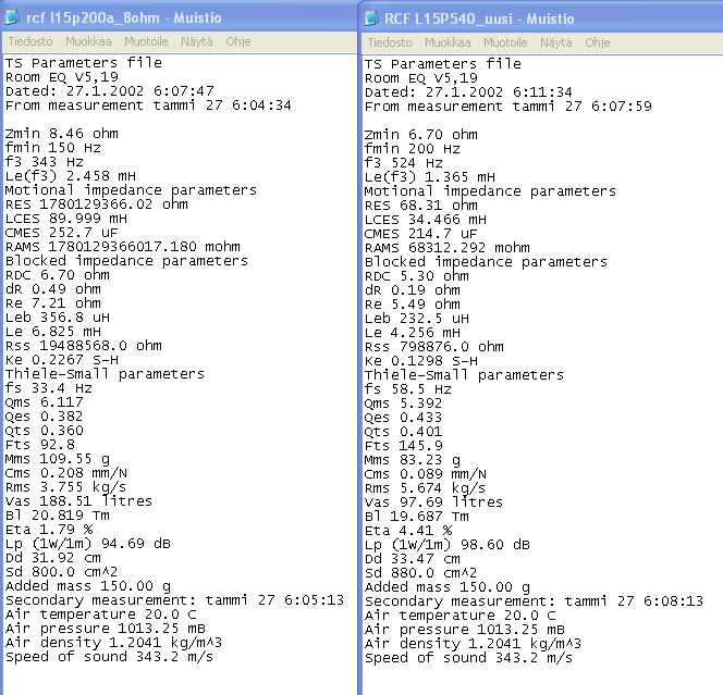

About my previous findings with old RCF L15P540, it might have some defects. Shorted turn or something? I tested another old version which measured just fine, almost spot on with manufacturer specs!

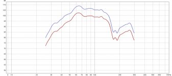

Just managed to finish building two of these for a small outdoor event.
As it was a bit of a last minuite built i deceided to go for a cheap driver, the thomann 15LB100-8W which i have seen a few people mentioning on here.

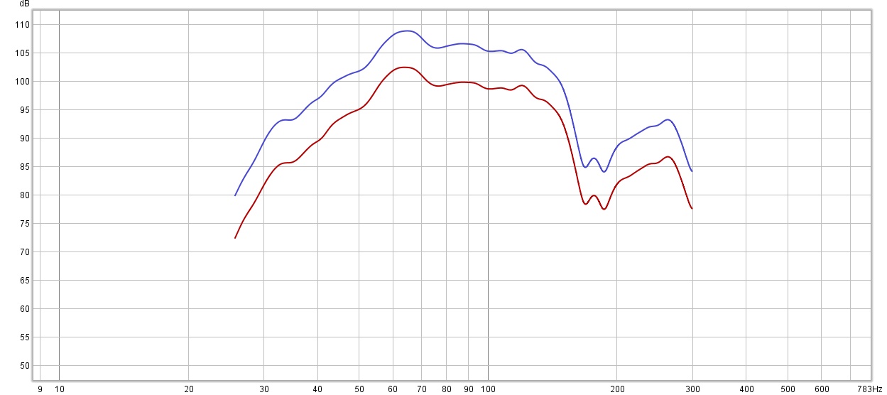

As no one has posted any graphs on the driver so I grabbed a few screen shots when we were setting everything up:
NOTE these graphs have a BW 150 24db/oct Low pass already applied.
Response: 48hz - 140hz +-3db
The Red is a single Tham15 and the blue is two togehter. You defiently get the 6db increase on stacking these together but there is no change to the frequency response.
With this driver i would defiently set a highpass cutoff at 35hz 48db/oct at the very max, it really dosent like going lower.
We settled on BW 38hz 48db/oct & BW 120 24db/oct
Probably going to build another 2-4 of these so we can have 4/6 a side

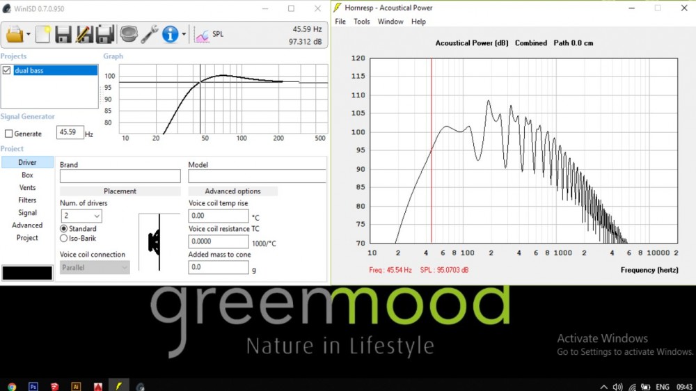

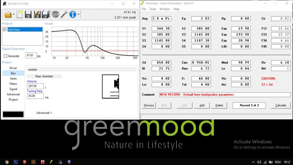

hello guys. i want to build 4 tham15 for my 4 Paudio e15lf. I build one for tests out of chipboard. in all graphs the xmax (6mm) is way passed, even with 400w power.
i can power them with a tamp 4 700 in three ways
1. 4 channels on each subwoofer 4x~490 8ohm
2. 2 channels in bridge for a pair 2x1800 4ohm
3. 2 channels NOT in bridge for 2x800w 4 ohm
i want to make 2 ch bringe only for some headroom, but the tentation to crank them up will be preety high.

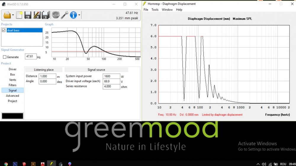

i made a simulation with e15lf in tham, and anotherone with e15lf in dual reflex cab (the cabs that are curently in). So my question is: will it worth it to build another th cab for these drivers? i like the way how th punch. My problem with the dual reflex is that they seems too soft for a 1.5kw subwoofer, and the lack of bass in front of them (but plenty in the back)
Hi Jeferica,
Generally speaking, a single tham15 should have a similar output to a dual reflex cab due to the added efficiency of using the folded horn design. This means you need a lot less power (and can use cheaper amps) to get the same SPL when using the tham15.
The disadvantage is that the dual reflex cab will probably go a fair bit deeper.
Depending on the dual reflex cab you have a second Tham is likely to equate to having two dual reflex cab's.
Also when coupling multiple subs you will see a further 6db of efficiency so it's often worth getting a second sub and running them in Parallel to get 4ohm.

Also a note on the Xmax question. xmax is when distortion reaches a THD of above 10%
What this all means is that once the xmax has been breached you should start to hear some very noticeable distortion.
xlim is the limit that the driver can take and damage will ocur.
One thing to note about simulations in horn resp is that it tends to over exaggerate peaks. In turn this can over exaggerate the diaphragm displacement measurements.
Best thing to do is a bit of trial and error. You will instantly know when your pushing it too hard as you will notice a large increase in distortion. Just don’t start by cranking it to the max

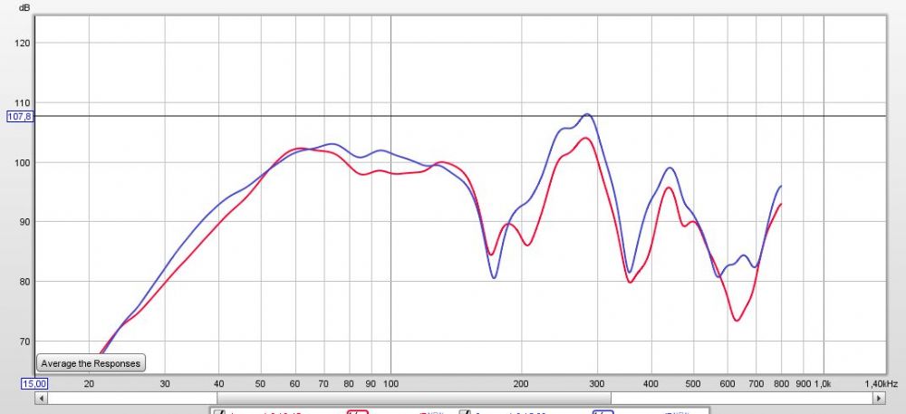

The worst one I have tested was RCF L15P200AK, absolutely no go for Tham but very good standard reflex driver. Even tho it might look like a good candidate according to specs but in practice it just lacks something and sounds horrible. L15P540 is much better as example.

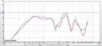

Red, P200AK. Blue, P540

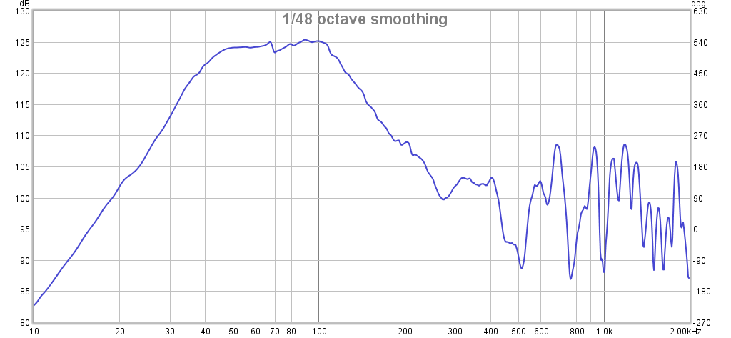

Those response curves illustrates the interesting thing I find about DIY THs in general. If I saw curves like that from a standard 4th order 6th order BP alignment that I was trying to put together, I'd toss the design and go back to the drawing board to come up with something better (like the attached, which shows a lot less out of band noise). But somehow a near identical FR curve is somehow acceptable if the alignment in question is a TH, and people have reported great success with it in actual use. Go figure...
