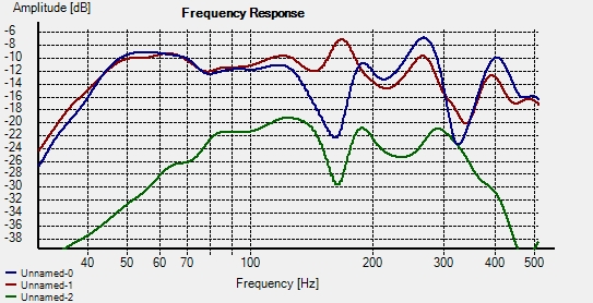

As an aside, I compared the THAM15 to the SS15:
Not surprising - isn't the SS15 a larger box? If we can successfully deal with the notch in the THAM15's response though, the result would be something with a wider passband and lower cutoff frequency.
Question: how do these compare to a simple vented box using the same driver?
You may want to build your own THAM15 model from the plans.
It should look something like this with 2.83v:
Xco1's model on the first page is pretty close. L34 is a little long, do to his measuring a right corner at the end. You want to measure without the line through the corner, and then place the area line to account for the volume in AkAbak.

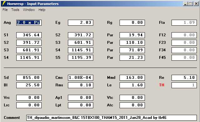

Hi guys,
I did build my own ACAD model, and arrived my Hornresp Input data from there. I even used soho54's corner method. I also started with an overlay on Xco1's nice drawing. For general comparison, and future development I used the 4-section model. Let me know if you see any mistakes.
I agree on the internal volumes: according to Hornresp using Par for both models: THAM15=149.7 Litres / SS15=209.757 Litres. I've designed quite a few folds for the 15TBX100 that don't have the big notch. I think it is mainly a matter of increasing L45 and S4/S5, and go with a slightly larger volume (about 190 ltr, or so).

It is jam up except for the S3 point. You just picked the wrong spot. If you take your model, and unfold it you will see the S3 point should be at the last bend. Right before it is a large section with zero flare around the 180deg turn, and then a constriction followed by a large increase in volume over a short distance. You have too much volume in the 3rd quarter of the horn, before the tap to model the real horn.
The total length, and horn section area numbers are spot on though, and very close to what I got from my own model. ;)

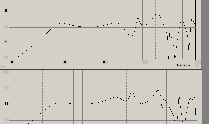

The dip in the finished THAM15 is a fold translation error. HR can't quite sim it perfectly because of the non flared section. You need one more segment to completely capture it. As such the second peak(3rd Harmonic) is a little overstated, and the first peak(1st Harmonic) is a little under stated. AkAbak handles things much better here.
EDIT: also, you don't want to use the supplied BL or Mms as Mmd. Let HR calculate those for you. It makes a big difference sometimes.
It should look more like the purple line here.

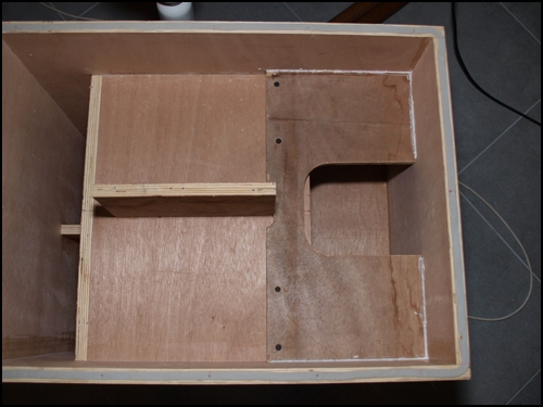

After some more fiddling around, I settled for the simplest "fix" possible - a piece of board across the 3rd fold that cut the cross-section at that point by 2/3rds. I've included an image of the change below, along with the measured frequency response before (blue) and after (red) the change. In green is the response measured at the point - I noticed that it measured fairly flat before the addition of the extra panel, and the notch appeared after the addition. All responses are 1/6th octave smoothed. Most definitely the extra panel changes the response at that location. Perhaps taking measurements at that location could help to fine-tune the modification.
There's an audible difference before and after adding the "dogfood duct". Whether or not that difference remains audible once the TH is used as part of a full-range system remains to be seen.
Concerning SPL and compression measurements, as I mentioned the neighbours are back, so hooking it up to the car amp to give it a good 100W or so was out of the question. However, I did do some testing in-house and it seems to remain quite linear up to the output capabilities of my (admittedly small) temporary amp I'm using at the moment. Basically I used HolmImpulse to measure the FR and stepped the output level up by 10dB per step, and set HolmImpulse to auto-adjust to 0dB. My thinking was, if the resulting graphs overlay each other perfectly, then compression is basically non-existent, and they did up to the limits of my amp.
If the neighbours are out tomorrow, I'll repeat the test using my car amp, which should add about 6dB of output capability.

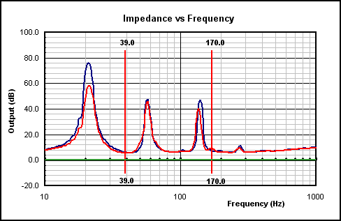

...and here is the impedance response, before (blue) and after (red) the addition of the duct. Looks like Fb shifted down from around 42.7 Hz to 39 Hz, and there's an additional "ripple" at 170 Hz, where the new peak in the FR is located.
Good to see the FC drop, and tale-tale Impedance wiggle.
