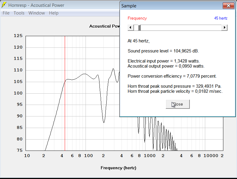

For kicks, I compared the Beyma driver (featured on your site, the Beyma12LX60V2) loaded in a THAM12 (some minor corrections made to your model, e.g. the use of PAR segments and cone compensation) to one loaded in my POC6 build, which is an offset-MLTL. The THAM12 is tuned slightly higher (about 1 Hz higher) and the box is a bit bigger (95 l net vs. 64 l net). The THAM 12 seems to be a good 3dB more sensitive through its passband, but output at 40 Hz is about the same (suggesting a steeper rolloff) and of course everything goes crazy above about 150 Hz while the POC6 is flat up to about 300 Hz.
The designs look comparable on paper, but what Hornresp does not show is that the THAM12 likely suffers from very little vent compression at the lower end of the passband, while I've measured up to 2dB at Fb. Sometimes the sims don't show you everything .

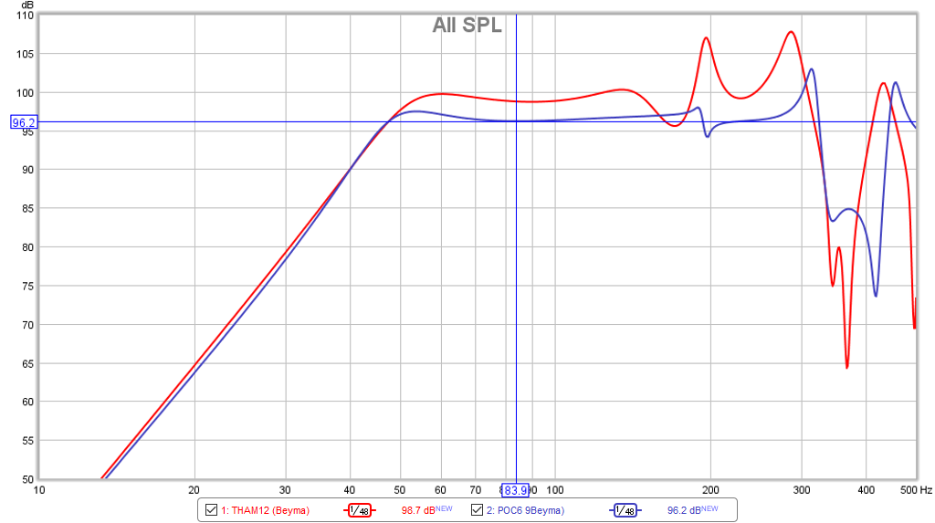

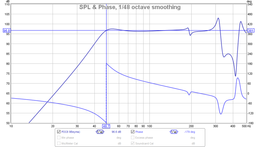

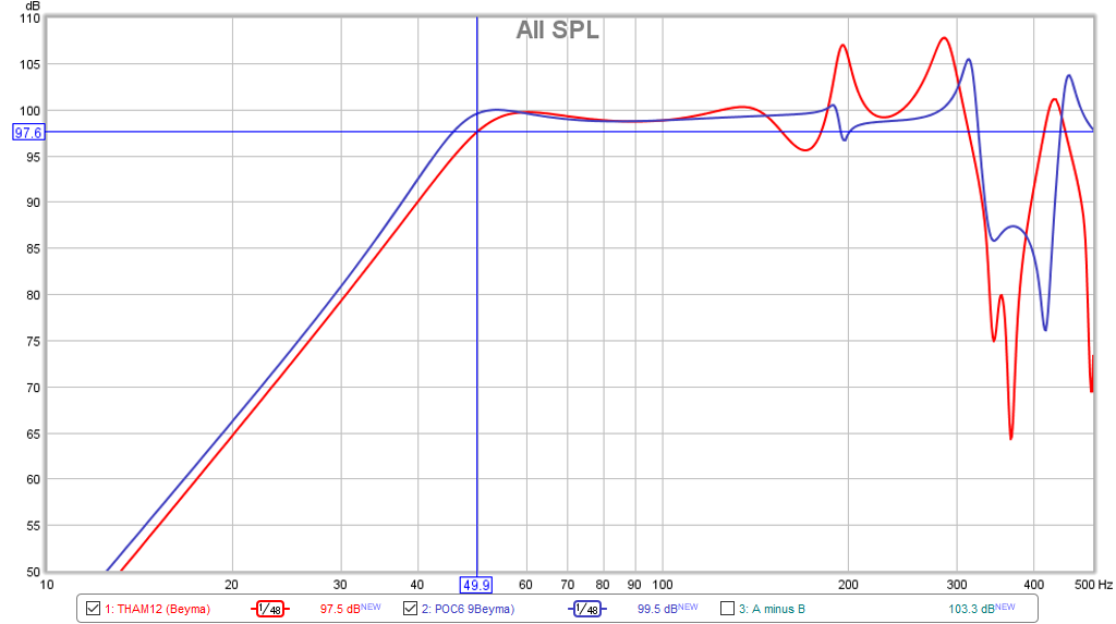

I had another look at the comparison, using REW and data about the two designs exported from Hornresp, and came up with the following:
Image 1 - this shows a direct comparison between the THAM12 and the POC6. Below 50 Hz, the responses are pretty close, but it must be said that's below the passband for both designs. Above that, the THAM12 is about 2.5dB more efficient, for about 1/3rd increase in box size. The illustrated response curve for the POC6 is a bit rougher than expected because the Hornresp export does not include the impact of the stuffing at the start of the line, which with smooth the response above 100 Hz. There will be no "blip" in the response of the POC6 just below 200 Hz.

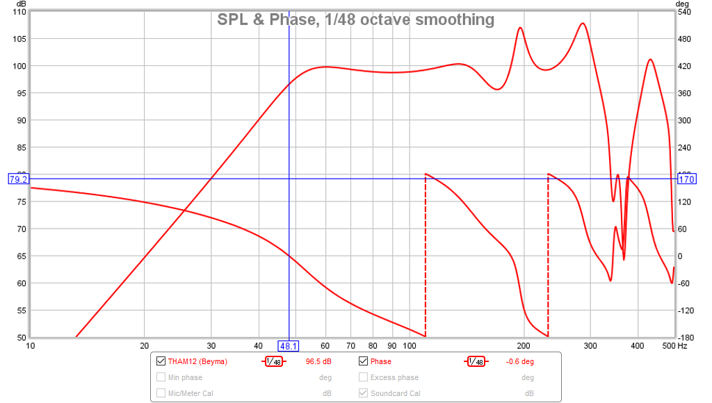

Image 2 - Phase response of the THAM12. It goes through a 180 degree phase shift from 48.1 Hz to 110.2 Hz, and again between 110.2 Hz and 184.9 Hz. Note that the lowest resonance frequency is at 48.1 Hz (0 degrees).
Image 3 - Phase response of the POC6. It goes through a 180 degree phase shift from 48.7 Hz to 227 Hz, less severe than the THAM12, and there's only 60 degrees of phase shift between 100 Hz and 200 Hz, compared to over three times that for the THAM12. Theoretically that should make integration with a "top" speaker a bit easier, but that's theoretically.

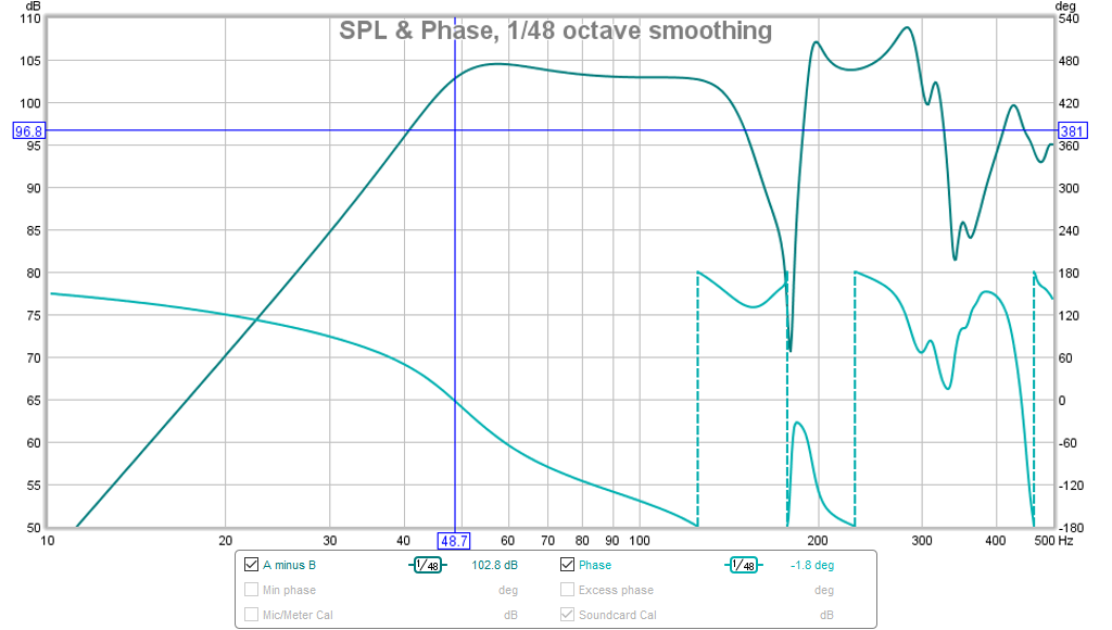

Image 4 - What if you stack these two boxes side by side and play them together? Well, this would be the result. It doesn't actually look too bad below 120 Hz, so maybe THs and vented/MLTL alignments can play nice together for bass reproduction.

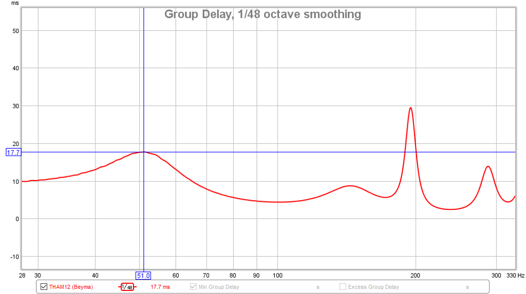

Image 5 - GD for the THAM12. Up to ~140 Hz, it actually seems to be better than the POC6, particular when you consider the delta GD is about 13.5 ms.

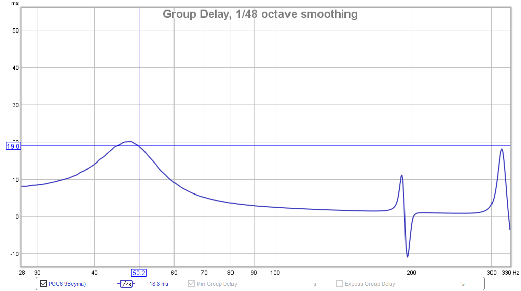

Image 6 - GD for the POC6. A bit worse than the THAM12 across the passband. the audibility of GD at these low levels is somewhat debatable however.
From the results, one could say that the THAM12 is larger and a bit less easy to integrate into a system, but will require just a little more than 1/2 the power to achieve the same SPL levels as the POC6 within its passband. At higher SPL levels the difference in output will be greater around 50 Hz and below. The POC6 however is smaller and a bit easier to carry (because of its form factor).
One last one...
Image 7 - the responses of the POC6 and THAM 12 at the same passband level (the response of the POC6 adjusted 2.5db upwards). The POC6 exhibits 2dB more output at 50 Hz, but that will disappear at higher levels due to vent compression.
