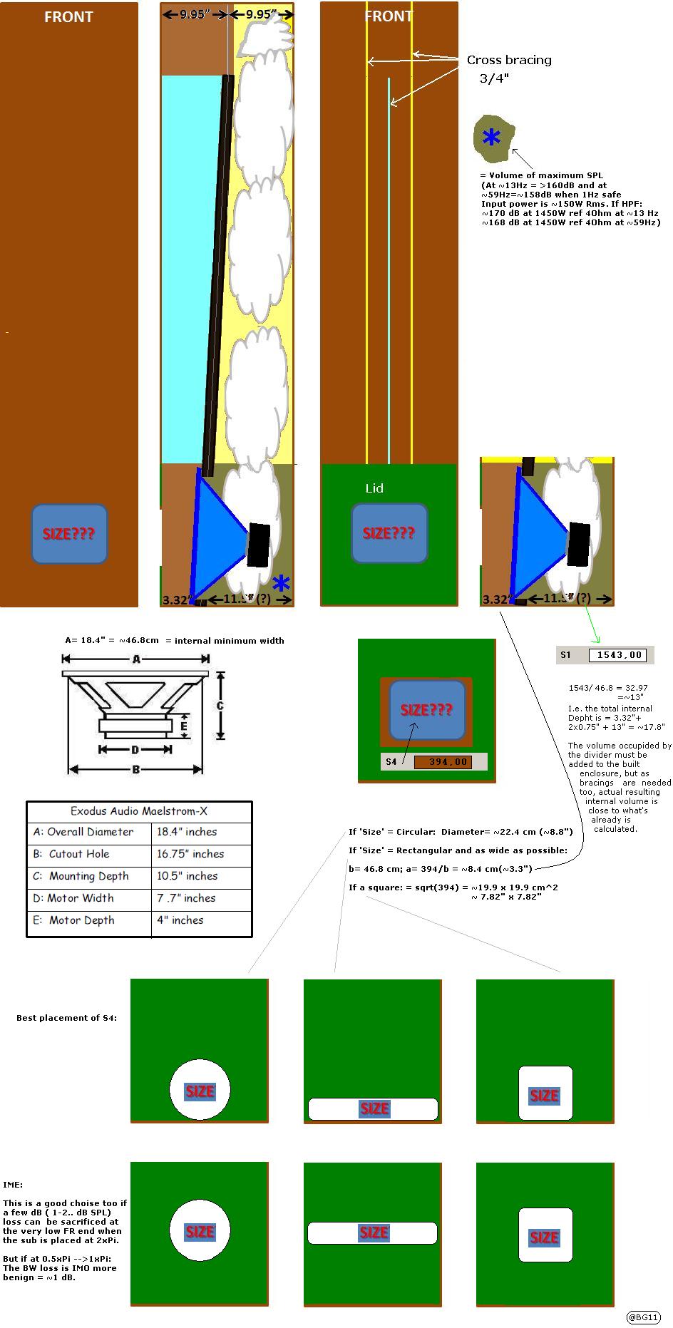

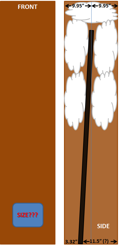

Trying to put the design submitted by bjorno into a scale drawing so i can develop plans (see attached). Still cannot find on the MJK spreadsheet the size of the front opening (alt S4). I also just guessed on where the 4.407 lbs of stuffing should go. I assume this is polyfill, but would something like R19 isulation also work?

It's polyfill. I'm quite busy for the moment..I will later reply to your post #21...but here is a picture that may clarify a bit:

I am not in any particular rush, I am in Cambodia and the driver is the US. I am thrilled that you have been willing to spend the time to develop an appropriate enclosure for the driver.
The picture does clarify, looks like the build should not be terribly difficult.

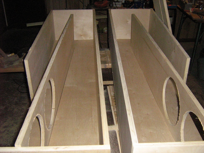

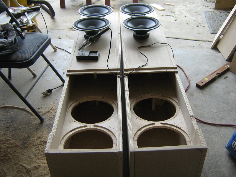

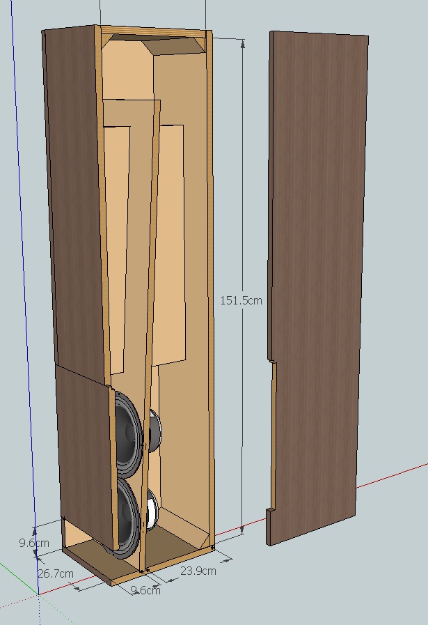

Yeah, it looks a lot like the one I did with B's help, I'll attach a few pics for visualization. Of course, yours will be larger with the larger driver.
Thanks for the pictures, it definately helps me to visualize what this design will look like. I am planning on placing the sub either standing in a rear corner or horizontal across the front soundstage.

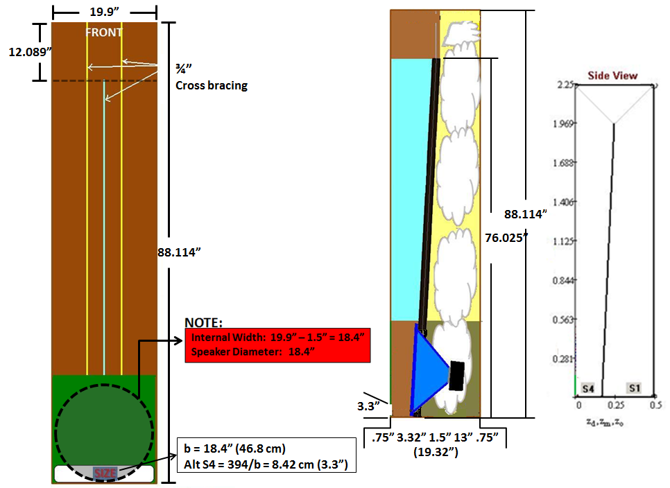

Spent a lot of time studying the picture - it contains info that answered a lot of my questions, thank you so much!!!
Based on the MJK data you provided earlier, the speaker will be 19.9" Wide x 88.114" Tall x 19.32" Deep. With these dimensions, the internal width of the fron will be 18.4", which is the diameter of the driver. Is this okay?
I have made a crude drawing of what I think are the correct dimensions, if they are right I will try to draw out a cut sheet for the project later this week.

..Based on the MJK data you provided earlier, the speaker will be 19.9" Wide x 88.114" Tall x 19.32" Deep. With these dimensions, the internal width of the fron will be 18.4", which is the diameter of the driver. Is this okay?..I have made a crude drawing of what I think are the correct dimensions, if they are right I will try to draw out a cut sheet for the project later this week..
Your drawing looks OK and you're right: The internal width is minimum 18.4" rounded up to 46.8 cm. In reality you may be off an 1/2" on any dimension as a T-TQWT like an TL can easily be compensated to correct tuning using the amount and density of the damping material.
Referring post# 21 :
1.IMO, Any power-amp above ¨200-300W would be sufficient for sane SPL in typical home environments as this speaker is displacement limited, not by power but if equipped with a 12 Hz Bw4 HPF/ 50 Hz LR4 LPF the maximum available Power would be around 1450W into 4 Ohm at x-mech.
2. S4 is 394 cm^2 and is sufficiently large but may be enlarged to Sd/2 if ~1-2dB drop in SPL and a few Hz lesser BW are allowed at the lowest in-band end of the FR.
3. I think the sturdiness of the sub box and/or the room soundproofing set the SPL limit not the eventual heard "port" noise.
4. I cant find negative trade-offs when I choose to design a T-TQWT compared to a closed/ported or TH enclosure for a specific driver, do you?

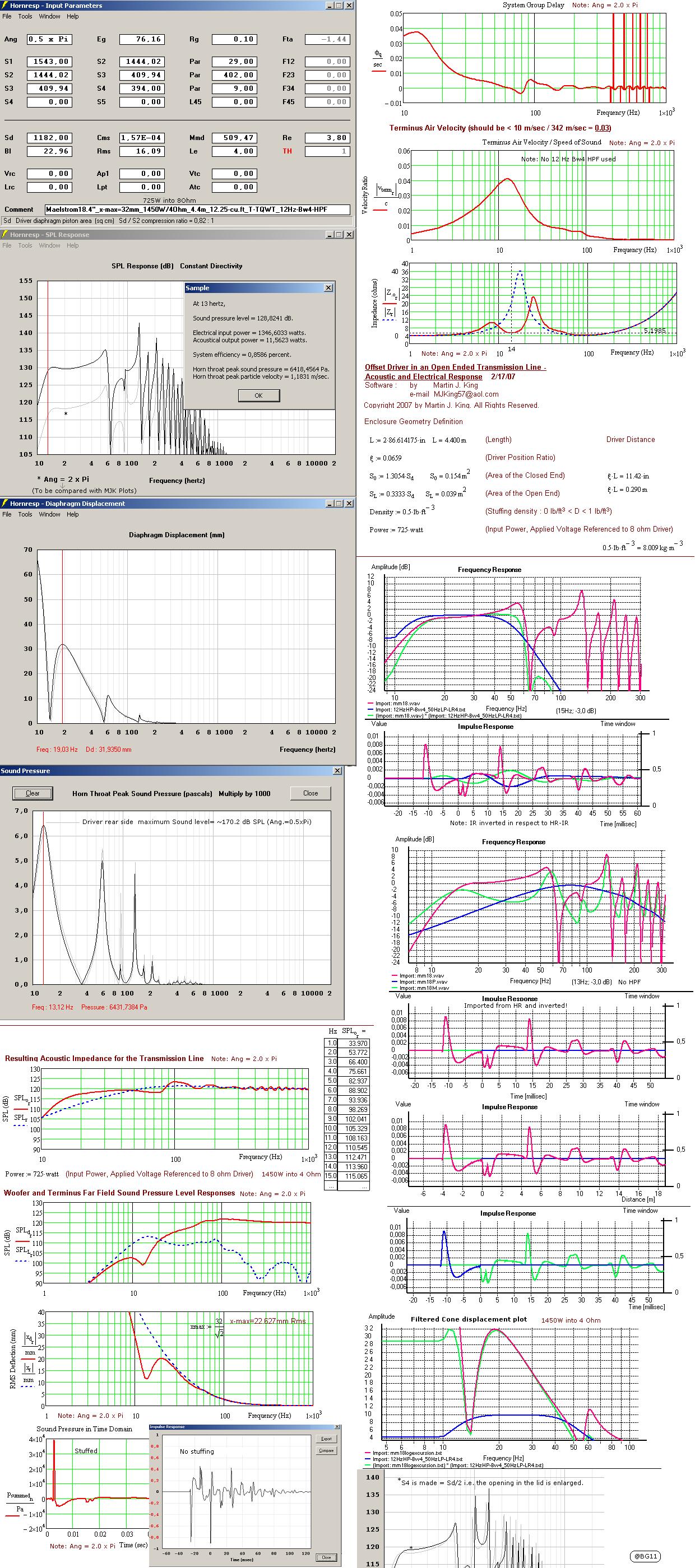

Supplementing the earlier pictures using max power as the input level:

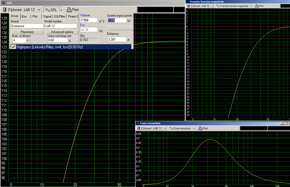

I have attached the WinISD modeling data for the 4 LAB-12 subs I will be using with this build. The calculation is -3 dB down at 44.39 Hz (121 dB). Calculations are based on maximum power that does not exceed cone excursion with an HPF (20 Hz, 4th order LR).

I believe a distributed bass system that models flat between 13 and 100 Hz at over 120 dB will be more than enough bass for my needs. My current setup while stationed overseas in Cambodia has 2 of the LAB-12 subs and an old Paradigm PDR12 and really sounds pretty good (no measured response less than 20 Hz in the room).

...when B gave me the dimensions for these tubes and I built them, my jaw has pretty much been on the floor.

Haha, nice. I noticed with mine (I don't have any measurement tools yet, so I can't be certain) but when I first made them I sat them up right next to my mains pulled out into the room away from the walls and the response seemed to be just about what you're looking to have them cover, I.E they seemed to cover from about 20hz up to 40-ish.
A good music example is the track "Grandaddy - He's simple, he's dumb, he's the pilot". At about 4:45 into the song, a slow moving bass line starts. With the subs out in the room, the only note I could hear them produce was the lowest note in this bass line. While I was laughing, my room mate was quick to quip "So....really, they're earthquake generators...not subs?"
I use them as my only sub so I ended up settling on them wedged in the corners which seemed to flatten them back out all the way up to 80hz. Maybe having it out of the corners in the room will give you the response you need without too much crossover or eq tweaking. I know there's a relationship with pi space as it relates to the response you'll get, but I'm not sure what the actual effect is or how to explain it with a chart, but wall positioning plays a big, big role in the response these have.

Hello Bjorno, or anyone else who wants to discuss.
I do not have hands on experience with one of these designs yet but they seem to be quite popular on this forum so I am interested in why. From looking at quite a few simulations I would list very limited bandwidth as issue #1. Also sensitivity seems to be lower than an equivalent sized TH. Response in the time domain appears to be much worse than a sealed or ported alignment same as with a TH or FLH. Ringing abounds anywhere other than over the almost 2 octave wide bandwidth where the alignment is most effective. In this case maybe 16-60Hz.
Since this seems to be essentially a reverse TH with many shared characteristics. I suspect that the distortion and compression might trend the same in general ways. That is to say that the distortion will be very low in some areas typically below the 5th harmonic of a TH it will be very low in THD which would mean the same for these and at the 5th and above THD is much higher and wildly varying with frequency and power above that point. Of course the TQWP is completely unuseable much above that point anyway, but a TH can potentially be beaten into submission with EQ, damping and perhaps internal pipe resonance cancellation (DTS-20) enough to work, ok. Potentially the THD might possibly be even lower for a TQWP over the useful bandwidth due to the cancellation effects of the enclosure on frequencies corresponding to the harmonics.
Are their any in depth investigative measurements of a TQWP that someone can point me to?
A basic 320L total volume, 20Hz tuned vented alignment utilizing a vent of 365cm (Equivalent to 2 6" flared ports) seems to have just as much sensitivity and maximum output as the TQWP presented here over it's useful bandwidth. In addition the vented alignment will have better response in the time domain and could potentially be used up till 150Hz or higher if needed.
The TQWP seems quite similar in operation to a 6th or even 4th order BP. What are it's advantages against them?
