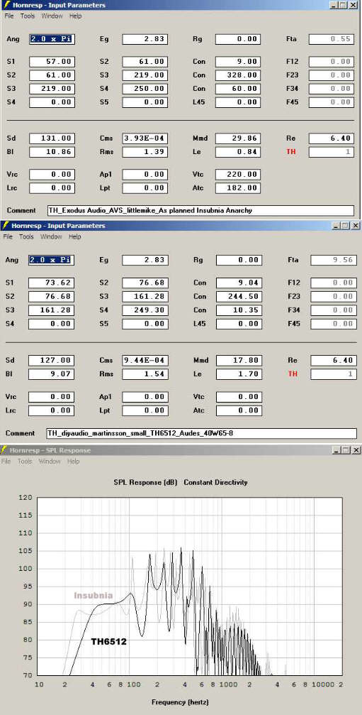

Maybe this will help to get you started:

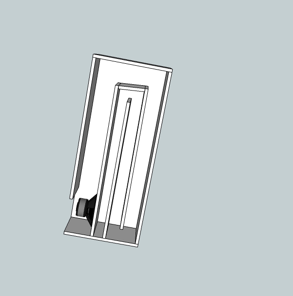

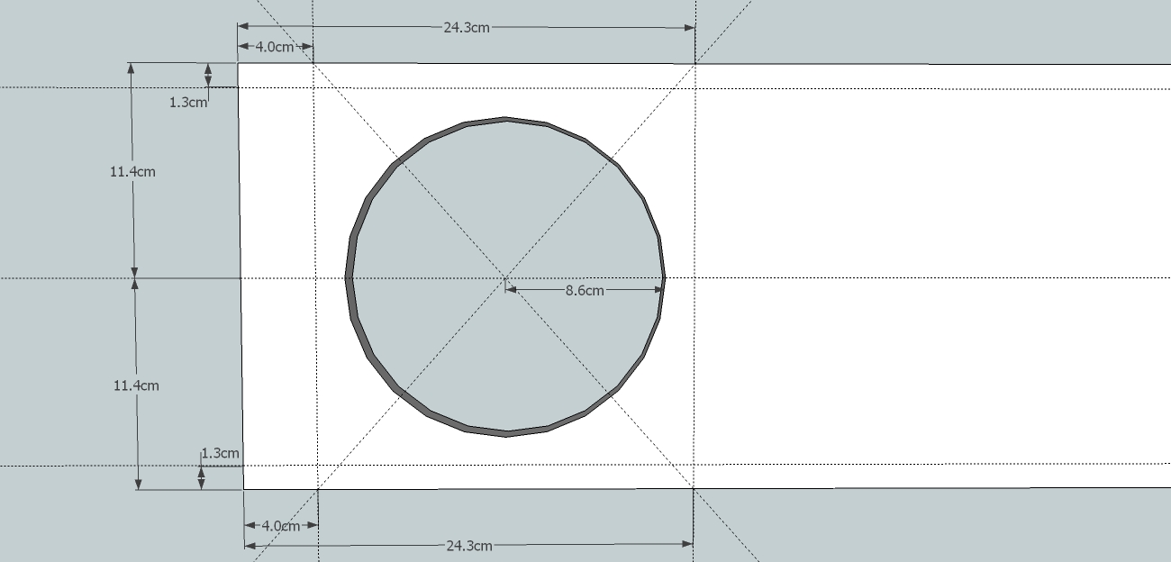

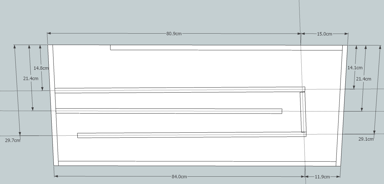

my 8" th
merry CHRISTmass to you all and a happy prosperous new year
