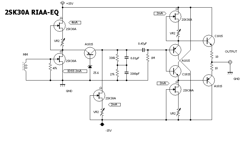

I built a discrete unity gain buffer using a pair of complementary FETs and a pair of BJT's. The design was by Linsley-Hood who professed not to be able to distinguish between this and LF351/353 op.amps - this mainly on the grounds of simpler circuitry and had better phase linearity. It has been a while since I used the preamp where I installed this input buffer.
As far as a pull-down constant current source connected to the output is concerned the circuit representation for MC33078/79 shows the output NPN's are driven in split phase with a second NPN in parallel with the output NPN in the negative half circuit.
The second NPN collector is loaded with a constant current source and there is an alternative current path via a diode and resistor to the output. This stage operates in a form of single ended Class A.

You can use better quality parts in a discrete circuit.Thoughts ?
Joined 2009
Joined 2009
It is an interesting idea. It functions as a LTP that is NPN PNP. Looking back to No53 it is subtly different if saying that example ( or not so if being strict ). The interestingh thing which I infer is the NPN/PNP curves work to a better result. I hope someone simulates this for us as it looks to be a winner. It also looks like something Naim would have liked. It dates back to the era also.
