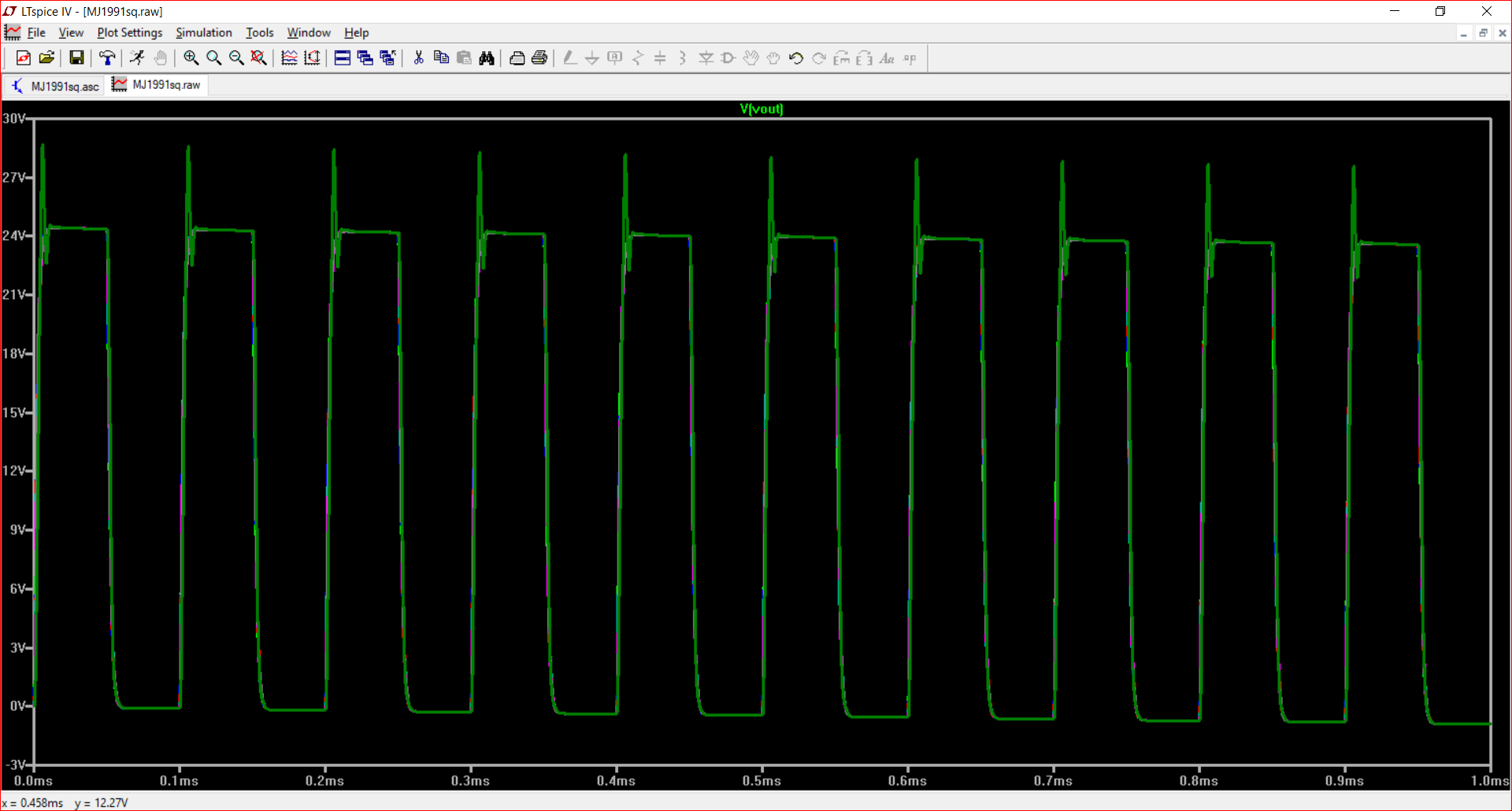

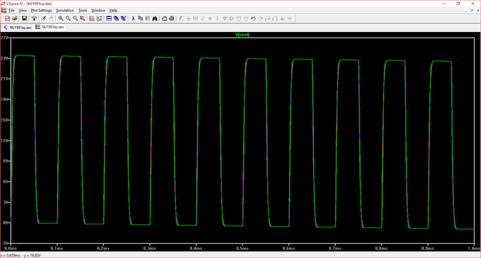

These are simulations.This is the output of an amplifier with a complementary bipolar output stage on square wave into 8R showing the overlaid results with parallel capacitor values of 5n,10n,100n,220n,470n,1u, and 2u in one shot.
In the real world you can ended up as picture in post #829(when using 1 or 2uf//8R) only with an overcompensated amplifier.
Are you sure that you like such an amplifier?
The point being made was not about the particular amplifier but the use of 10 kHz square waves to test for feedback loop stability.
The rise time of the step for a test frequency of 1kHz does not equate to a frequency in the domain where stability becomes an issue.
If one has electrostatic loudspeakers - difficult loads - but nonetheless reputedly having less distortion than conventional types, some sacrifice of amplifierTHD performance in favour of stability is one that some could accept.
