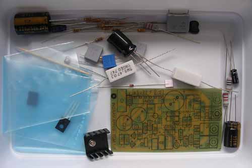

I did go back and look at Spice to see what impact there was in changing the bias current on the drivers (as Carlos had suggested). Even with 180R I had just over 12mA. I increased this upto 220R to drop the current. No impact on distortion characteristics. Hugh says "On the AKSA I use 5.5mA, 8mA for two output pairs...the resistor will typically be around 220R for a single pair".
I still need to drill the pcb and think about how to go about matching transistors and how closely they need to be matched. I have started to kit the parts...

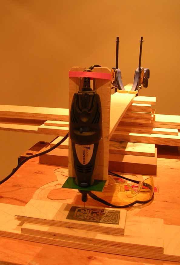

BiGun-maybe this will give you and everyone else a laugh, here's my pcb drilling set up.
I like that drill rig.. I must make one for myself.

Thanks ! - have now finished the drilling, tried each part in it's place, everything lines up. This was also the first pcb in which the toner transfer simply worked first time around (instead of making me want to throw it all out the window). It's a good omen.
