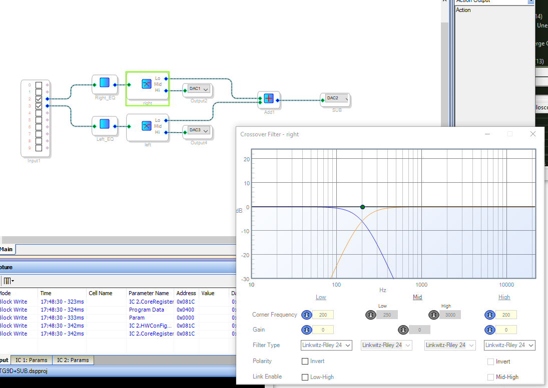

Any suggestions what to do with 4 of these:

There are some box plans on that site too, but for a pair. I got 4 to put in motion.

I'm looking forward to hearing your thoughts about them.
How is this drop handled by Nola Brio? It's the similar setup afaik. I still need to do some measurements.It's not the low I'm worried about here. It's higher up.
Your TG9 will drop considerably under 350Hz, yet you have a 200Hz XO...
I have miniDSP HD, but that freeDSP looks nice as well.
I don't see any drops around 350Hz in the datasheet. Where is that coming from?
http://www.tymphany.com/wp-content/themes/pathfinders/cache/pdfs/TG9FD10-08.pdf
That little speaker mounted on that tiny open baffle. It will not reach the same as the specs which are taken on an infinite baffle... Your baffle is the exact opposite of infinite.
Also, the Brio uses 2 drivers, one is open, the other in a small vented box. They probably reach 120Hz with the vented one, 80Hz if pushing it ,and uses subs to fill the low end.
I tried its paper counterpart, the TC9, on a baffle 3 times the size you have and it barely went reached 300Hz before falling.
