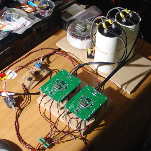

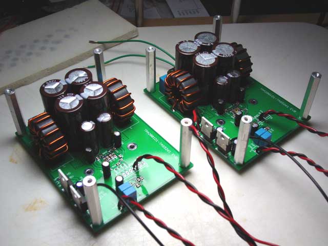

BWRX said:Now to work on fixing them to a board and wiring them up... correctly
So far so good. Now I just need to find a way to hold the heatsinks on the chips' heat slugs so I don't go welding metal...
To those who will be building these - please take the time to properly mount the power supply components and the boards as I have sort of done Also be sure to properly secure the heatsinks.
My boards are mounted to a block of MDF and the power supply components are mounted to another piece of MDF. My heatsinks are "secured" by rubber bands at the moment, but please be sure to attach them with screws and ensure that they won't short anything out. There are lots of things that can and will go wrong if you aren't careful - especially when dealing with AC mains voltages and high current DC power sources like the ones meant to be used with these boards.
pinkmouse said:I've spotted the deliberate mistake! You have four standoffs, but only six screws for them on the BOM and in the kit.
Do I win $5?
Four of the screws are of course for mounting the standoffs to the PCB. The other two are for connecting a heatsink. I left it up to you guys to decide what type of screws to use to fasten down the standoffs to whatever case, block of wood, etc. you wanted. They're standard 4-40 threads so hardware should be cheap and easy to find.
The rubber bands I was going to use were not UL certified so I just decided to cover the exposed areas of the heatsink with paper and tape and let them sit on top of the chips. This approach was only used for a "can't wait to hear it" listening session but I was afraid any slight movement would cause or Luckily I didn't do anything stupid and the amps are still fully functional.

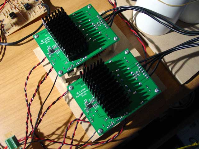

Just so you guys know, I've had my pair playing some nice music since late last night but I just got some proper heat sinks installed about 30 minutes ago. It's nice not having to worry about knocking the heatsink off and killing the amp.
And you'll be happy to know they sound just fine with my 8 ohm speakers. All frequencies are there and there's plenty of power on tap that I can't use with these 90dB @ 1w/1m monitors. As you'd expect with a dual mono configuration the imaging is very good. I wish I had some harder to drive speakers to test these with... the worst I have here is some larger Klipsch speakers that are still only 8 ohms but do like to be driven with more power.
There is a bit of a high pitched whine though, and that's due to the inductors of the two amps being so close together (it's the biggest scrap piece of MDF I could find!) and the switching frequency of the two amps being unsynchronized. If I turn one amp off the whine goes away.
