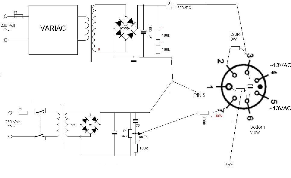

Some days ago I bought some 13E1 tubes under the condition that I could test them and in case they were bad I could return them. I do not think they are bad, as they are in white boxes marked which tube they contain (so, no generic white box), and according to the seller, came straight from the Dutch army (code 5960). There are not any spots or whatever on them.
So I want to test them. I set up a test jig, as shown on the picture. My idea is to heat the valves, apply a voltage of -60V on the grid, and slowly, with a Variac, rise the B+ voltage up to about 300V, where, according to the datasheet, the tube should be drawing 200mA.
Today I concluded the test jig, fit in the first 13E1, let it heat up for 30 minutes, and then slowly started to increase the B+. When I arrived at about 180VDC, there was no current flowing, but then, suddenly, things started to go fast with 200V on the plate and -60VDC bias I was getting about 1.5VDC across the 3.9R resistor in the cathode, which corresponds to about 400mA being drawn through the tube. Well, I expected the tube to draw some current, but that much... the tube also made a 'purple' flash... I did not give up I:
- increased bias (turned it more negative)
- current drawn went down
- increased B+
- current drawn went up
- current went down..
and so until arriving at -90VDC. But at this point the B+ was maybe at about 280VDC, with 400mA flowing. I was surprised that really small changes in B+ have such influence on current drawn: I know this is common for a tube like 13E1, just like it is for a 6AS7 or 6C33C, but so much... still lots of things to learn.
So, what I ask you is to give a look at the picture, comment on the procedure, etc, as I believe tere is a serious mistake somewhere, and I do not want to lose any 13E1 (although I am sure they can stand some abuse, maybe I am to abusive with them). In the evening I will do my homework, checking the whole circuit again
As to the pin 6: it is the heaters CT, I thought it would form a nice 'star ground', and now the heaters aren't floating anymore. I do not see any problem with it for those test purposes, but if you say: that is complete BS you did there, I will change it.
The HV trafo has an ouput of 330VAC (for 220VAC in), but with the variac any voltage can be selected. The capacitor is a really large 100muF/750VDC MKP.
I thank you all for your patience and time!

Just a guess, but could it be that it's breaking into oscillation? Try it with a 1k stopper, the 100k feed resistor from the bias dropped to 20k, and a small cap (like 0u01) connected from grid to cathode, along with the local bypassing of the plate which you've already done.
I think the connections are right, but your numbering isn't.

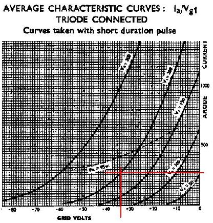

II have attached some curves I made at the time:
Later, I build a dedicated test rig, to see if I could push the limits. At the time I was looking into triode-strapping and wondering how far one could go above the g2 limit. I ran a 13E1 triode strapped at 500V and 200mA for a while on test. There were no red anodes, or flashovers.
And the fat pin is No 4

Thanks for replying. Under the test conditions I applied to the 13E1, 27 units had about 200V across it, with 275mA flowing. One unit tested worse (less emission). If memory serves me well only one tube was drawing grid current at this operating point (0.6mA).

Boy have you made a mistake. No wonder you had problems. i don't know where you got the pin connections for the 13E1 from but they are completely wrong. So here is the correct ones:
The large PIn is pin 4 the CATHODE, reading clockwise pin 5 is the SCREEN GRID, pin 6 is the ANODE, pin 7 is the HEATER, pin 1 is the HEATER, pin 2 is the HEATER CENTER TAP, pin 3 is the CONTROL GRID
Also I would not recommend putting more than 375 volts on the anode, expect about 100 volts on the cathode across a 1 K resistor, this will give you about 100m/a
Good luck
Good luck
Yes it was thoughtless of me not to have included the pin-out in my original post on this thread.
As for anode voltage (I presume you are referring to triode mode) I think one could run at more than 375V. As I wrote above, I tested a 13E1 at 500V and 200mA. I ran it probably for twenty minutes at these levels. Of course it was a static test and I doubt that I would actually run these levels in an amplifier, but I would be happy I think at 425V and 150mA or so.

Hi Petrotek and Paul L.
Indeed there was a problem with the pinout...as SY suggests in post 2: "I think the connections are right, but your numbering isn't." Eventually I could measure them and they were all measuring well, even though there was little left of their getters.
