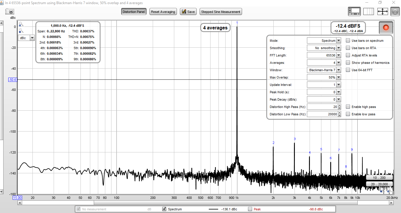

Here's the loopback measurement of my Motu M4.
(Single ended) Monitor out #2 to Line-In #4 (-IN tied to GND)
Asio driver 48kHz sample rate

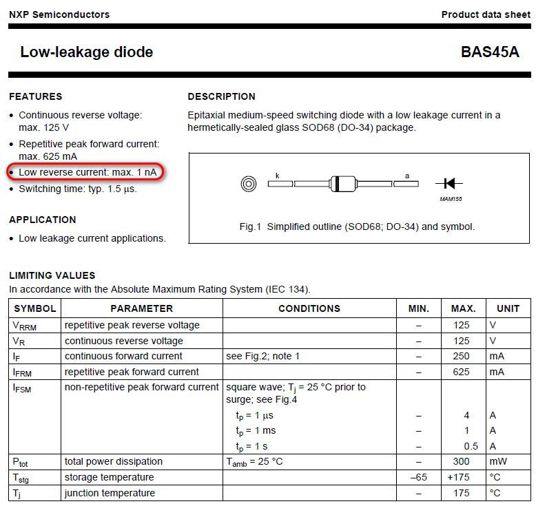

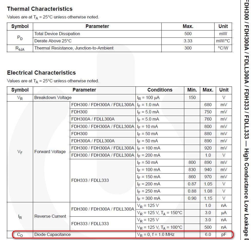

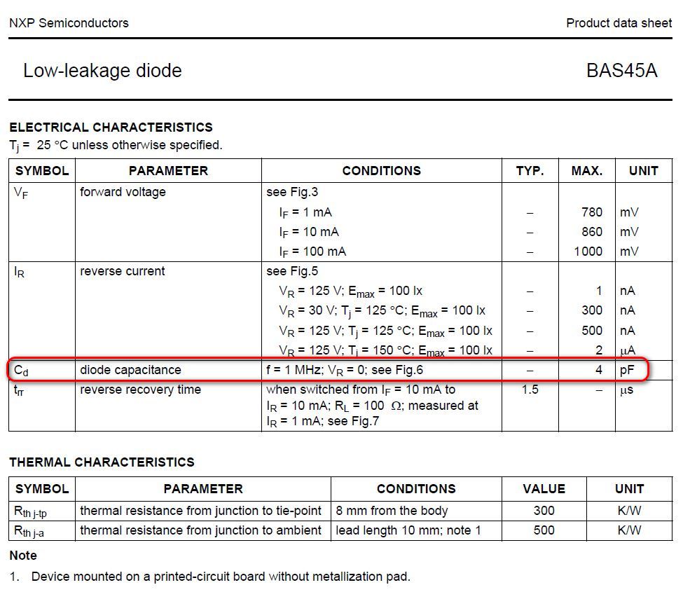

This issue has also been discussed here. I assume 1N4148s that are used in Pete's soundcard interface have too high leakage. Next I will try the FDH300s that Jan Didden is using in his AutoRanger.
If it is a leakage issue, the Nexperia BAS45A diode has very low leakage (1nA), but one may have an issue with excess junction capacitance (which is voltage dependent). The BAS45A diode has lower junction capacitance than the FDH300 diode.
