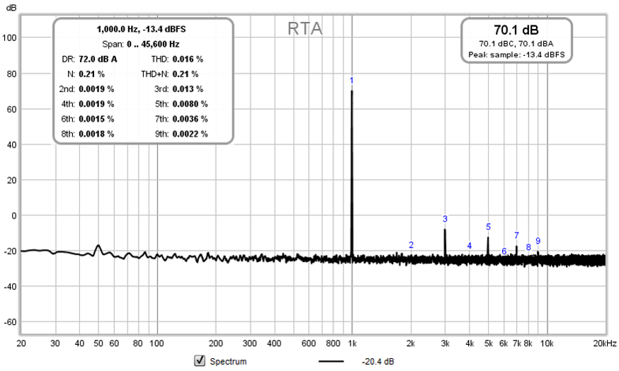

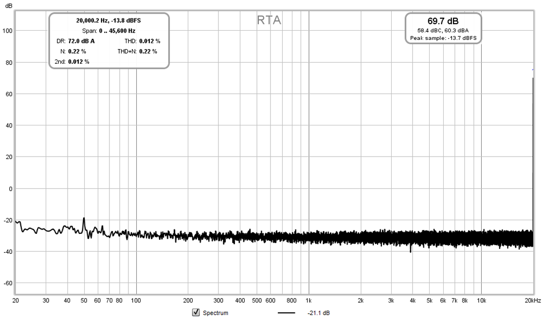

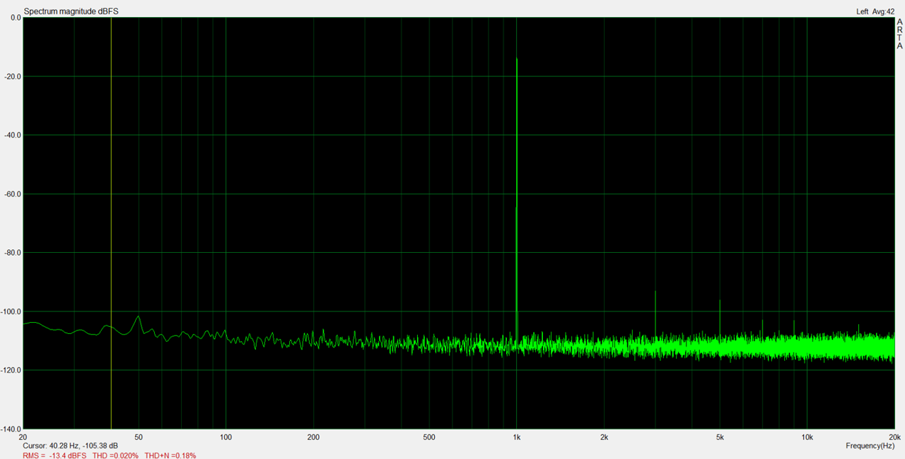

What performance can I expect?
I'm happy that my soundcard interface is working perfectly with THD of ~0.004% and Noise around ~0.06%.
I've tried Testing an amp that is supposed to have <0.001% THD 20Hz to 20kHz and SNR -124dB.+
Below are plots from ARTA and REW.
As you can see, THD is 0.012% which is a factor of 10 higher.
Noise is 0.22% which again is significantly higher.
Are these the limits I can expect to obtain with a PC/PC-based soundcard and the soundcard interface?
Thanks.

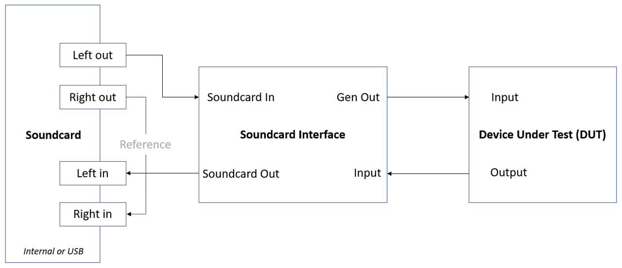

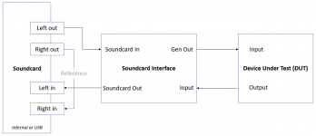

Test set-up
Among the many things I need to figure out:
- what interface I should be getting for this (Focusrite Scarlett 2i2 my choice this far...
Your test setup will look like the picture below. For the soundcard interface I've used Pete Millett's which is after-all the subject of this thread. The soundcard can be inside your PC or an external USB one.
I've shown the connection from the right soundcard output to the right soundcard input dotted. Some software has the ability to subtract it's distortion contribution. From the amplifiers I've tested so far the soundcard distortion is so far below that contributed by the amplifier that this isn't essential. You could get away with a single channel.
So, 2 components: Soundcard and Soundcard Interface. As Jan mentioned above, the interface acts as a buffer between your soundcard and the DUT. If you're testing an amplifier running at 100W the voltage across 8Ω will be nearly 30V RMS and you can't feed that directly into your soundcard.
I looked up the Focusrite Scarlett 2i2. It might fill the role of a soundcard but I don't think that's what it's designed for. I could be wrong which would certainly not be unusual.
