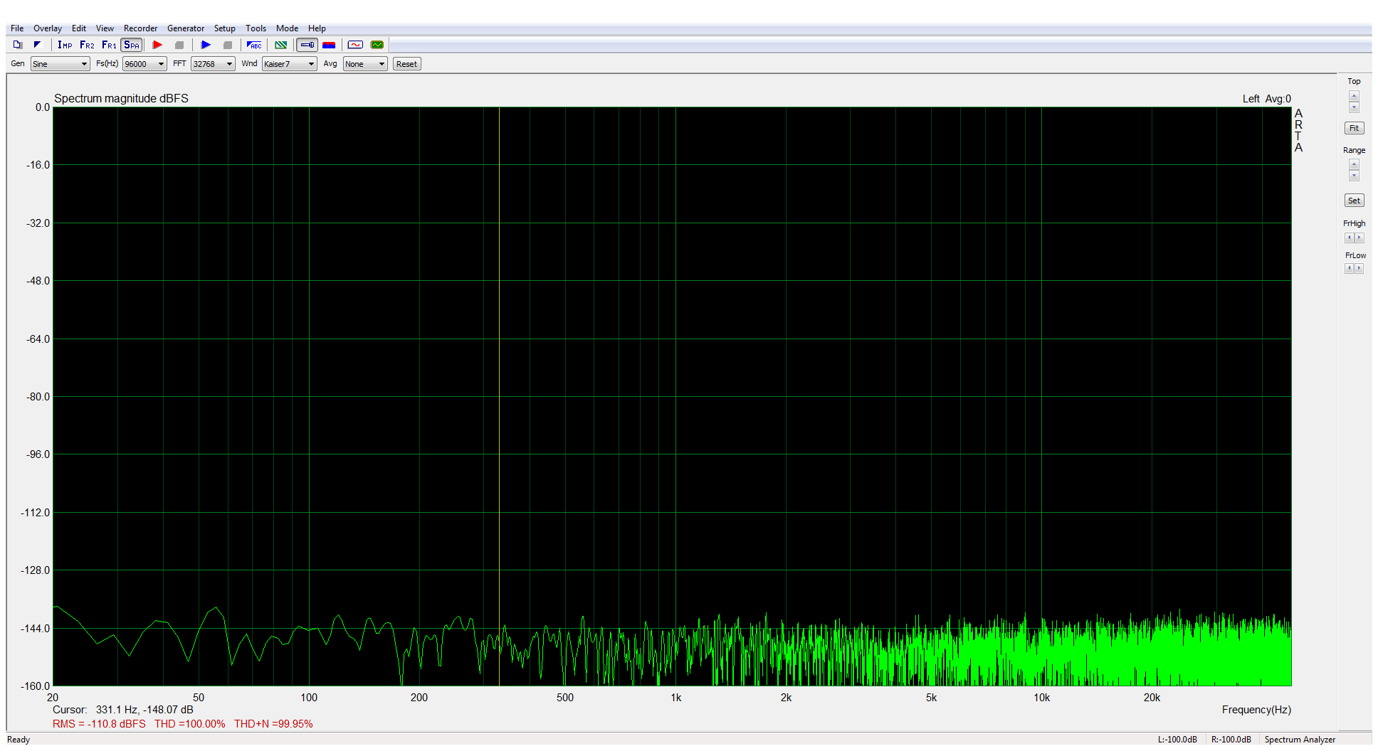

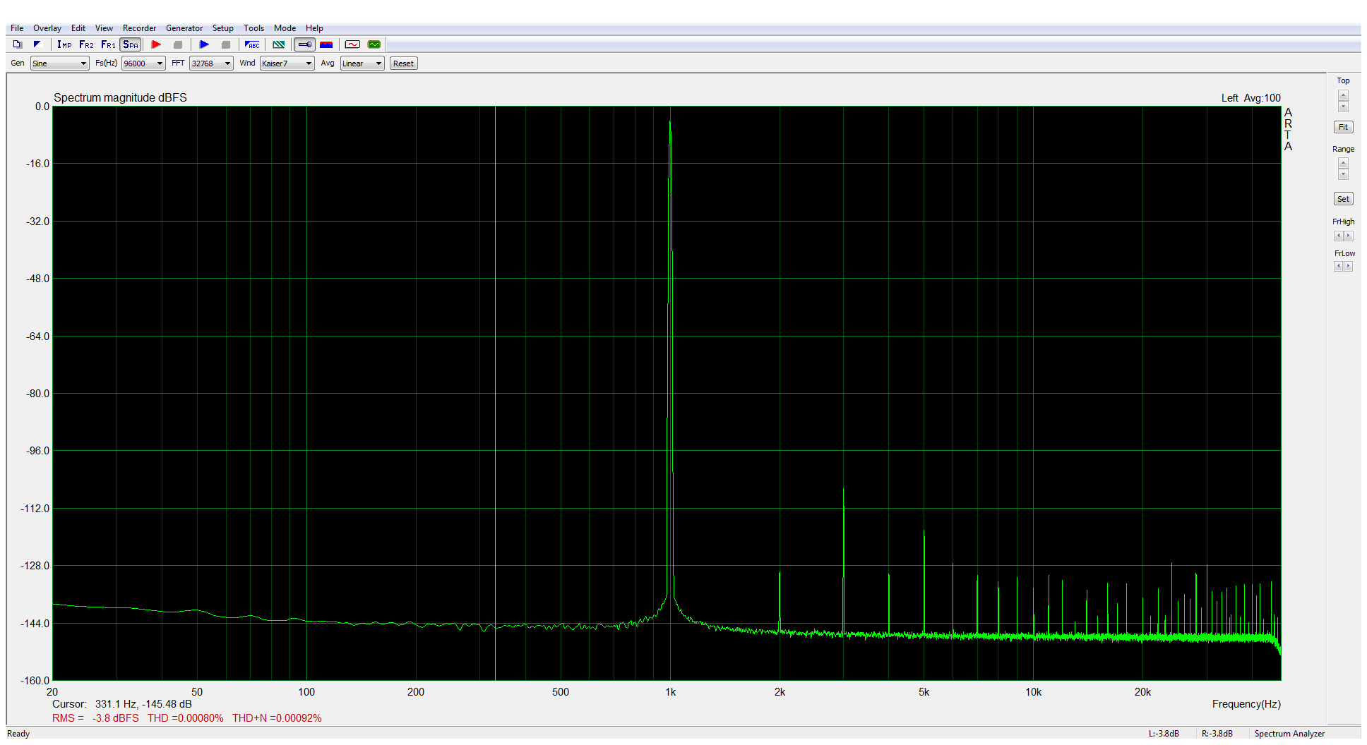

Hi all,
I think that SY don't speak about noise floor, but rather the noise level of the computed FFT. This floor depend on the FFT averaging and FFT size.It can be much more lower than effective noise floor.
Frex
The averaging indeed improves the S/N significantly. A very good article about the FFT subject can be found here (with minimal mathematics):
http://www.edn.com/design/systems-design/4375710/The-practicing-instrumentation-engineer-s-guide-to-the-DFT---Part-1--Understand-DFT-and-FFT-implementations
http://www.edn.com/design/systems-design/4376109/The-practicing-instrumentation-engineers-guide-to-the-DFT---Part-2--Spectral-leakage-and-windowing
http://www.edn.com/design/systems-design/4389996/The-practicing-instrumentation-engineer-s-guide-to-the-DFT---Part-3--Other-window-types--averaging-DFTs---more

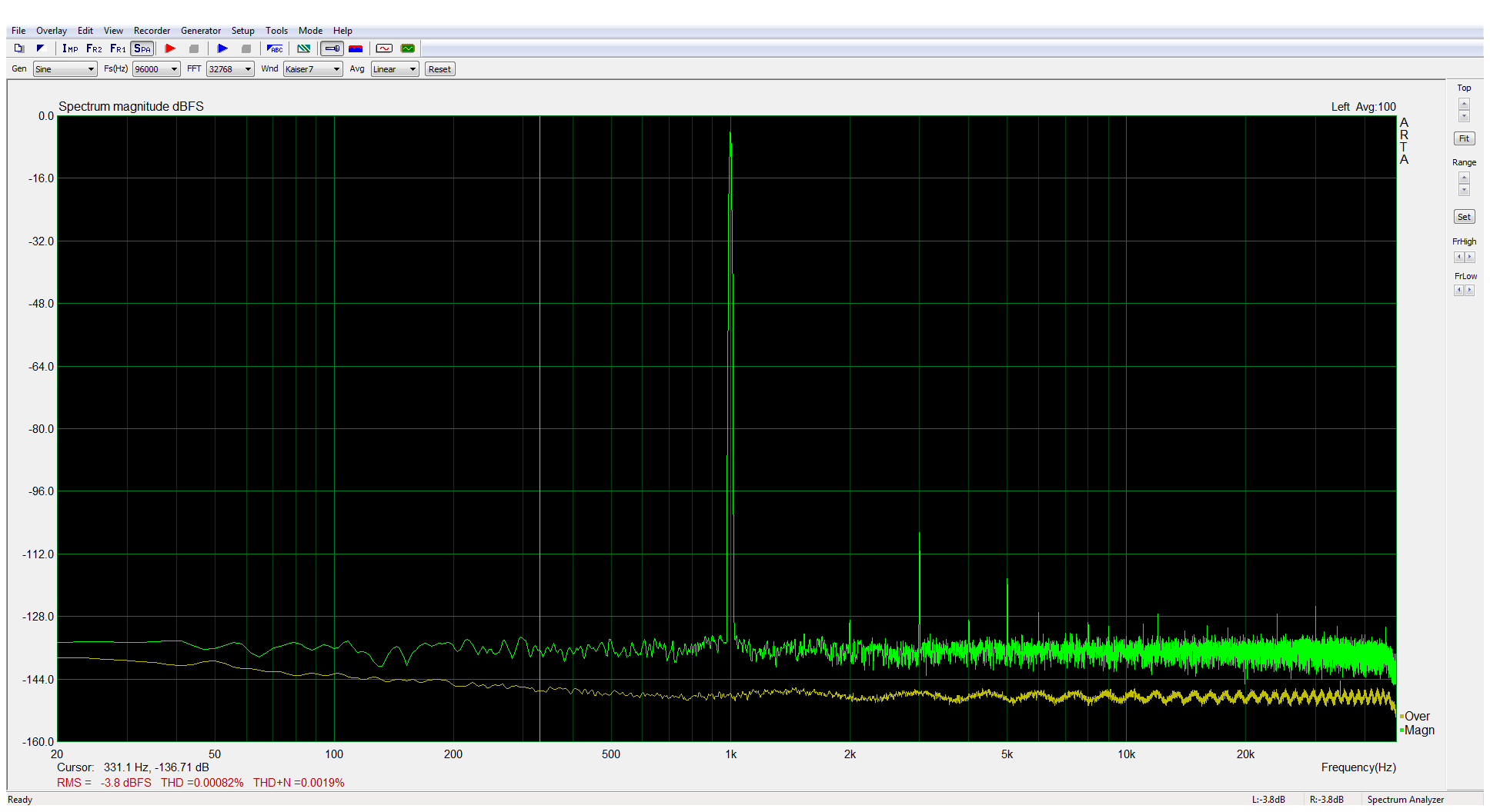

Below are the results I get with my EMU 1212 PCIe soundcard with 100 averages and without averaging (loopback cable installed and output signal muted).
When a signal is present, the noise floor is about 16db higher (yellow= without signal and 100 averages, green= with signal and 100 averages).
Still excellent results for a sound card of less then 160€…

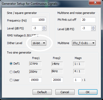

Ok, this was because dither level was only set to 16bit (insufficient for the performance of this sound card). See the difference below for 16 and 20 but dither (100 averages used)

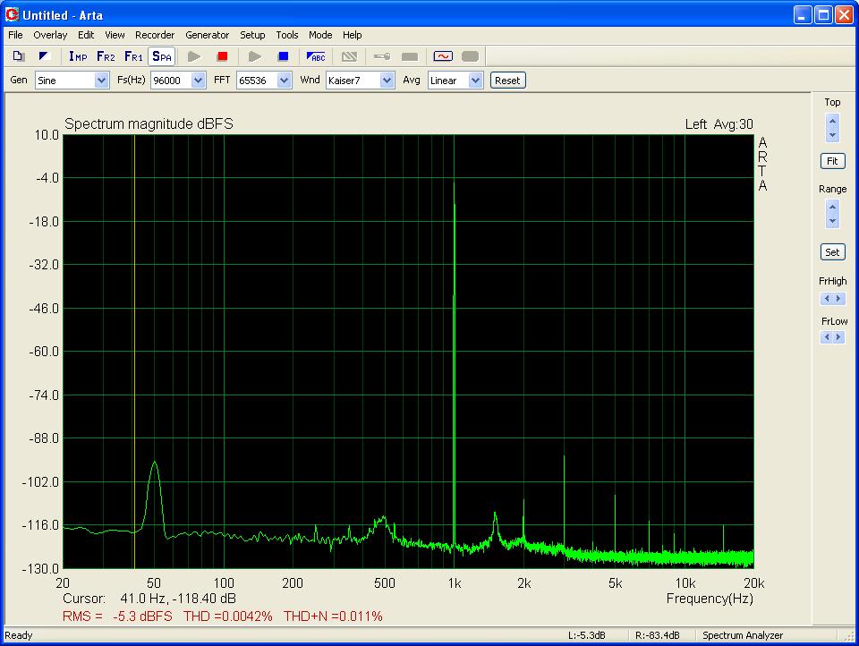

I have also built Pete Millet's interface. Attached pics shows the difference with shielding and no shielding. In my test just two metal plates, below and above the interface connected to signal ground.
Clearly the mains hum almost disappears with the shielding. My sound card has too much distortion for my liking but that's another story.

I have come to the similar conclusions in my testing. Two points to make,
1. There is a lot of radiant energy in the air. Moving the device away from the computer and anything else that is power up, make a difference. I use 2 meter balanced cables and set the box on a chair in the middle of the room. ( as a side note, I just finished up a +60 db low noise amp that is battery powered, built inside a cookie tin, I was measuring the self noise at 1.7nV/sqrt-Hz, but had power supply harmonic spikes that measured at 12nV. I made a second box out of 16 oz copper and put the amp inside the box, then inside the cookie tin; floated the copper box on nylon spacers. Using a longer 50 ohm cable to move the assembly further away from the spectrum analyzer, the power supply harmonic spikes dropped to about 2nV. My conclusion: the power supply harmonic spikes were EMI, not from power lines or other sources - same for spikes in the 40 to 50kHz region)
2. A ground wire between the computer chasis and the dut and or interface can some times help as well. Just use wire with aligator clips to try easily. Probably makes sense to secure this ground wire to the signal wire.
