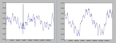

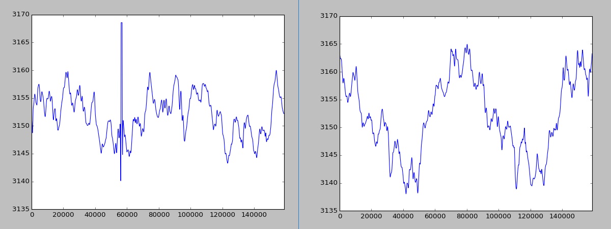

OK here it is. I placed a cheap USB microscope over my cartridge as it was playing and watching on the screen I thought of retrograde planetary motion.
So here is my idea.
1) Ream out the hole on the LP just enough to find the true center
2) Get some 1" or so thin SS washers and ream their center holes to be a tight fit to your spindle
3) Put a tiny dot on the top of your cartridge, it does not matter how well centered it is. You could image any small feature on the cart if you want and in fact no alignment here is critical
4) Imaging the dot with a USB microscope rotate the platter by hand to find the min and max point of the wobble (the groove pitch is a small error to be aware of)
5)Mark with a piece of tape on your screen the min and max point of one revolution
6) Park the LP at one or the other and taking care to move the LP along the stylus/spindle radial axis split the difference. Two iterations should be more than enough.
7) Glue the washer in place to save the alignment
Picture is one iteration simply using the play in the Dr. Feickert LP (there was not enough play to fully fix it).
