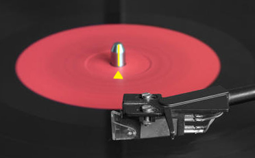

For Record eccentricity test there would be too many variables right ? Like not each and every turntable record spindle would be precise. Not All record hole would be precise, after all it is plastic. So would following method work ? see pic attached.Back on centering and serious apologies if I missed something. GZ spec 0.2mm so pending them answering the question on if they can do any better we need to consider 2 things
1. How do we measure how far out it is?
2. How we adjust.?
1) We put marking on record label as near to the spindle as possible. Shown in yellow.
2) Mark the spindle with fine marker pen. Place test record so that label mark and spindle marks align.
3) Measure locked in groove tone.
4) Rotate the record 180 degrees so that the label mark is exactly opposite.
5) measure locked in groove again.
6) whatever modulation eccentricity on the record will be 180 degrees different and can be detected in polar plots. the 'Rest' of the eccentricity will be that of turntable spindle or Bearing or motor etc. All we have to do is differentiate the two exact eccentricity 180 degrees apart 'against' another eccentricity.
Simple and workable ?
