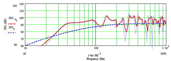

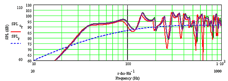

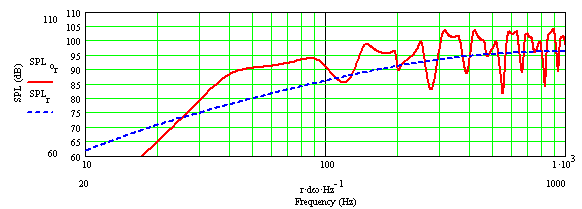

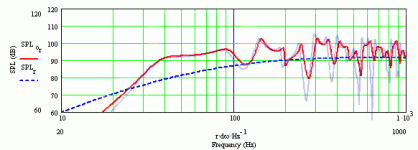

Scottmoose said:It's harder to see this time around, but the ripple in the response is once again further reduced, albeit far more slightly this time. I'd be clearer on an overlay.
The graphs are a bit misleading as well since the last 2 are plotted on a different vertical scale... here is a composite (red/green/purple in the order Scott posted).
Note that Godzilla's overlay is invalid because he did not adjust the vertical scale for the red curve to the other curves (ie he has 50 dB of amplitude data plotted in 60 dB of vertical space -- maybe more since that one dip goes below the x axis)
dave
Scottmoose said:Thanks Dave. Pity all the MathCad sheets don't use the same scale -it can cause confusion.
I believe that can be adjusted. I mailed Martin about the plots and althou i don't think he completely understood what i was asking he did send some useful info that i have been remiss in sending you. (ie you can turn the blue line off -- i was more interested in having it plot behind the red curve)
Another thing that would be nice is to have greater vertical height in the graphs... in the existing format, peaking at the bottom is somewhat visually minimized by the compact vertical scale (this i just learned when scaling the Dicks' BR curves to compare to the ML-TL curve you sent me).
dave
