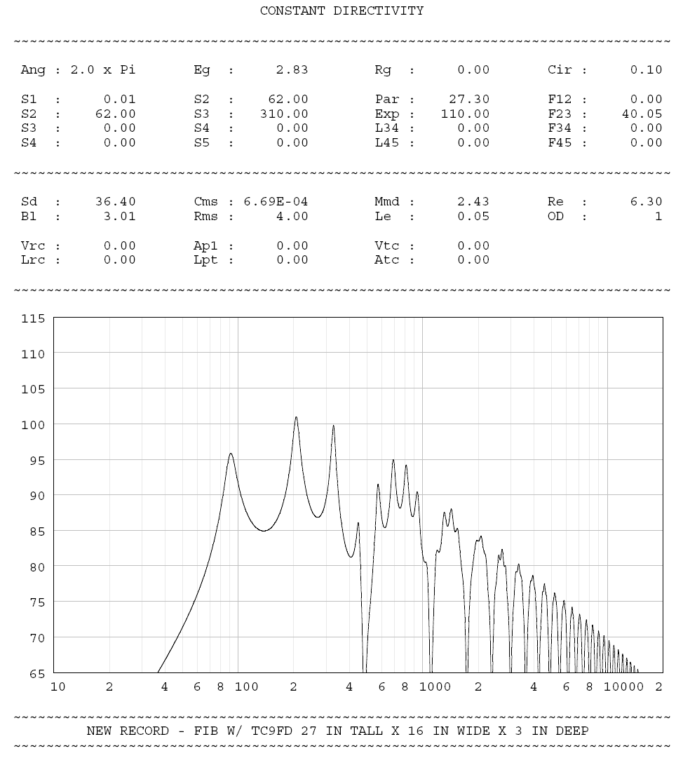

FIB Sim in HornResp
I did a quick simulation of my FIB geometry in HornResp and got something pretty ugly. Is this typical for a BIB (the characteristic sound of a BIB)? Of course the peaks will be smoothed over somewhat with stuffing but the main result is that the circa 190 to 200 Hz bump is really just one of the main horn peaks above the fundamental. I don't think any amount of stuffing will make this less than the desired fundamental (confirmed with more measurements with added stuffing which only broadened and shifted the 200 Hz bump to the left). Listening to it though, honestly, it sounds pretty good nonetheless.
Can anyone else comment on their sims of the BIB, perhaps one in MJK with proper stuffing applied?

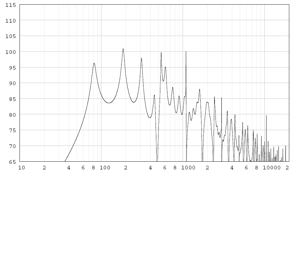

This may be the perfect thing to test a Karlson slot to see if it can reduce the second and third peaks.

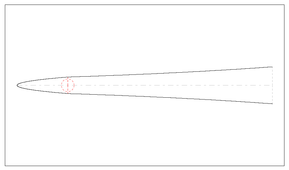

Flatter is Better Plan for Vifa TC9FD driver. What is not shown are numerous vertical braces every 2 to 3 inches, braces would be aligned parallel to direction of flow (diagonal in the corners). Probably 25 to 30 2 in wide x 4 in tall pieces of 3/16 in thick foam core braces glued with hot melt to back panel and then with PVA to front baffle. Use 90 deg square guide to ensure braces are vertical and square when fastening to back panel with hot melt glue. I would put stuffing in closed end and loosely up the 180 deg turn. Adjust to taste. I think that there may be extensive bass with this design and it may require more stuffing than usual.
For those wishing to build this out of wood. You can still use plywood (I would use 1/4 in thick to keep it light so it can be hung on wall). Use the foam core just for the internal diagonal as it is easy to curve by scoring lines on the concave side.

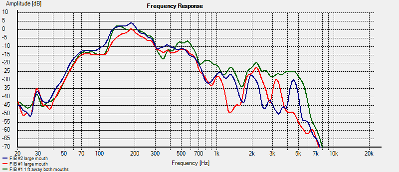

Update FIB Freq Response
Here are the latest results with more stuffing added. There are some differences between the two in the higher frequencies, may just be contamination from driver direct source, or it could be due to differences in the bracing and variability in stuffing. The 190 to 205 Hz peak has now broadened and shifted to the left. I am not sure what to do about it at this point - at least the two channels are somewhat balanced. I am open to suggestions as to how to fix.
Measurements were made 2 in away from mouth of large horn with speaker flat on floor (red and blue lines). Green line is 12 in away between large and small horn. 1/7th octave smoothing.

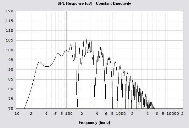

Does this look closer to a BIB? Horn output only.
T.C.'s original RS 40-1354 BIB, 2pi horn only:
GM
What with no 1pi loading and no experience with the BIB per se [mine were all vent loaded and used a completely different design routine], much less a mid wall mounted one, no clue except to fiddle with stuffing and/or some sort of EQ.
Bottom line, a wall mounted one probably needs its own design routine.
