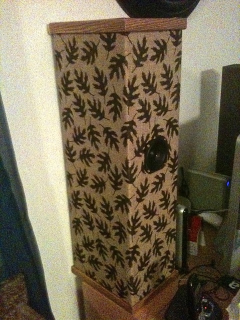

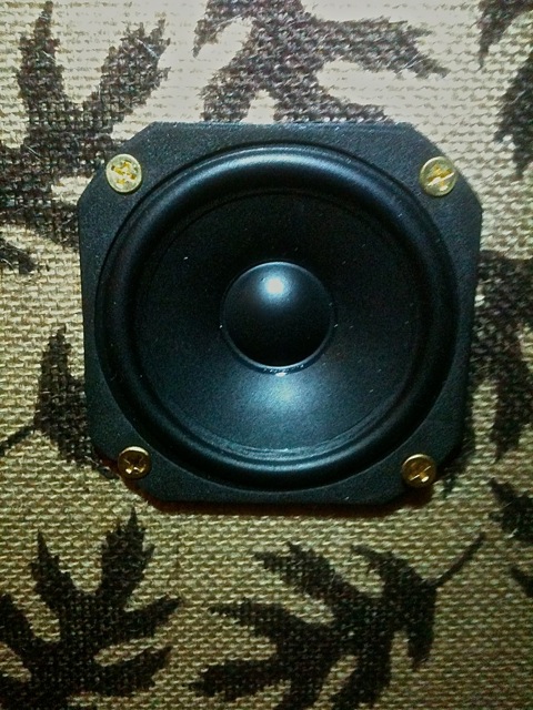

Here is the BIB I made recently. Sound really good firing up.
In another forum, I saw speakers wrapped in cloth. Thought that burlap would look nice. I'm not to pleased with the trim. Had to use fake oak trim as Home Depot did not have real wood trim in outside corner pieces.
Drivers are Vifa 3 1/2 inch, 18-08.

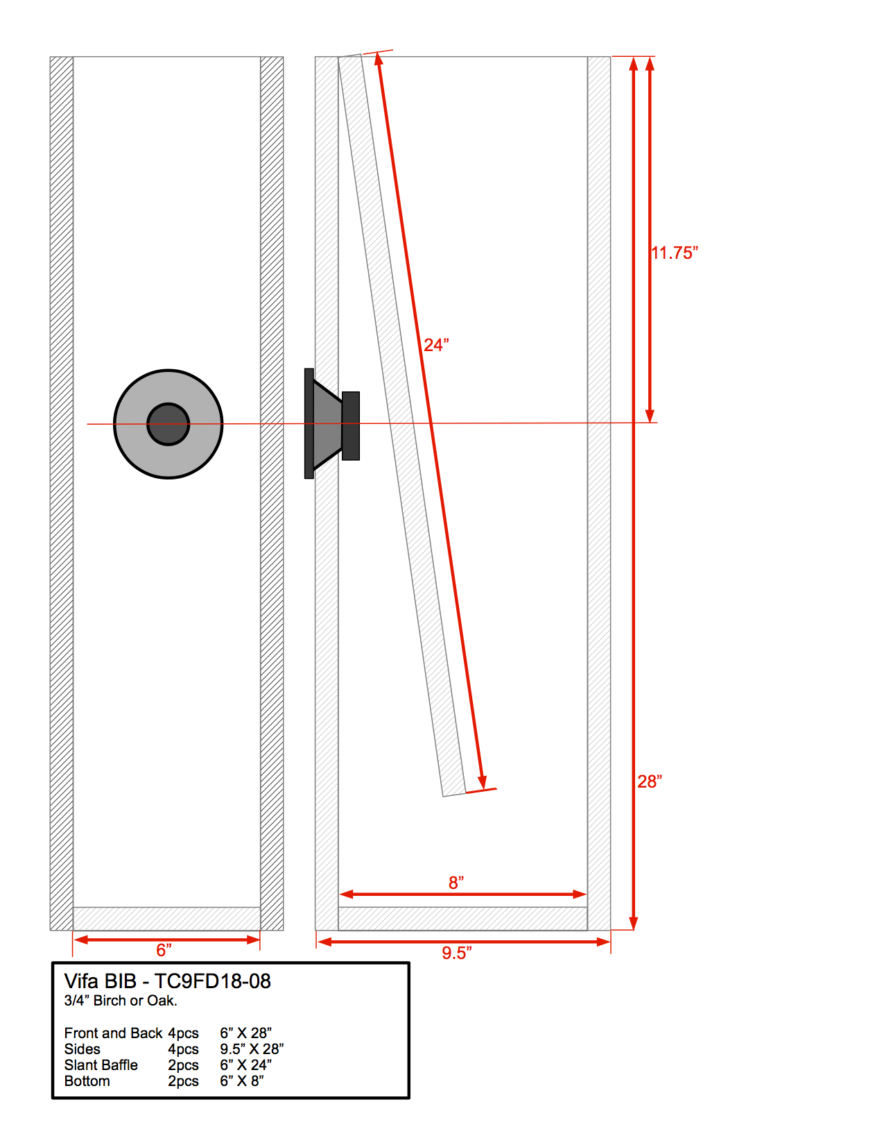

Can you provide dimensions of your BIB? That is my favorite driver. I just built a FH3 inspired horn with the Vifa and it sounds really good. I like the whole cloth cover idea. Matching with drapes or sofa is one way to get more WAF.

Here's the drawings I worked from.
I build a little different from calculator because I like to build with a side down and after the guts are in, finish with the last side on top. The plans from the calculator have the sides tucked between the baffle and the back. I like to tuck the baffle and back between the sides.

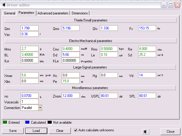

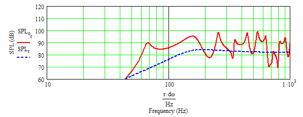

Hmm, plugged the specs into WinISD Pro to see how well they matched up.....
These suggested a ~50 Hz tuning, so plugged these into the calculator except with a 97.42 Hz Fs and it came out like this, so if you want to try again it might be OK once damped.........

GM,
Which driver are you talking about here? The FRS5? The Fs on that is like 180 Hz...
