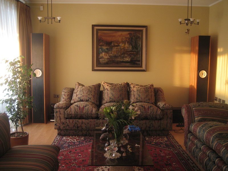

Well Scott,
I saw in a recent thread that you are still wating on A 206ES-R BIB.My drivers are at your command allthough I'm not sure how well they will work in my tiny mobile home.I've had them for A week now still trying to decide on the Fostex recomended or the Sachiko.Because I can only bring whatever I build out from the front wall maybe 2ft and my lack of skills,the BIB would be A good start.
As you can see in the picture,there is an over hang along the wall that comes out 6.75 in.81.75 from floor to the over hang.I have 83.5 in. from floor to cieling in the left and 8' in the center and 90" on the right.Total room is 13' x 24'.The other half is kitcken area.
Maybe they can be scaled down to work with the cieling hieght?Like I said,my drivers are at your command but I still now nothing about figuring out the dimentons,BSC or notch filters And will need plenty of help.
What I have for amps are A 2A3/45 and A Fisher 500C to work with.I'll do this just for you because I now how bad you want them built
Doug

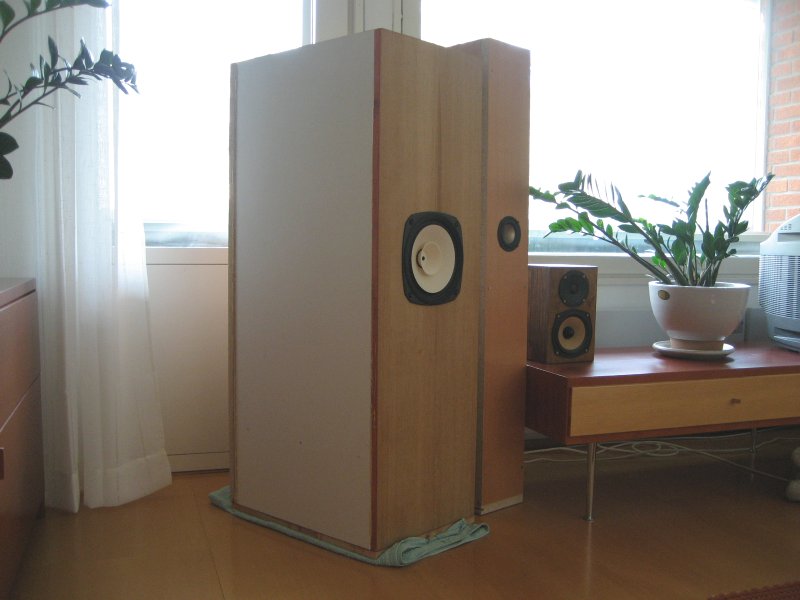

'Lo there
I've been reading this thread back and forth and decided to give BiBs a try.
I made one pair with Hi-vi B3n (WxDxH 120x190x1170mm) The soundstage that they create is... well Big, bigger than you would expect from 3inchers. With 3mm Xmax they fill 4,5m x 7m room with solid, non booming bass. On the downside, B3n can't play highs very well, the sound is kind of metallic.
My next proto is based on my preciouss FE206, but what comes for the dimension, I changed the line lenght similar to B3n BiB. Dimension are 310x470x1100mm. In other words I didn't tune it 1octave lower than I did with B3ns. But it still works, it works really well. Even though I built only one piece, it rocks the house.
So, now we get to my question. What you guys think about, a BiB for FE206 with WxDxH of 280x515x1103? The width depth ratio is some what the same as in my previous proto and the line lenght 220cm is based purely on driver Fs. Over 2m tall BiB is not that attractive...
Here's a pic of my "beauties"

tpakkanen said:So, now we get to my question. What you guys think about, a BiB for FE206 with WxDxH of 280x515x1103? The width depth ratio is some what the same as in my previous proto and the line lenght 220cm is based purely on driver Fs. Over 2m tall BiB is not that attractive...QUOTE]
Rather misses the point. The BIB is a 1/2 wavelength tuned cabinet, not 1/4 wave tuned. You'll sacrifice most of the LF potential, and if you don't invert them, you won't be coupling to the room all that effectively so distortion will increase. If you don't want to go full-sized, then I'd use Terry's old 70in tall cabinet height, which is a good general compromise & will give useable performance down to 30Hz.
Can't say I find the height that unattractive myself -here's a nice example with 206s someone posted on the thread a year or so back:
