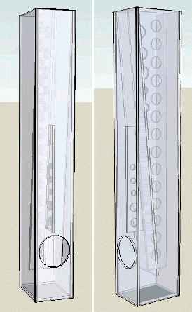

Hi, thanks for all replies and comments. Ghpicard, no confusion caused, I had just realised my materials were probably a bit on the skinny side and was wondering what would be the most advantageous way to increase their thickness without replacing them.
Now let me see if I understand the posts correctly. Leaving aside GM's elegant solution involving open celled foam to line interior and tune BW to room response which would be beyond my current level of experience, is what I'm after basically a rigid pipe with a lossy internal baffle and possibly base, with bracing for the mouth?. On the standard 168es BIB would bracing be nescessary at the mouth and is it OK to be internal as in two pieces of dowel spanning both pairs of sides, which I would prefer as it is not visible(any issues re terminus area and/or reflections?) or outside the BIB which is probably better because it avoids any above issues but would be an eyesore? Regards, Andrew

Greets!
You're welcome!
Hmm, I didn't mention the side walls as I figured the diagonal internal baffle would be sufficient, at least I didn't add any to the few large pipe horns I did except in the mouth area. In these areas a nominally parallel brace would actually be on the diagonal due to the taper, right?
WRT the internal baffle itself, my cabs were wide/flat, so even with 3/4" no-void marine grade plywood it needed bracing and for lack of thought/education beyond not wanting to add undue turbulence in the horn's passband (as opposed to its TL BW where the WLs were somewhat > in size WRT the horn's CSA) I used a parallel brace on the front and rear, each off-set at a 1:1.4 acoustic ratio popular back then.
Anyway, in theory, opposing diagonal braces on the internal baffle and its 'parallel' wall would help decay the pipe's upper harmonics, so maybe these should be standard pieces regardless of whether it needs extra bracing or not.
Any experimenters willing to 'tackle' this one?
GM

If I understand you , you are suggesting that the cabinet be "cut in half on the vertical axis with a divider/brace?
Would this be an opportunity to try my idea of tuning each side a little differently to "average out" the big dips?
Anyone able to play with this? What would shift the dips? a different sized chamber above the driver? a longer chamber? make the divider brace offset from the center? Maybe someone with the worksheets could do some computer simulation?

As far as I understand, the bracing would be affixing > 1.5" ply (i.e.) strips like if they were internal fins, so no "double paralleled horn" effect.
Now, as I only got 15 mm pine ply (that seems not have been seasoned at all and is warping more and more by the hour ) for the sides I am thinking in placing one or two of this "fins" on each side, keeping the ratio of distance in the terminus and the lower portion.
i.e. if I have at the bend:
internal baffle + 1/3 * (depth/2) + fin + 1/3 * (depth/2) + fin + 1/3 * (depth/2) + back baffle
I would have at the terminus:
front baffle + 1/3 depth + fin + 1/3 depth + fin + 1/3 depth + back baffle
The 1/3 depth separation is arbitrary and only as an example. The real one should be some uneven ratio.
Also, as GM said, perhaps parallel to the back and of different length depending on the distance to the back (to avoid much disturbance to the baffle) is a better idea.
Gastón
