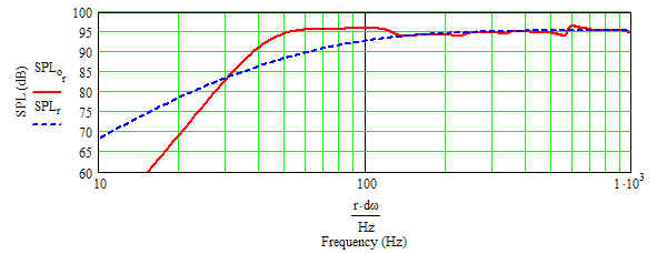

Re: Re: scottmoose, godzilla and GM
1. Are these dimensions and the associated plot are for the Hemp FR8?
2. Are these internal dimensions?
3. "CSA" = cross sectional area?
4. Is Zdriver is distance down from top of baffle?
5. Is zport is distance down from top of baffle?
I guess that's it. Cheers in advance for the help.

Just a couple of questions/clarifications for GM and Scott:GM said:[
L = 57.5"
CSA = ~113"^2 (recommend 13.5" W x 8.375" D)
zdriver = 20.875"
zport = 45"
port = 4" dia. x 0.75"
density = 0.2 lbs/ft^3 down to the port
If 'boomy' in-room, either more damping and/or a longer vent can be used to roll it off.
GM [/B]

GM,
Thank you for the reply. What is the difference between the FR8 and the FR8C? Is the FR8 a non-starter in this box? I just acquired a pair of Hemp Acoustics that don't have documentation except is says FR8 on the pole piece. Also a manufacturing date of late-ish 2005.
To expand the question... if it's an 'old' FR8, somebody please push me off the fence:

The FR8 specs I have are labeled HempTone from 4-2006 and the only difference is the Sd, Vas spec, so BL is different, but the sim in the FR8C's MLTL is ~identical, so should be fine if both's published specs are reasonably accurate. Even though Vas is smaller, the BIB is still going to be around 21 ft^3.
Hemptone...
is not Hemp Acoustics.
There always seems to be some confusion. If it has a cannabis leaf on the sticker, then it is a Hemp Acoustics, if a flexing arm then a Tone Tubby ASFAIK. Also the Hemp Acoustics have a cast basket, whilst the Tone Tubbys have a stamped steel one.
Vas of 83 litres for the TT, 95.5 for the FR8c, and 99 litres (if I remember correctly) for the "original" Hemp Acoustics.
And that could be part of the story about various designs (although I'm sure scottmoose would know what he's modelling, and GM too...)

So HempTone is Tone Tubby? I admit I'm thoroughly confused with all that's been published. Anyway, the Vas I used for the FR8 was 88 L Vs the FR8C's 95.5 L.
I also have some HempTone FR8 V2 specs with a 40 Hz Fs, 88 L Vas that require a much larger Vb, so where does it fit in which company's time line?
