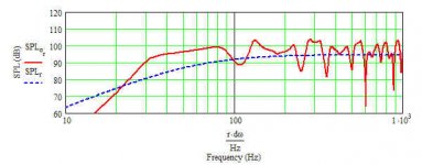

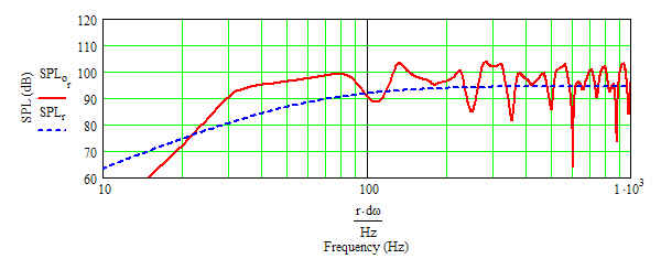

Hi
here is an example that claims to do both, the site is german and no plans are shown, but it looks very much like a BIB.
He writes that he uses two Helmholzresonators to flatten the response. One Helmholtzresonator to fill the dip around 150 Hz (I guess that's the one we see at the horn mouth), and a Helmholtzabsorber tuned to take away a peak around 250 Hz.
click
I didn't investigate any further, but to me it seems possible. If I remember correctly there was a hybrid Horn/BR design from Fostex that also pushed the bass output successfully?!?
best, LC
click
best, LC
But in each case the filter is actually removing part of the energy being radiated ny the back of the driver. At the frequency of the dip the fiter would remove backwave energy that is out of phase, at the frequwncy of the peak it is removing in phase energy.
Keep in mind that when looking at a FR chart, you are seeing front & rear radiation. Ripple is caused by backwave phase changing with frequency and cycling thru reforcement & cancellation of the front wave. The helmholtz filters are only affecting the backwave. To flatten overall FR you remove selected frequencies from the backwave.
dave
