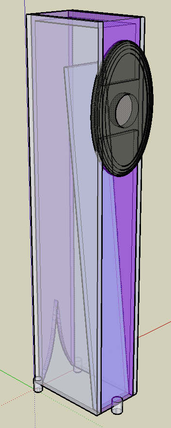

baffled?
Thanks guys for that info in the baffle dimns.
My decisions as to where to go next are a little complicated...
Partly it boils down to convenience too. I don't know anyone with a lathe near-by and so I will have to go to a carpenters shop and pay a tooling fee for getting the baffle turned, but I do have some oak that would do it.
I have made the sides from birch ply (which cost a packet) and managed to get those from one 8'x4' sheet. If I went for the front solid wood option, I can order it where I picked up my plywood from. They even offered to put the hole in it for me...The overall cost is about the same as ordering another sheet of ply, just to do the front section (8.75" wide x2) and the rest is waste (for a future project.)
If you have a choice out of a solid ash front or a plywood front with the external baffle, that costs a little extra money, which would you choose???
But it is the sound that really matters. Being my first build I am reluctant to deviate too much from all the great info that has been offered here.
What is the consensus on the solid wood front as a full length baffle? I could make it 1" and route the edges at 45 degress. Would the round baffle be worth the extra...

Any hardwood suitable for speaker building will be rigid enough that I doubt you could hear any difference between it and void free Baltic Birch or Apple and some marine grades of ply. Any other ply grade may sound different due to voids or poorly plugged voids.
As to which hardwoods are acceptable, the consensus (including TC's input) on the old Fullrangers forum was that any with low moisture retention properties such as white or red oak, white, black or green ash, teak, hard mahogany, french walnut and hard maple. Then for those with machining capability or more patience than folks like me, Lignum Vitae, Kingwood, Cocobolo, Tulipwood, Pau Ferro, Honduras Rosewood, Goncalo Alves, Bubinga, Wenge, and Purpleheart.
The supra baffle is for lowering the baffle step frequency low enough that you don't notice an audible dip between the driver's beaming output and the cab's and room's combined gain BW down low. If required, then how big it is depends on several variables, so making the baffle out of a different material isn't going to change whether or not one is needed.

I'm not GM, but as he's not at the time of typing on the forum, I'll do my best to explain it as simply as possible & Greg can correct / add to it.
Baffle-step is the point at which bass begins to drop away due to the speaker starting to behave in an omni-directional fashion and less energy is being directed forward. (technically the transitional point between 2 pi hemispherical radiation and 4 pi spherical radiation. Wince.) The loss is typically 6db below this point of baffle-step diffraction. Now, the point at which this occurs depends on the width of the baffle to which the driveunit is attached. The narrower the baffle, the higher in frequency the baffle-step point, the wider, the lower the baffle-step point. The F3 point (-3db ) occurs at approximately 11,600 / baffle width in cm (or if you prefer Imperial, 4566 / baffle width in inches).
So, when you add a suprabaffle, as well as other possible unrelated benefits, you are in fact providing the driver with a wider baffle, and lowering the point at which baffle-step will occur. If the suprabaffle is wide enough, it will lower the baffle-step frequency to a point where the horn will supply the gain lost from baffle-step and flatten the frequency response without needing any other form of correction, from a circuit, active Eq or whatever.

Scott, I think that was a pretty good summary.
Further advantages can be achieved (at the expense of material and most significantly fabrication labour) by extending the thickness of the supra baffle to "wrap around" the sides of the enclosure and profiling with a chamfer or radius edge.
Also, shapes other than round (i.e. square, elliptical, star-burst) are worth experimenting with.

Ahhhh. I think I get the bafle step concept now! Thanks for that Scott (and Chris).
So to recap, Dmason quoted a measurement of 13" for the 168. If I take a profile (roughly a continuation of the outside edge of the driver cage/surround) and extend that curve out to meet the edges of a 13" Dia circle (1" thick), I am getting pretty close the right dimensions?

Martin Prothero said:All well and good me understanding it - now I,ve got to go into some poor unsuspecting cabinetmaker/joiners workshop and try explaining it to them!
Hi, Martin. I realize the English and we Yanks are two people separated by a common language. Woodworking is one of those places where the jargon is different.
If I were going to explain it to someone here, I'd ask them to face-turn a round blank so that it matches a convex profile like you would draw, starting with the outer dimension of your driver.
