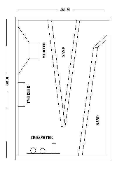

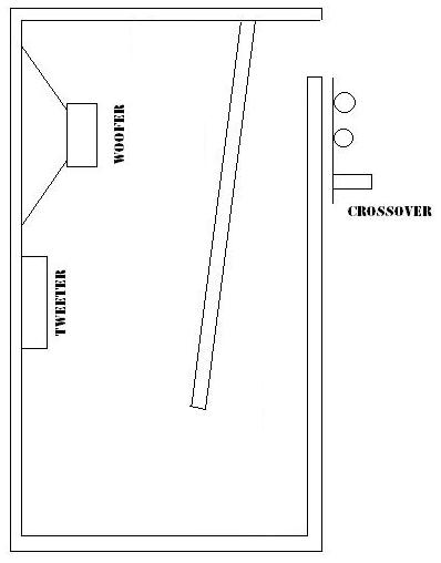

Couple of alternative layout possibilites (given the dimensions specified earlier).

They were more to tickle fwater's imagination when he's modelling your driver in a TL (I'm not sure what he's using). The driver in question does appear to need a bit of volume when in a sealed or BR enclosure.
But, with your original sizing 0.66m x 0.28m (assuming they are external dimensions) x 20cm (assuming this is an internal dimension) gives a volume of 32 litres. take away any bracing and the volume of the driver and you've probably got about 29 litres. When you look at 'unstuffed' sims, this is a sealed Qtc of 0.685 (good). And the same sized box (including a 3"dia port of 5.3" length) gives good response - if having a 2dB raised output around 75Hz (which is not necessarily a bad thing).
If that size box is OK with SWMBO, then you might very well be able to put in a TL. If the box is too small, then a TL won't have a chance to work properly and I think it starts to act like a too-small aperiodic enclosure (others will know more). Small foot print floorstanders would probably work also.

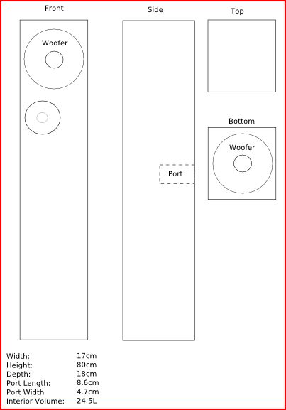

planet10 said:The Fonken Floorstander Mk 1, the Cyburgs Needle, and TABAK would all satisfy your physical limitation. The last 2 are TLs.
dave
Dave, I also say thanks for the links.
Do ya suppose the TABAK would also work with the HiVi B3N? Seems doable, but I'm still in the dark w/out Mathcad.
I was hoping to try a BIB someday, but the HiVi's high Qts and Vas made that impractical.
