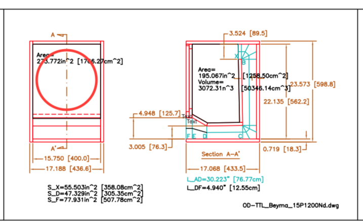

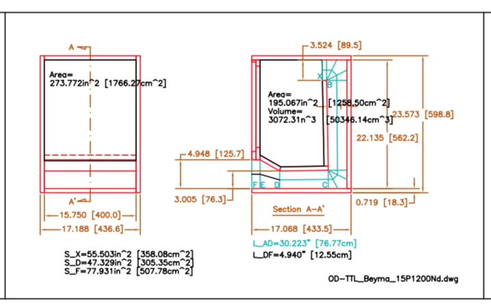

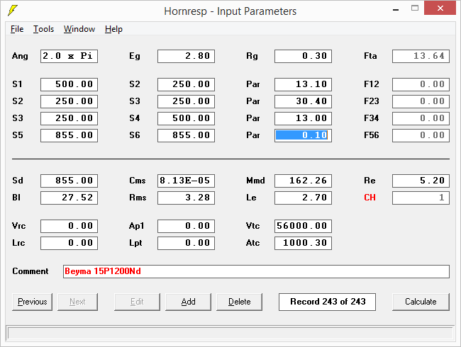

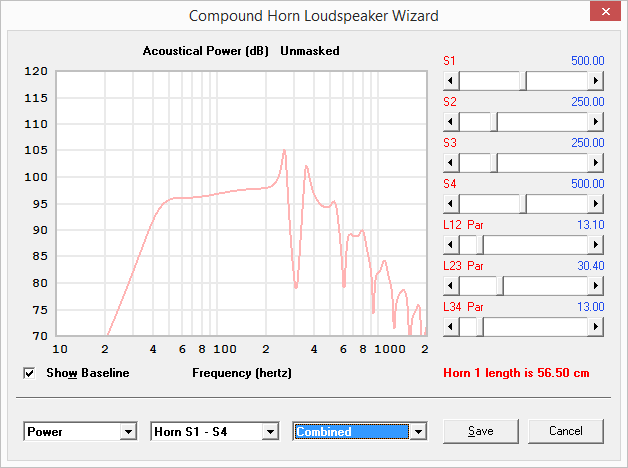

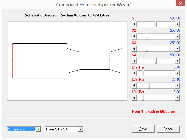

Top of "page 12" In post #111, Oliver has posted Hornresp inputs and response curves, and a link to a long and longer port drawing, the "3 panel port" pictured on the right.
Chris might link it in the OP, I went through all 15 pages earlier today and missed it, even after following the thread the first time around...

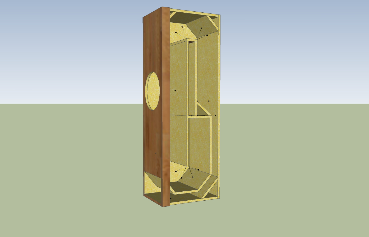

It seems a RCF LF15X401 might work well in this box. When playing in Hornresp, I came up with something similar, a long port BR of similar size. And a pair of these should fit into my car:) Is there any advantage compared to a more traditional BR layout?
Edit: I was too quick. This looks like a traditional BR actually. I have another question - if I understand it correctly, the front baffle is two layers, is that right? I need to check if the RCF will fit in, maybe with small modifications. I really like this box style.
