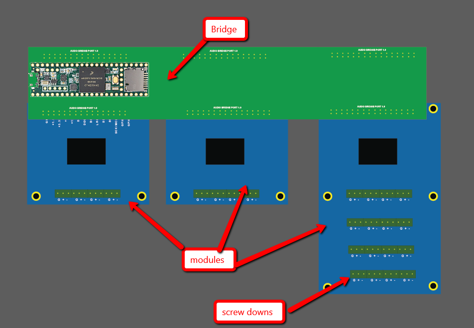

Next, I plan on integrating some even better IC's for my project but before I do I was thinking about creating some type of audio bridge for the Teensy. This would make it easier for me to modularize my project and focus on the individual components rather than a full blown board. The plan is to hopefully get some community support. I've outlined the concept on my post about my project on the teensy forum. Check it out and let me know your thoughts. I'm seeking just an overall concept confirmation and maybe some advice on what features should and shouldn't be included on it.
Here is the link to my project and some more information about this potential bridge.

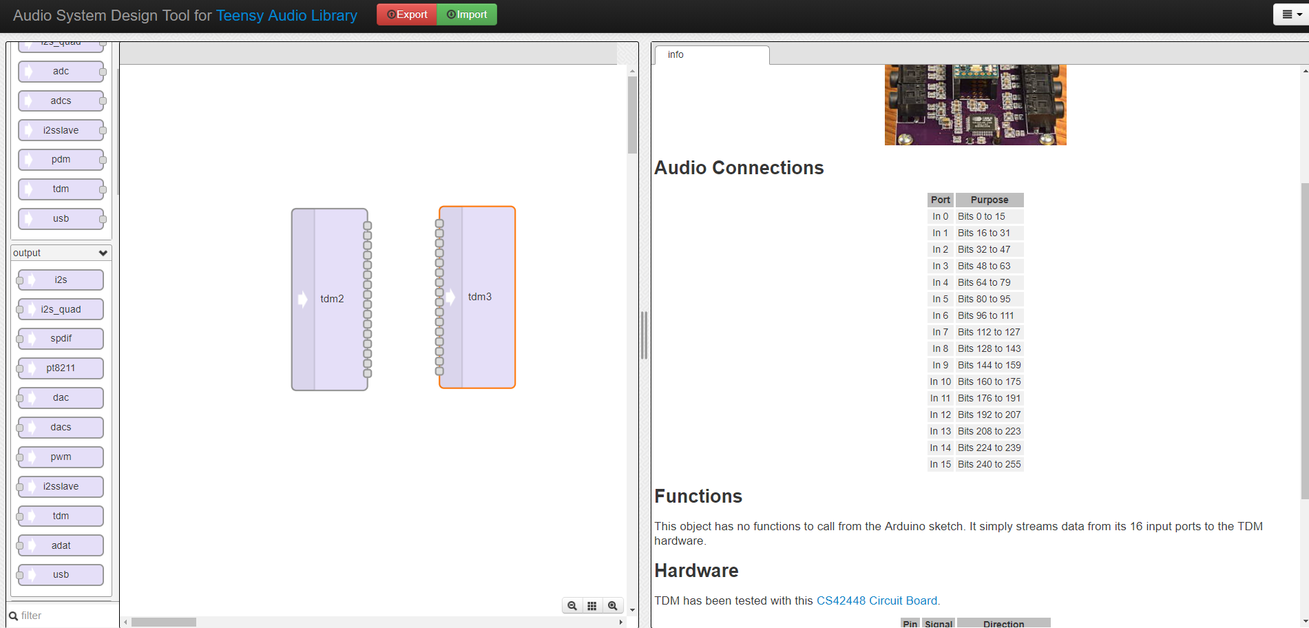

Remember 2 x I2S lines should be 8 inputs and 8 outputs using TDM right? If we had 4 I2S lines we could have 16x16, right? (EDIT: I don't know)

Teensy = Working for me so far. Going to create two modules (ADC/DAC) and see how many we can connect and make work. They have a TDM example with 16 channels on each i2S channel. Yes I think the software is coded for two I2S channels. However, I counted more when I looked at the pins....

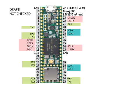

I attached a pin assignment that I'm working on. There are a bunch of TX/RX lines - am I missing something?
And TDM in the Audio Development Tool is also attached.

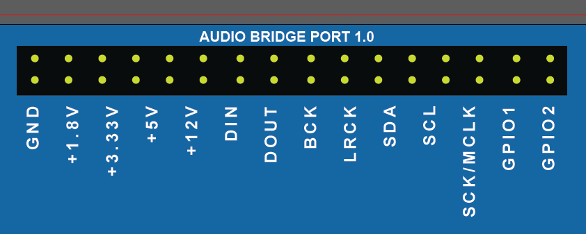

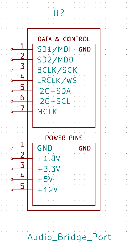

So what do you think about this audio port design? Both the modules and the bridges will have the same ports, so that they can be connected easily board-to-board.
- The footprint will be a 2.54" header that can be right angled for a board to board connection or connected with headers/pins/wire.
- The bridge will contain the Power Regulators so that all the audio ports on the bridge will have whatever power requirement it needs. 12v, 5v, 3.3v, 1.8v.
- I'm trying to decide if the modules should be daisy chainable, so that they can be used in multiples for the TDM lines, or if the bridge module should just have multiple ports for adding more than one module to a line. (I think the later)

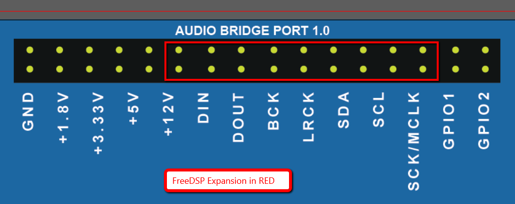

This port would be on both the modules, and the bridges. This header is similar, but a modified version of the FreeDSP expasion connector. They will allow simple connection from board to board with ether edge connectors, or with ribbons. The bridge can be designed for a variety of MCU options. My initial concept is for the Teensy, but the modules, if this port is designed fairly well, can work on any module. So I value feedback so that maybe we can get it right the first time!

I could use some help with my "Audio Port Bridge". Any advice would be greatly appreciated!
The FreeDSP Expansion Connector has a FULL ROW of GND connectors on one side, and the data/power pins on the other. Is this completely necessary? I know that if there isn't a good ground between the boards this can lead to impedance issues. Well, in modern IC chips how much ground is enough? Is this pinout extreme or necessary? Here is a mock design of the pins.

My only fear is that the TE Connectivity Header Pins are super expensive. TE Part # 1-103168-4. We might want to do Edge to Edge connectors instead and set the bridge up in a form factor that works for the modules. Any thoughts?
By the way - what size IDE Ribbon cables and header pinouts are "standard"? While I know there is no standard besides disk drives (IDE Hard Drive Cables are 40 pin) is there any number that is more common than others? 2x13, 2x16, 2x10? I can remove the GPIO pins from my design I think. I have a 12v supply to keep standard with the FreeDSP connector but I wanted to supply the 1.8, 3.3, and 5v lines because I don't want the regulators on every board.

I am not sure about the connectors full of ground. I think it is not necessary. I have seen some designs that only have 1 to 3 gnd pins only.

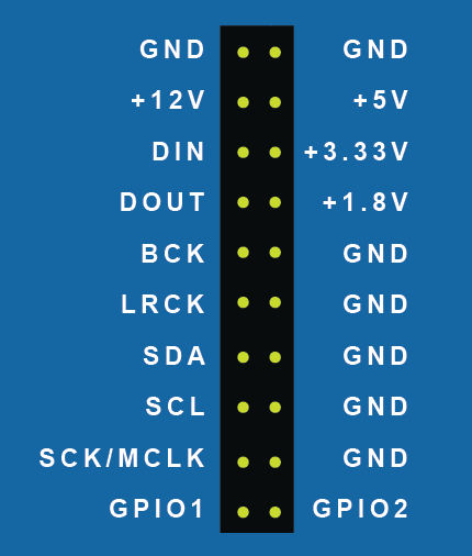

Here is a 2x10 design concept. I guess I will just settle on something at some point! I could even fit what I want in it over 2x8 and still get a bunch of ground pins. I don't know if any parts are easier to get than others.

A ground for each signal pin allows you to make impedance controlled transmission line connections between devices. Use ribbon cable with every other conductor a ground. All the ground conductors at each end of the cable should connect to the end device PCB ground plane.
Yes that's what I've read. Thank you for your input. It's just that I've seen many connectors have only 1 GND for every 5 or more pins. So I'm actively debating it. I'm also trying to figure out if there are any cost savings for having smaller headers, smaller IDC cables, etc. 2x14 is quite large! 2x10 seems a little more manageable - seems also a little closer to standard.
The bridge can connect to the modules via cable, stacking, or edge to edge. In the case of edge to edge, there is the issue of having to create a male and female versions (with rows 1 and 2 swapped so that the edge connector "inside" is connected to the reflecting "inside"). At this point in time I am leaning towards a stacking concept (seriously makes it look like a bridge too). It is the cheapest in terms of parts (See attached concept drawling), and it also allows for IDC ribbons easily too.
I'm attaching my latest schematic for the Bridge. It has a power supply, and 4 connectors. Two connectors are connected to one RX/TX line (Serial Data of the I2S), and two to the other RX/TX line. This lets you connect one ADC module and one DAC module to the same line. I might change this up a bit too next week because maximum TDM connections with 8 inputs/outputs on a module would require 4 per RX/TX line (2 8xADC and 2 8xDAC). I might only expose one RX/TX line for the initial prototype but 4 ports. This still allows a 16x16 device. But still possible to maybe have the other side available for the other RX/TX lines.
I'm brainstorming here. :)
