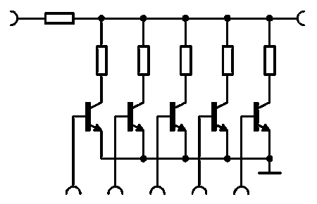

imagine using one series resistor and say 10 different resistors
to gnd - a switchable voltage divider. use bipolars between the
switched resistors and gnd. In on condition there is nil voltage
across collector emiter thus no reverse voltage
Uli

HBarske said:Uli,
not sure if I get it. Just something like this...?
BINGO
I personnally consider a device between gnd and a shunt not in
the signal path.

Okay, let's clarify this for dummies like me:
When the transistor is open, there's only VCEsat left between collector and emitter. This could be made rather low, if IB (high positive UBE I assume) is high enough. But: There's still an AC signal present. The BJT won't have problems with a negative IC?

There are 2 ways to implement such a switch, normal (emitter
connected to gnd, collector to shunt) and inverse mode (emitter
connected to shunt, collector to gnd). The difference is that in
inverse mode the CE offset voltage is in the range of 1 - 3 mV
whereas in normal mode it is about 10 - 20mV.
Because of the Uce - Ic "Kennlinie" around Zero you can use
a BJT as a switch assuming Uce is lower than Uce-sat, below
50mV or so. In our thought experiment the signal voltage across
CE should be significantly lower than that.
(P. Skritek, "Handbuch der Audio Schaltungstechnik" pp 185 ff.)
Uli

I suspect that the problem has as much to do with keeping the BJT turned off in the presence of a large signal as it does with handling the on case where the signal across the BJT is quite small. One can only reverse bias a junction so far without it breaking down. I'm guessing that this is the reason for preferring an implementation at a virtual earth point, i.e. where the signal level is always low.

Hi Ian,
in inverse mode you have to take care that in case of large signal
amplitude the base emitter diode doesnt turn on. In commercial
applications (eg Denon) the base is connected via a certain
resistor to either + or - 5 volts - just below breakdown. (eg ZTX450)
Uli

Hi Ian,
it might be that Wayne´s claim is that always at least one BJT is
turned on. In contrary to the before shown circuit it is also possible
to use not say 10 shunt resistors alternately but connect
them in series and switch the in between connections to gnd. So
there is always some attenuation present thus leading to more
headroom for the input signal of the pre.
Uli
