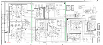

They never flashed on my original set, the speakers are rated 100w and the amp 120w they really used to pump :D this set, not so much not even close, "but"
that may be just because I am weary to push it whit the lights flashing.
You are spot on Mooly :)

Clean transient peaks should do no harm at all to a speaker, the problems come when an amplifier clips the signal... and the reasons why that causes a problem are complex as it becomes an issue when the clipped signal raises the average power seen by the speaker, not simply that it is a clipped signal.

Mainly that the overload lights flash on the speakers, not sure if it is the speakers or the amp is causing that, both about 38 years old. It could be possible the capacitors are past their best.
The overload LED flashes purely in response to applied voltage. It doesn't matter whether that comes from a faulty amp or the worlds finest... once the voltage threshold is reached the LED flashes.
If the amplifier isn't obviously distorting and showing other problems then its probably OK.
That's not to say that cap replacement on a near 40yr old item isn't worthwhile, just that it won't change the LED behaviour as such.

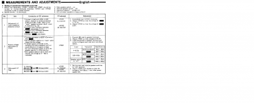

Administrator
Joined 2007
I hesitate to say yes, simply because if anything goes wrong then you could end up worse off......
The first two adjustments are unique to the amp (assume it is the Technics you mention in post #1) and tbh I've not seen anything like that on a design before.
I would want to look at the circuit diagram to see what the adjustments actually do and how they function.
The last adjustment is bias current and could be more critical than it seems because you may find it varies considerably with temperature.
Its your call on these :)
I would be happy doing all those once I had studied the circuit diagram and understood how it functions.
