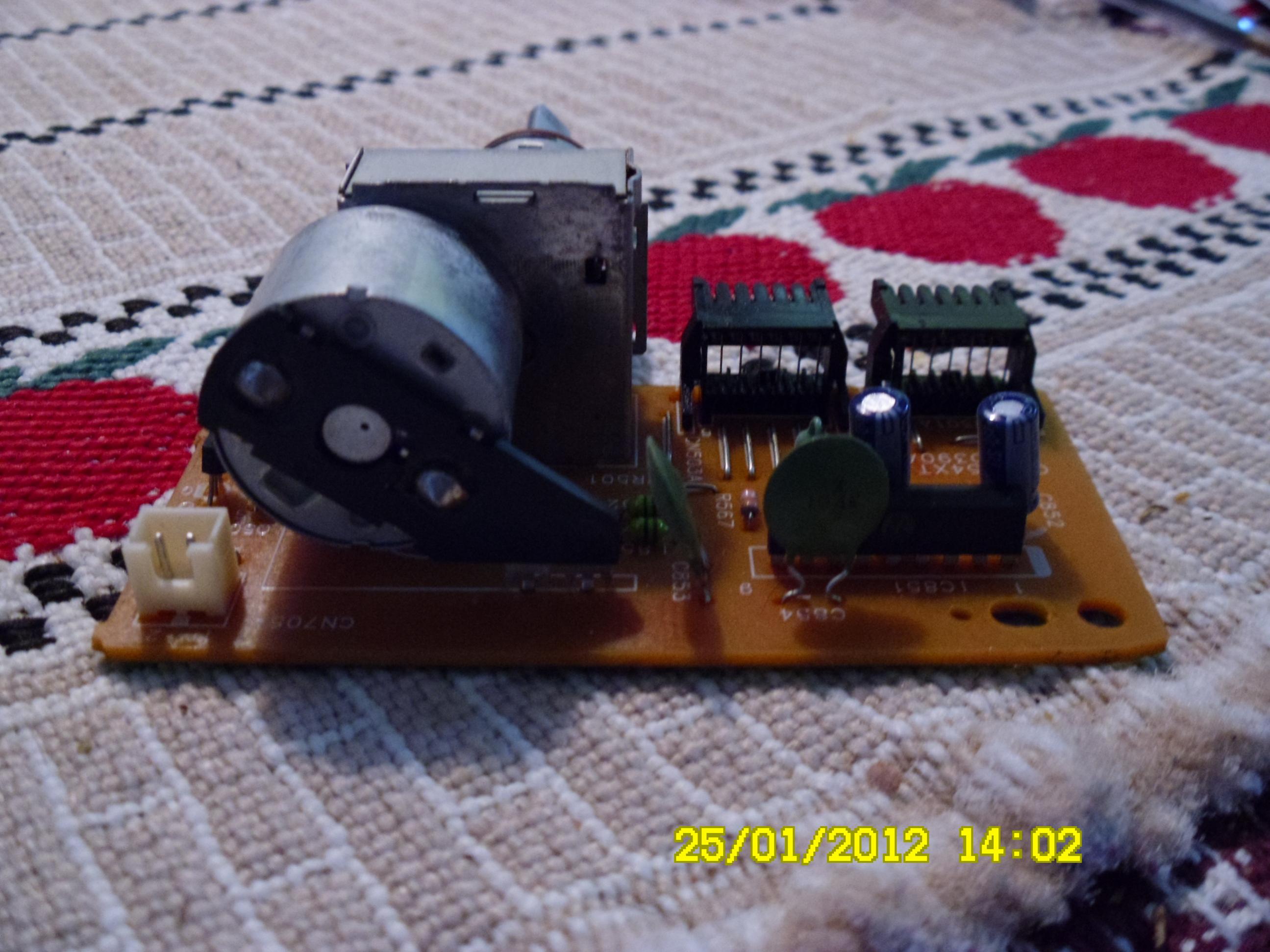

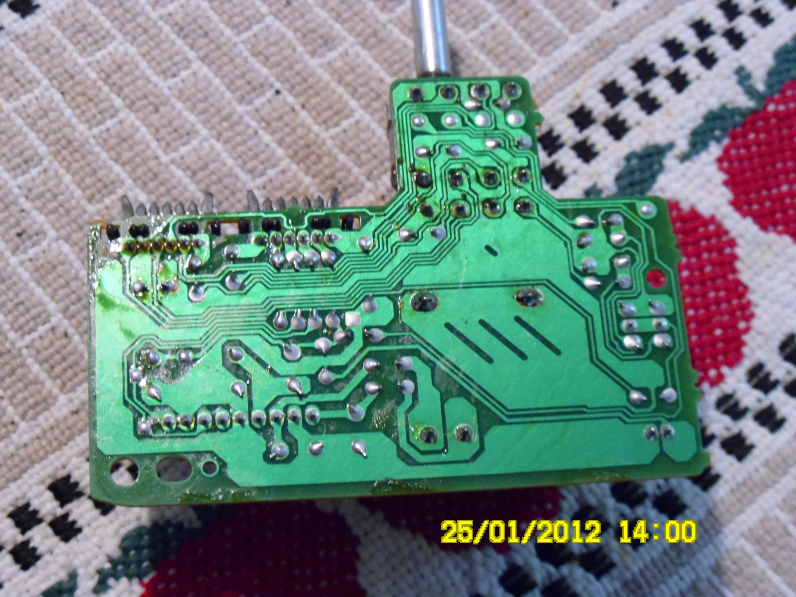

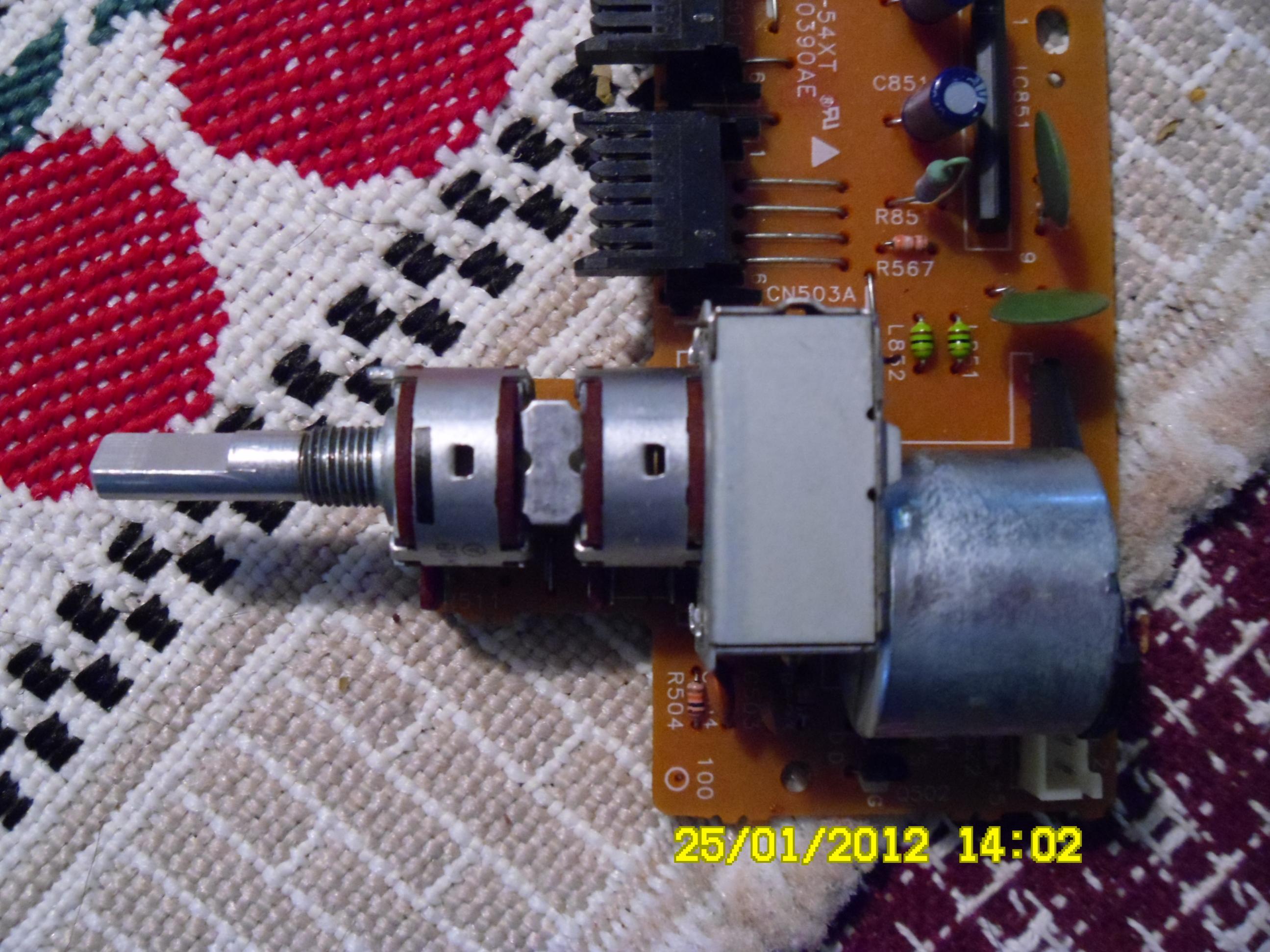

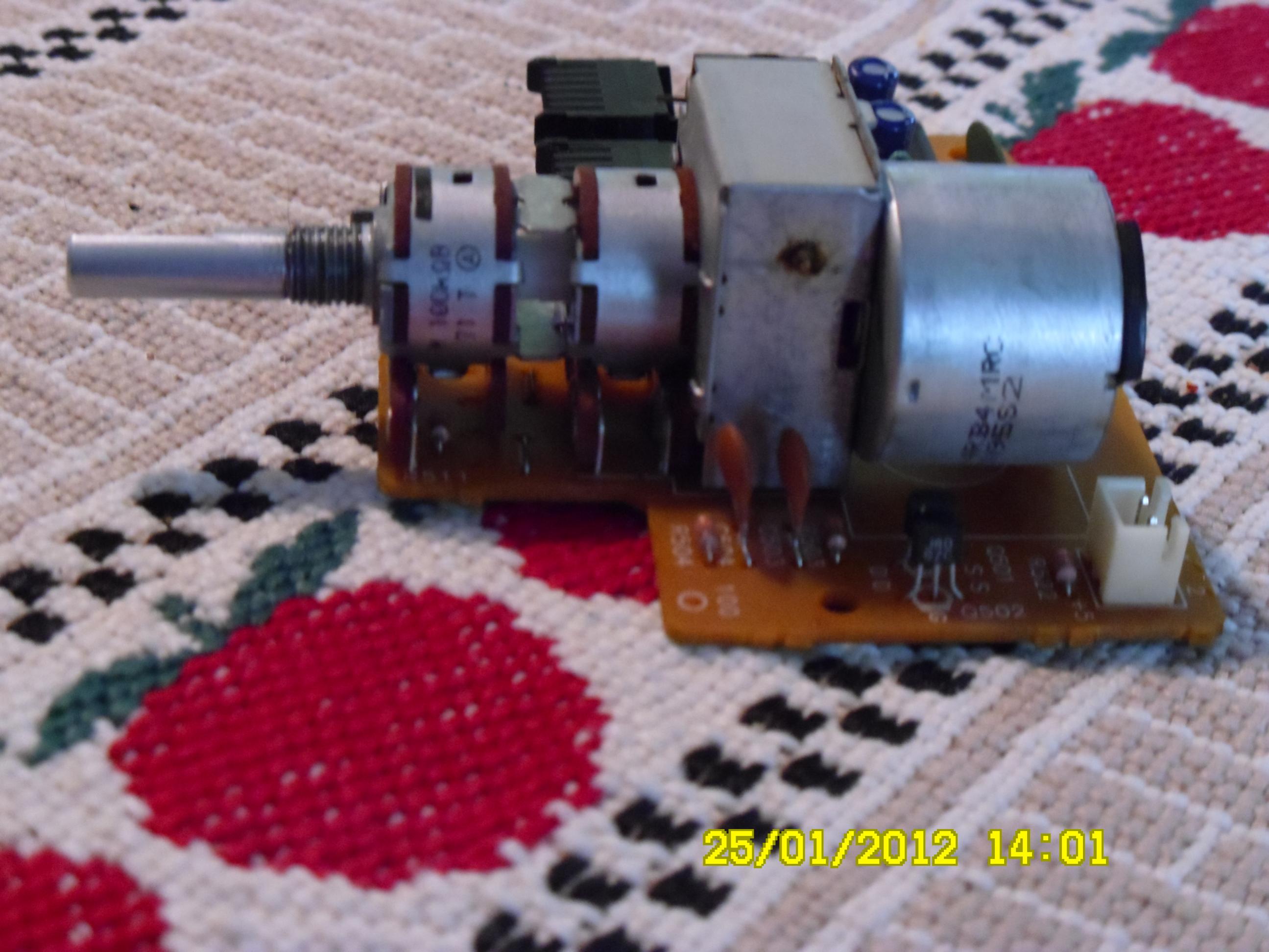

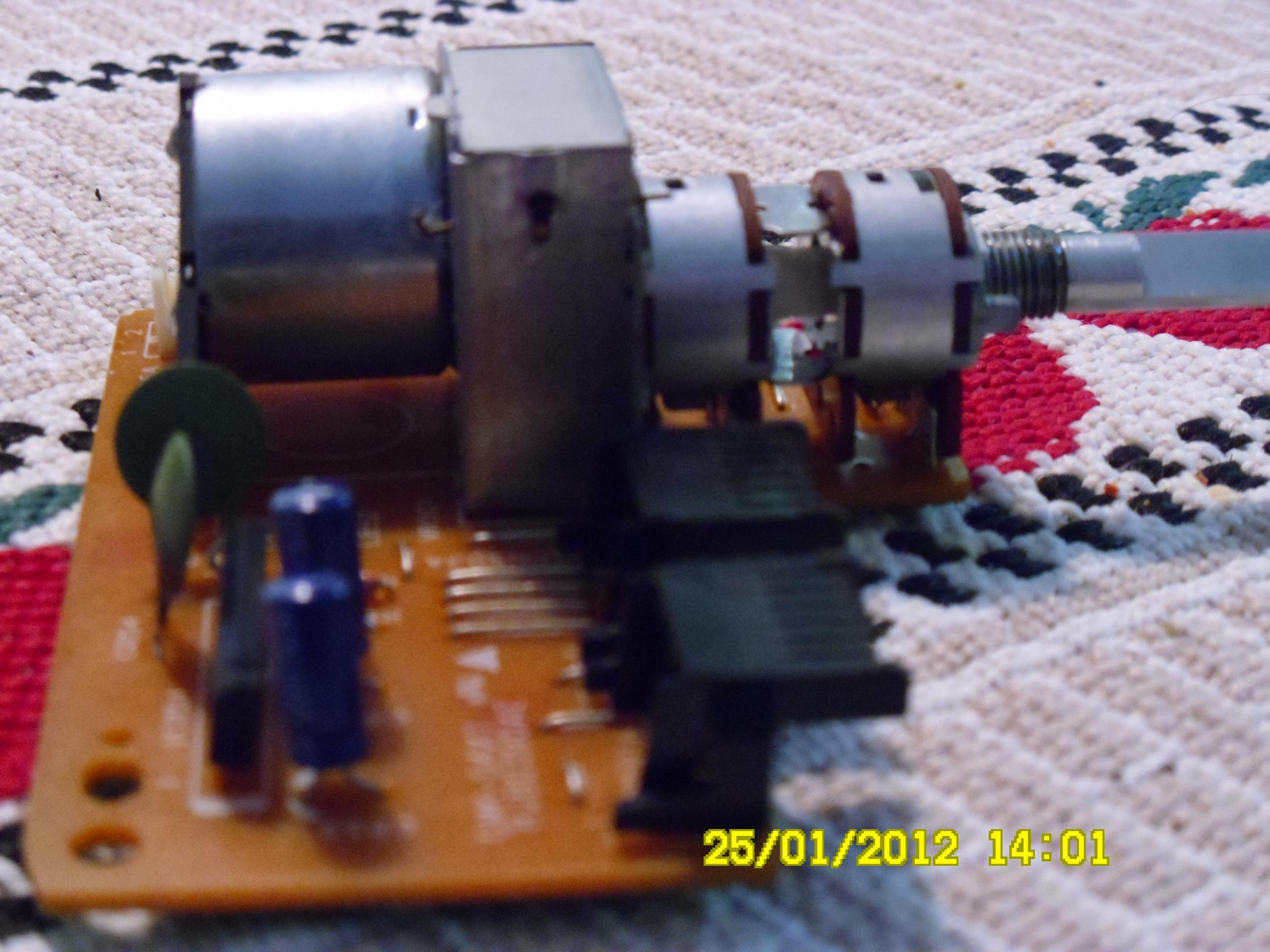

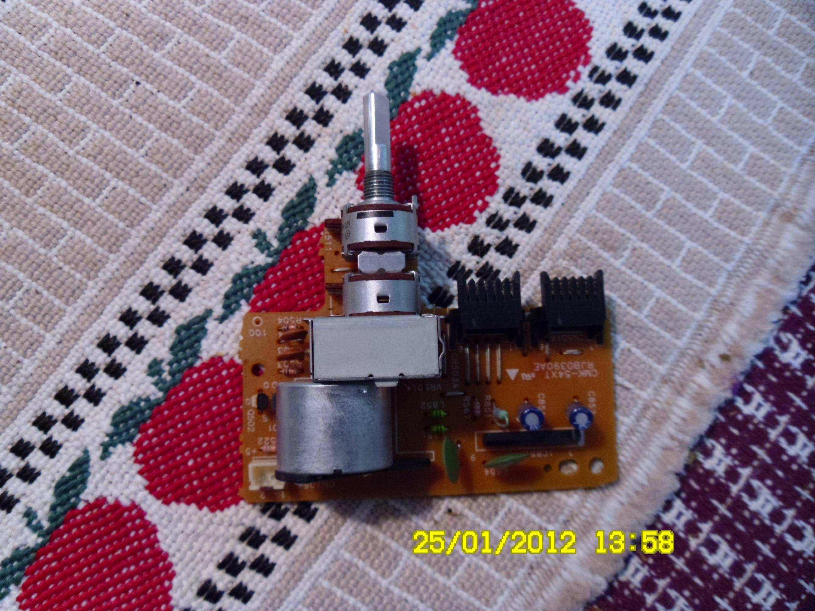

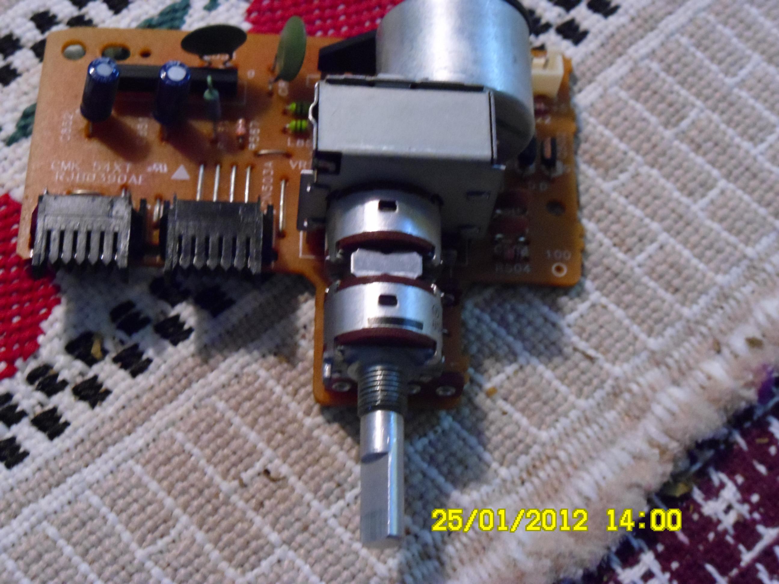

technics sa gx500 volume control
okay--now the pics are uploaded---d

I have the same receiver and my volume pot does the same thing... i know how to solder pretty well, but i don't know if i want to take the time or effort to do this if someone does find a replacement, though it would be nice to know the part. Is there any special technique for using a cleaning spray like that... or precautions?
hi--it looks like the cleaner has worked. the set operates like new. ill see if it lasts awhile and report back. i actually used cleaner and then a cleaner lubricant. both sprays from radio shack. cost $23.00. like dillrepair i did not want to use a toxic spray so i put up with it for 15yrs. good luck and crank up the volume--dan
