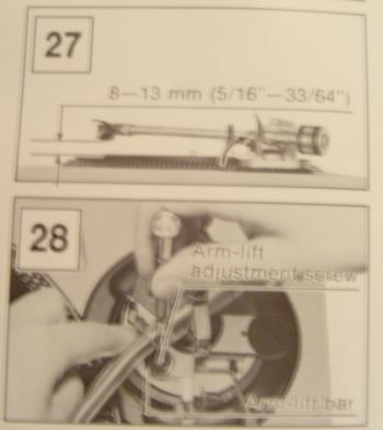

Hi Mak,
I had a look through my manual (I have the same TT) and couldn't find it mentioned. There is a feature that mutes the sound when the needle touches down or leaves the vinyl that you can adjust so it has the right timing. You could adjust that and then at least you wont get all the noise of it hitting the label.....maybe.
BTW my avatar is a photo I took of my 1600 ;)
