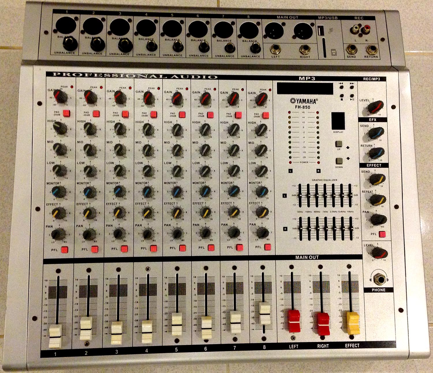

You "Yamaha" mixer has a noise rejection function (noise gate)?
Maybe this is...
No M8, it's very basic, photo attached.
I have been testing the Yamaha mixer in my home with my powered speakers, when I whisper into the mic the signal does not come through, if I hum quietly still nothing, as I hum slowly louder - the signal all of a sudden kicks in, I am not talking about extremely low volume, this issue is even noticeable in live gigs when the acoustic guitarist is picking a soft part of the song - the signal just dies!
All gain settings are set correctly.
I have confirmed this happens in all 8 channels of the mixer AND from both the power amp outs (to passive speakers) & from the line level outs (to active speakers).
Any idea's?
Thanks guys!
This could be a high frequency oscillation, and probably in a stage that is south of the main mix bus -- but probably NOT in the power amp. If it's coming out of the line outs it could damage external powered speakers. If they are bi-amped it is less likely to damage them, but it certainly won't be helping the sound. This oscillation is probably happening when it appears to be silent - cooking your crossover resistors the whole time. The presence of a signal may suppress it and then it appears to work normally.
It could be a faulty op amp - or even a design problem. Those "generic" designs may not even be tested before they go out the door. It could be as easy as swapping an op amp or putting some bypass capacitors on the board where they should have been in the first place. Without an oscilloscope and/or some knowledge of electronics this may be difficult.
Bottom line is, if this is NOT in the power amp (which can be bypassed) and is coming out the line outs, I would dump it NOW unless you have the expertise to fix it. Certainly not worth the couple hundred bucks (or equivalent) that a tech would charge - and if it's a design problem the bill will add up quickly.
