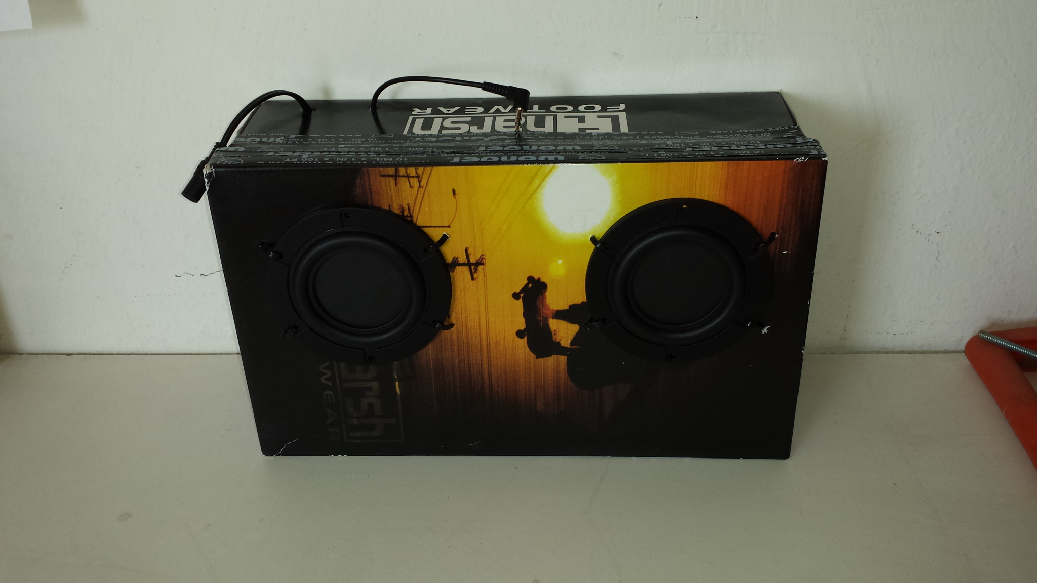

Thanks for posting your LTD tables for the four driver you have. I have been experimenting with two of these drives in a sealed test enclosure powered by a modified TPA3116 amp to see what they sound like. The shoe box is lined with foam core board for strength and the cambers are separate spaces (~0.12ft/side) and stuffed with polyfill.
Your resonant frequency result may be accurate as the drivers have very impressive bass (low) for their size in a sealed enclosure. They are fast and dynamic as well. I'm happy with the results and would like to try a TL arrangement - your numbers posted will be helpful.
I can verify that these drivers are wide dispersion, low sensitivity, and fairly smooth sounding despite the ragged response.

Thanks for your sharing. Is ~0.12ft the volume of each side?
