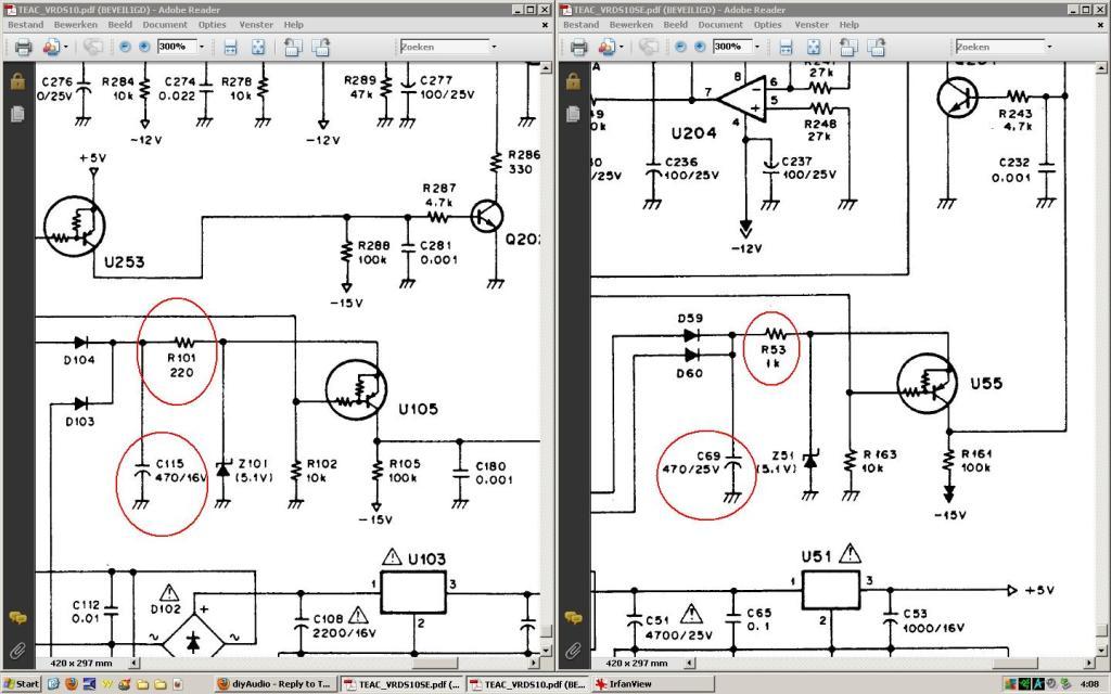

Hi all,
I recently acquired a TEAC VRDS10 as a cd transport. Though it is working, I found that on the Audio PCB, power supply area resistor R101 is broken with burnt marks on PCB. Could anyone advise the value or if possible provide me a copy of schematic?
Secondly, which tweak do you find, give the most improvement to the TEAC? A very frank clock maker advises against just changing the stock cystal osc with a 'low jitter clock' saying it is a waste of time and money if the unit is going to be used as a transport as the problem is with jitter at DAC end. Those 'clocks' were meant for cdp and not transports. For transports, the 'sychronizing' of the clocking at DAC end is far more complicated.

Maybe old tread but help on the resistor question.
THe resistor in the vrds10 has been a fault from TEAC, in the vrds10SE
The parts are very much the same but they change the resistor into higher ohms (course there was too much current running)
In vrds10 the resistor 101 is 220 ohms but you need to change it to 1K
So there is 5 times less current running and resistor gets with 220 much to hot.
I noticed it had the same with the 10 and i have a 10se too ....
I have the service manuals on ebay one guy is actually selling it on pdf
Hmm must be getting rich of it. Rip off if i may say it
So here is the solution to your teac resistor question
