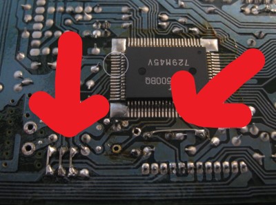

Hello Chris,
Thanks for the explanation. Since I modified the VRDS-10 servo board by copying the 4 jumper wires inserted on the cmk-4,0 servo board by Copland, aka I did the same on the VRDS-10 cmk-3,2 servoboard which is to some extent a similar design, I managed to bring down the clicks from very many, to few, and after adjusting the servos, to very few, I will look at the servo board again and see what's going on - what is happening to the signal before being sent by cable to the dacs/output pcb.
The removed components are a trimmer, a small capacitor and the old crystal, and instead a LClock XO with separate power supply is used. The long row of solder points in the bottom is the output connector to the dacs/output stage pcb mentioned.
If I can find a way to look at that data error level, I'll do it on both this modded cda-288 with vrds-10 drive and servo pcb and my standard cda-288, with it's cmk-4,0 drive and teac servo board, which may or may not (don't know yet, be a vrds-7 servo board. I happen too have a vrds-10 also, so I'll open that and compare the servo pcb's for starters.
On another note: Since I did a few adjustments last night, being in the state it is now, I noticed, that the point of adjustment on Focus Gain and Tracking Gain, made the servos just stop being noisy. They are silent now.
Your input is greatly appreciated. Thanks.
