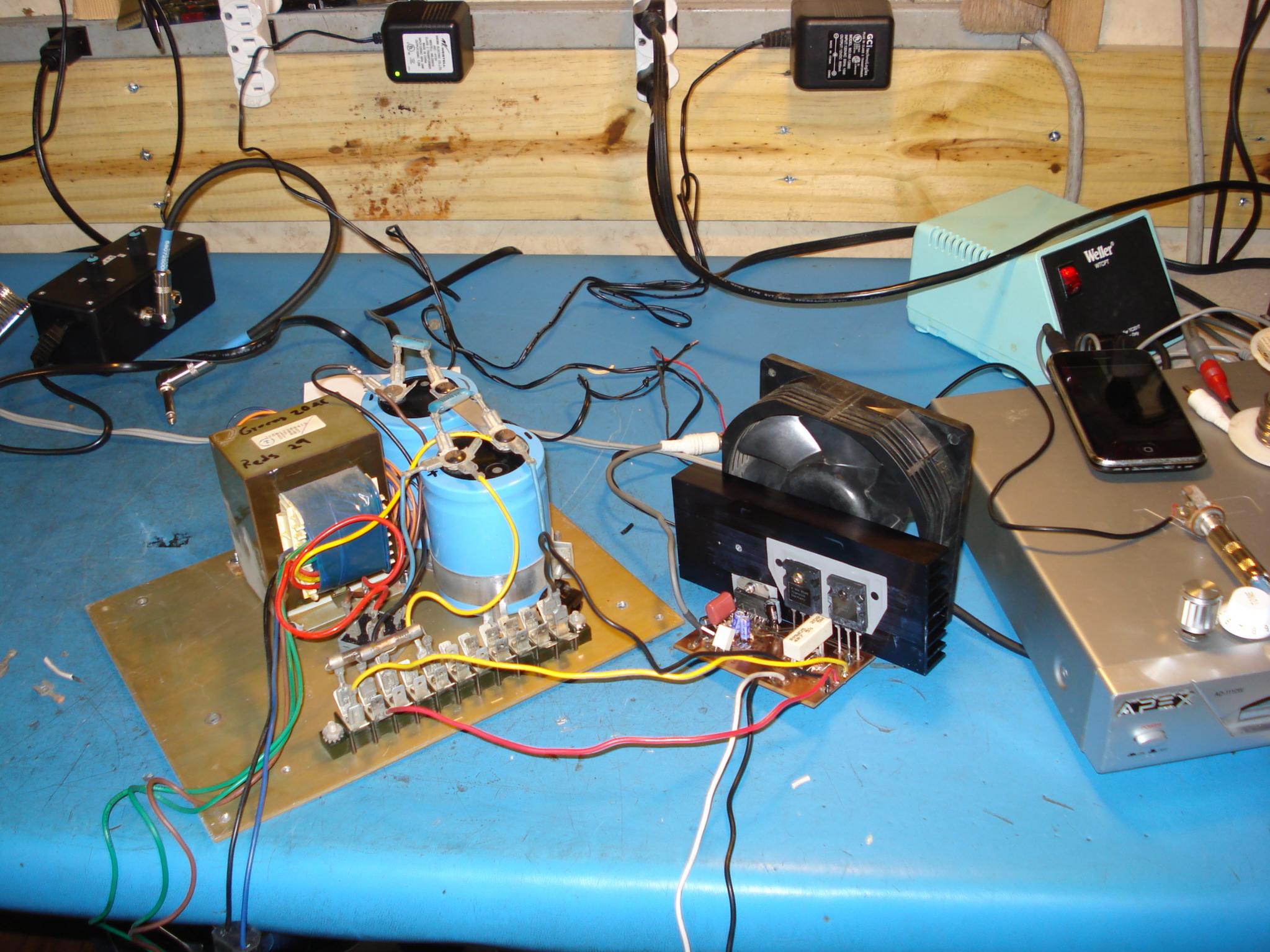

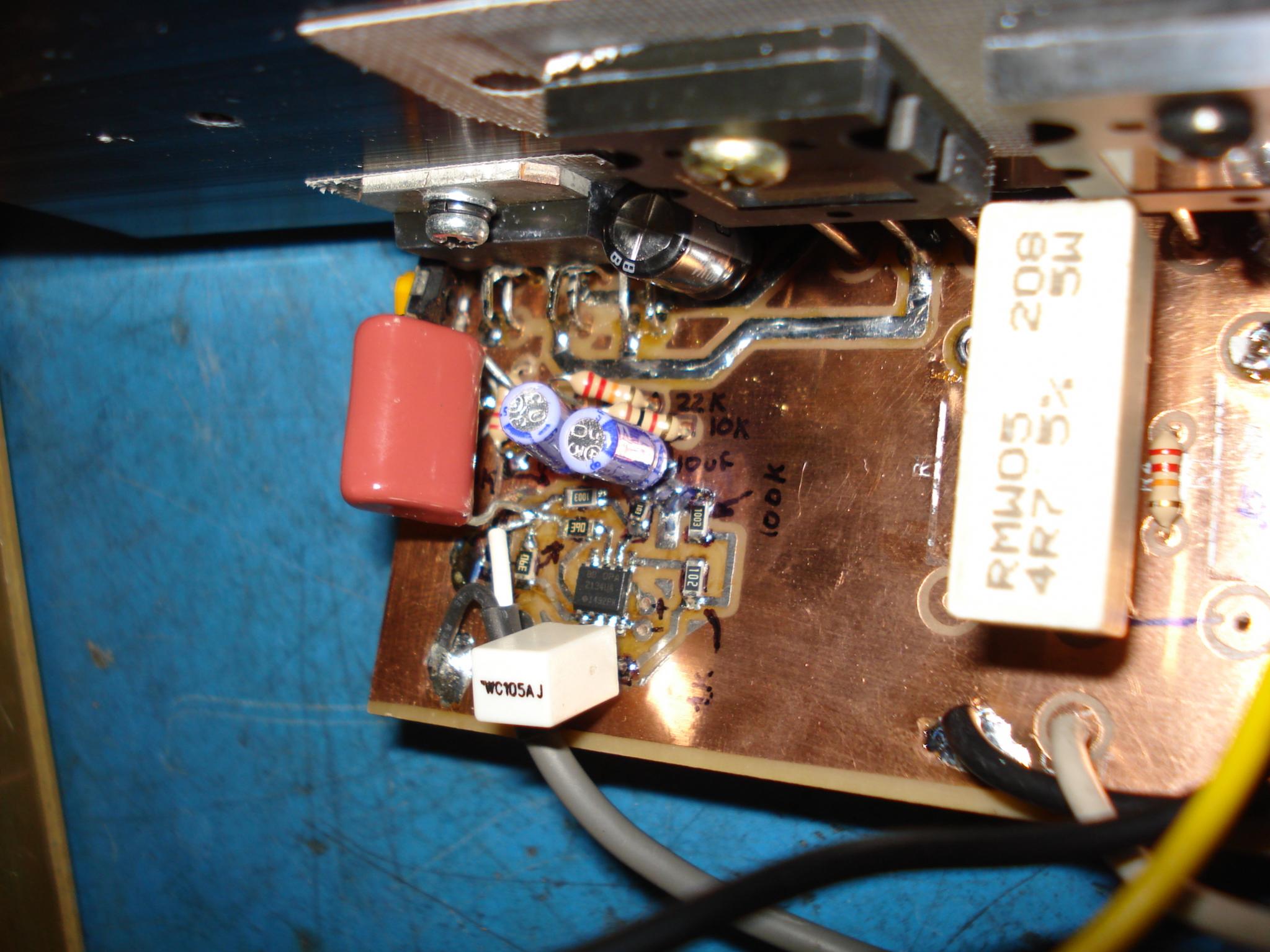

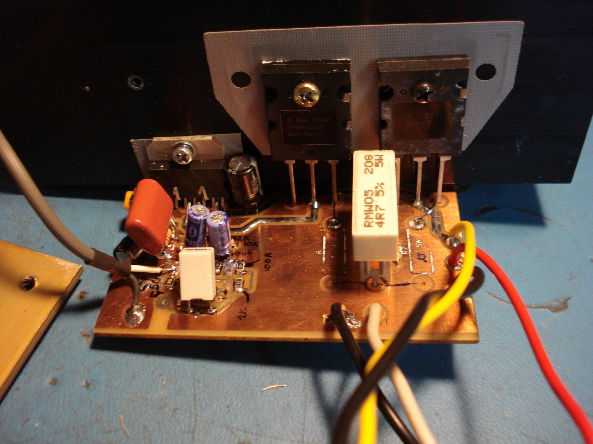

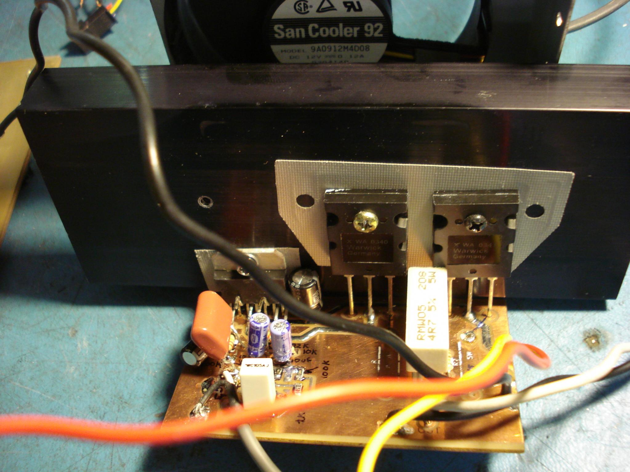

I did this audio amp and worked great!
I just discovered this page and the info of this amp with two out put transistors that I decided to make it. I did it and worked great. In has great power and quality sound! I have some pics and they are here.I did the board and I added a preamp. I have not tested the preamp just the amp. and I very satisfied with the power and sound. MUY BUENO.
