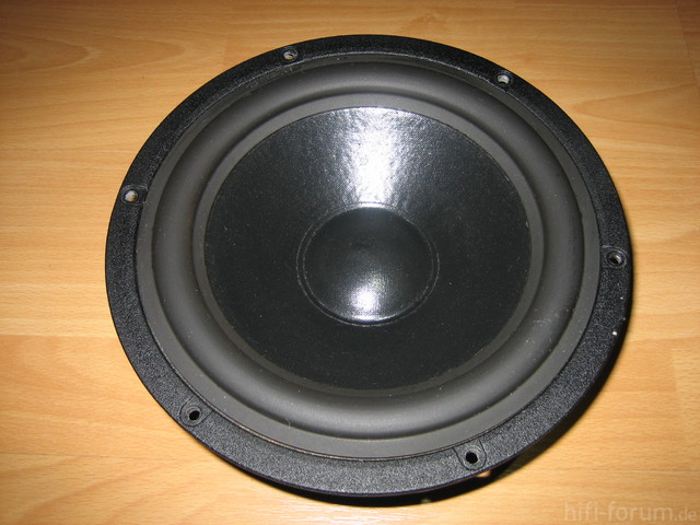

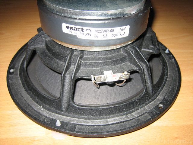

The bass transducer is a Vifa M22 - go to
FS: Vifa 8" M22 Midbass/Subs - CarAudioForum.com
and
2 Vifa M22 W-09, Selbstbau / DIY - HIFI-FORUM
using in a band pass subwoofer (Fundament 1.1, Bresc Audio, formerly company name: Gass & Dexheimer, Kirchberg/Hunsrück)
