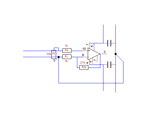

Nothing more confusing than a feedback loop. When I started playing with these chips it seemed logical to connect Ri to power/output return as part of the feedback loop and treat Ri's function as part of the input loop as secondary (high current over low current). Tomchr measurements convinced me that the inputs and their resistors should be configured as twins, that a small amount of resistance/inductance between input return and power/output return is not a problem, maybe even adds to HF stability and reducing ground noise/loops.

From a feedback theory point-of-view, it seems apparent that if the voltage across the load is what we intend to control, the feedback voltage should be measured as close to the load as possible. This means that GND_SIG should connect to GND_LOAD.
The diagram that follows this shows the TWO inputs labeled as GND_SIG and GND_SIG.
i.e. both connected to the Signal Source.
Most of the earlier diagrams show the very confusing use of a three bar ground symbol.
After this diagram he says
Bingo! Now 1 A of returning load current will result in 100 nV (-140 dBV) of error voltage developed across the load for DC signals. Even at 10 kHz, the error voltage is only about 56 µV (-85 dBV) – a 40+ dB improvement over the star grounding scheme at 10 kHz and 95 dB improvement near DC. The only difference between the star ground and the improved grounding scheme is that the GND_SIG trace was routed to the output connector rather than to the star ground.
he has made a Signal Return/Ground voltage reference connection to the Load Return/Ground.
He has kept the Signal route as TWO wires and the Load route as TWO wires and added that important voltage reference connection.
What he did NOT do is take the Signal Return to the Output instead of to the Source.
absolutely.
EVERY circuit must be treated as TWINS. Use twisted pairs everywhere. Since a PCB can't implement twisted pairs the best we can use is close coupled pairs.
One trace over another trace with a 6mil to 10mil insulation layer is as good as we get at the moment.
59mil (the thickness of a 1.5mm thick double sided PCB) or 63mil (1.6mm) is not close coupled. But it's a lot better than separating the twin into two different Flow and Return routes.
That does not explain the apparent indifference to the larger loop of the relatively higher current of the feedback loop, also a flow and return circuit.
V+/-, chip, output, Rfb, Ri, Ci, PGND, V+/-.

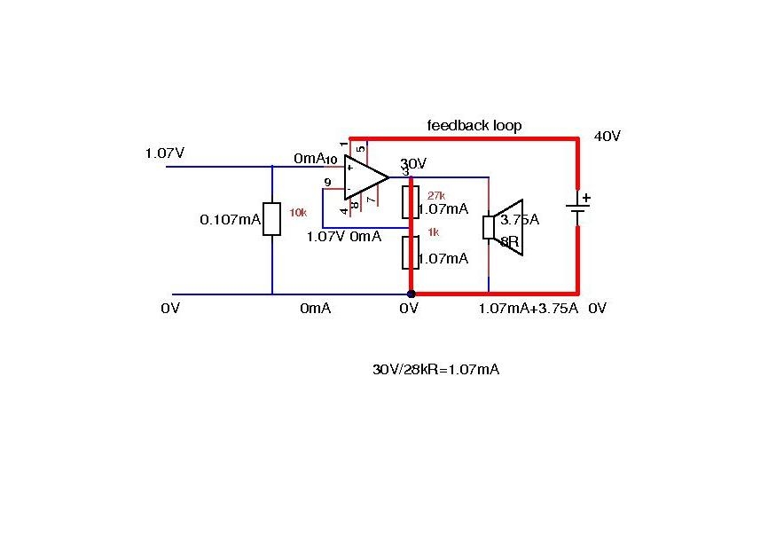

Does the feed back loop have a much higher current?
The current is limited by the impedance of the two feedback resistors and the output voltage. eg a 27k+1k NFB network driven by a 3Vpk signal draws 0.107mApk
If the feedback resistors are kept very close to the respective Flow Currents then each loop will be small and thus emitted and received interference will be small.
true enough. the signals sharing the "buss" are all relatively low current so it's not anything like having a speaker return in the middle of it -- speaker return is on the other side of the PSU return and the bypass capacitors so it's aside from the path of these lower current signals. if the entire FB network (2 Rs and a C) is located close to pins 1,2 and 4, then the rest of it may not matter much.
Feedback current is output voltage / R
30 Vpk / 28 k = 1.0714 mApk
Input Bias current = 1uA (max)
The max source current depending on the resistors used at the input will be about 0.05 to 0.1 mApk
When it's unity gain the voltages and the resistances are the same.
The currents end up the same and the Flow field cancels the Return field.
But when I draw a 28times gain amp, the voltages don't match, as expected.
That results in currents that don't match.
I can't see it at the moment. I'm missing something.
Simplified schematic of the Feedback loop with voltages and current.
exactly. the psu sources a total of 3.75107A to the chip V+ pins. the chip pin 3 sources that same amount of which 3.75A goes to the load and the rest gets sunk into the FB divider to develop the voltage fed to pin 9. pin 9 and 10 are at the same potential. all's right with the world. am i missing something here?
I can't argue with that.
The two input wires carrying 107uA must be a close coupled pair.
The next two input wires carrying 0mA (but actually 0.xuA) also need to be a close coupled pair.
The two speaker wires carrying 3.75A need to be a close coupled pair.
The two wires carrying the 3.75107A (the Supply wires) must be a close coupled pair. BUT in addition the unbalanced current, between the +ve and -ve supplies has to flow along the Power Ground wire and that has to be combined with the supply wires to make a power TRIPLET.
So back to where I was at before I became confused:
Every Flow and Return PAIR must be close coupled to minimise the interference.
Schematic @#114 was for AndrewT.
Here is a better schematic for PCB layout. It is based on Tomchr "IN+FB long GND" version.
As you can see the flow and return theory does not explain the improvement, I(Ri) is much higher than I(Rb). Flow and return ends beyond Rin.
A possibly better explanation: Think of the two inputs as voltage measuring devices and therefore the inputs need to have the same ground reference, but I'm only guessing.
