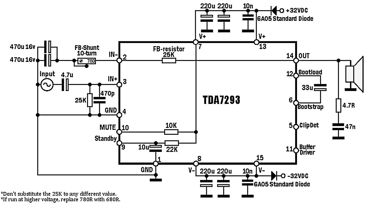

So far so good but the sonic quality is a bit disappointing in mid and high frequency.
To improve HF quality I'd suggest additional decoupling across the rails. Use low ESR electrolytics and keep them as close to the chip as possible.

ok change the electrolytics i'll try that , thx
The lower voltage schematic at post #224.I bought a made in China 2 channel amp board with TDA7293 at ebay very low price some years past. It comes with 2 4700µ elkos and bridge rectifier . I have 2*22V transformer and an additional power on module that operates on 12 volts remotely . So far so good but the sonic quality is a bit disappointing in mid and high frequency. What is the present state-of-the art chip amp?
You may be able to trim the gain barely slightly lower than that.
The cause of disappointing sonic quality is NOT inside the chip. There is some other locale for that difficulty.
This an ancient standard miller design pushing fets; so, performance isn't automated, but it is available. It can do what you ask very easily, but you might have to do a better job with the asking.
Additionally, that voltage is low for it, so there's less compromise, and therefore there's greater capacity for high fidelity audio, rather easily beating its competition.
Aside from power circuit, what is likely to have gone wrong is mad pinout causing poor layout. There's some easy patches for that problem. Actually, there's also some easy patches for power circuit as well. Yeah, we can patch both. It is old hat, because we have to do that just about every time. Its just nice that it is easy to do.
Thank you!If you have followed whats written on the PCB, I can understand your disappointments. If you use the component value that danieldwritesback have recommended, I think you will be satisfied.
Although I cannot predict the layout/stability/gain parameters of each different board and situation, I do try to hit the ballpark.
That will vary by voltage, load, and layout. It is an older model chip and so the process doesn't include room for an endless amount of Constant Current Source circuits to accommodate all situations ideally, automatically (that won't fit). Therefore it is reliant on trimming the resistor values according to need.

Elsewhere in the thread is mention of relocating the gain divider under-board and some power filtering too, as well as how to fit it.
If you got a unit board, power supply on same board as amp, there is means to patch it. However, if there is only 3300u per each rail at the power supply, then it doesn't support speakers larger than 5" approximately. So, you might still be looking at adding a power supply board. And, in that case the product isn't as inexpensive as it looks.
I see a lot of dual and even triple TDA7293 kits on ebay recommending 8Ω speakers. I'm trying to understand the point of more current potential into 8Ω (apart from over-engineering or perhaps to run safely at slightly higher voltage by raising the apparent impedance) since you'd be voltage limited into 8Ω rather than current limited... Would it not make more sense to use (for ex. a 3xTDA7293 board) into a 2 to 2.6Ω load? with approx 35v?

This amp is a bit needy on the supply; so, when I reported that the supply was insufficient for anything but tiny speakers, that really is what the limiting factor was.
The problem is not rubbish; but, that it would make very little sense for me to describe what the deal was.
Here's another try anyway:
This thing is needy on the power supply, and a tiny onboard shortchange is absolutely certain to disappoint in all cases.

Room for improvement?
My first guess on that is to add the Thile-Small output filter components.
That's because if we stabilize with something other than the main gain, we could turn the gain down very slightly, and with the benefit of slightly higher resolution.
It is likely worth the cost of the added parts.
That bit wasn't difficult to guess. But, I'd like to request help in coming up with the next step; so, please comment.
