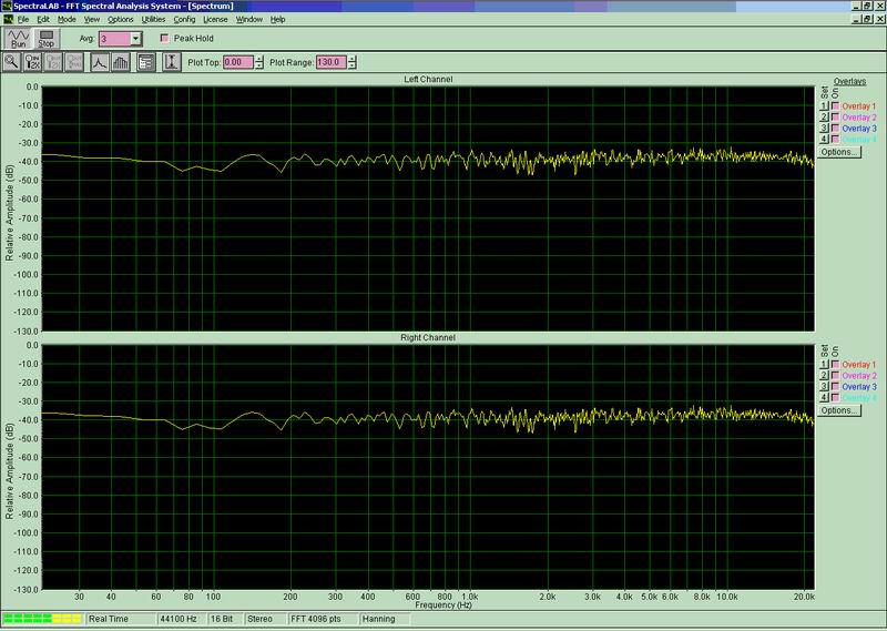

I just fed the output of my Sony2000 portable into my soundcard and got this at 1K.
