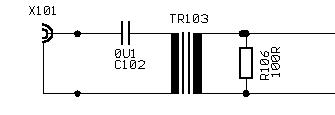

The schematic at:
http://www.ndh.net/home/kboehm/T-DAC-P2.htm
is illegible for the most part. I did see a transformer for a 75 ohm interface loaded with what appears to be 100 ohms.
Hi Fred,
if you click on "click to enlarge" in the link, the schematic is quite legible.

'if you click on "click to enlarge" in the link, the schematic is quite legible."
I did...... its not. Want me to ask you to guess capacitor values from it?

ideal SPDIF interface?
The "feline" link posted previously is mandatory reading. There is a lot more to the SPDIF interface than meets the eye. From what I can work out from that thread to minimise any distortion caused on the SPDIF interface:
1) Use this circuit from Fred at the transport as it is easy to retrofit and uses a transformer for isolation like the Schott 67125450 (if your SPDIF source does not have a decent transmitter or isolation transformer): transport end
2) Use the receiver part of this circuit from Elso which has a differential input into the CS8412: DAC end
I dont see a reason why the OPA603 is necessary in Elso's circuit for the receiver. Any reason why the simpler circuit in 1) won't do the same job?
Would it be wise to add a cap on the input of the AD8561 on the receiver to ensure no DC is applied to the transport transformer? Would it also be possible to use another Schott transformer to replace the AD8561 as it can provide differential input to the CS8412?
To avoid ground loop current between the transport and the DAC would it make sense to only ground the 75 ohm coax at the DAC end?
Have I missed anything else that is needed to ensure the SPDIF interface does not cause problems?
(lots of questions here, but there are people on this thread with more experience than me and I'm keen to learn).
Dean

Re: ideal SPDIF interface?
Dean
Hi Dean,
First where is the feline link?. Please provide a clickable link.
Fred and Jocko did not convince me that a transformer is necessary. I tried my transformerless interface in the Sony CDPX33ES, the Philips CD650 and CD931. I all cases it worked flawlessly. I only have a problem with my digital satellite receiver Philips DSR2000. Probably I have here a groundnoise problem. This tuner has a switched mode powersupply. The transformer brings the solution here. Necessary at the DAC end as I don't want to violate the warranty.
